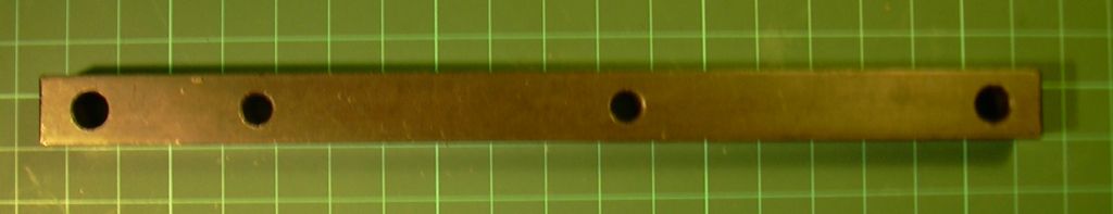

                  Brian, in response to your post:
                  Here is a picture of the Beeston Myford drilling jig for the gear-box mounting holes:
                  I measured the hole-to-hole centre spacings (by putting suitable drill-shanks in the holes and averaging the external and internal caliper readings to eliminate the drill diameters).  My results are as follows (from left to right):
                  1.188", 2.560" and 2.624" . (They look fairly close to fractional spacings.)
                  I am a bit puzzled by Brian's post. The Myford fitting instructions call for the push-screws to be temporarily removed from the lathe bed and their tapped holes to be used to secure the drilling jig. The head-stock casting is held to the bed by the four securing bolts that go in from the top, beneath the mandrel and back-gear cluster. My understanding is that the function of the push-screws is to position the head-stock casting against the rear shear of the bed until those 'in from the top' bolts are inserted and tightened. Once that is done, surely the push-screws have done their job? The gear-box fitting instructions do call for the push-screws to be re-inserted once the gear-box mounting holes have been drilled and tapped – but they do not call for any re-alignment checks on the head-stock & mandrel.
                  The push-screws may, however, need to be shortened if they protrude from the bed and prevent the gear-box from fully contacting the front shear of the bed.

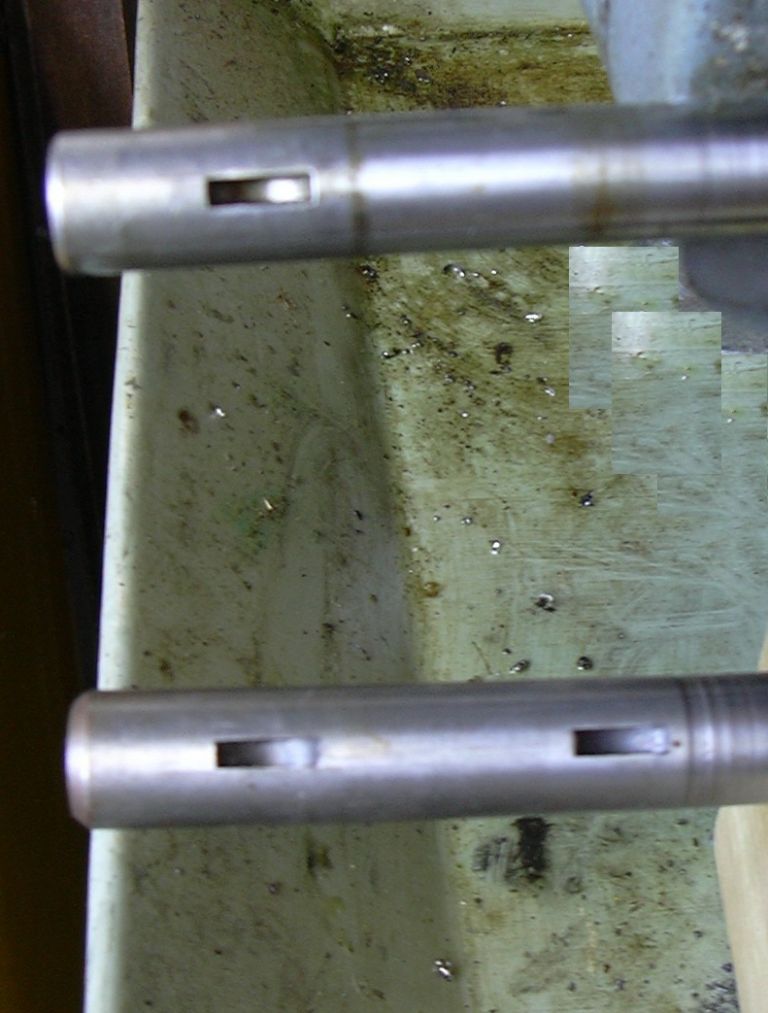

                    To illustrate the point I made about lead-screw key-slots, here is a photo I found:
                    The upper lead-screw is the early type and the lower one is the later type. You can see from that picture how shortening an early lead-screw loses the key slot.

                          Just to be clear, both the lead-screws in the photo are full length, un-shortened, as supplied with non-gearbox ML7 lathes. Their tail-stock ends are level with each other.
                          Best regards,
