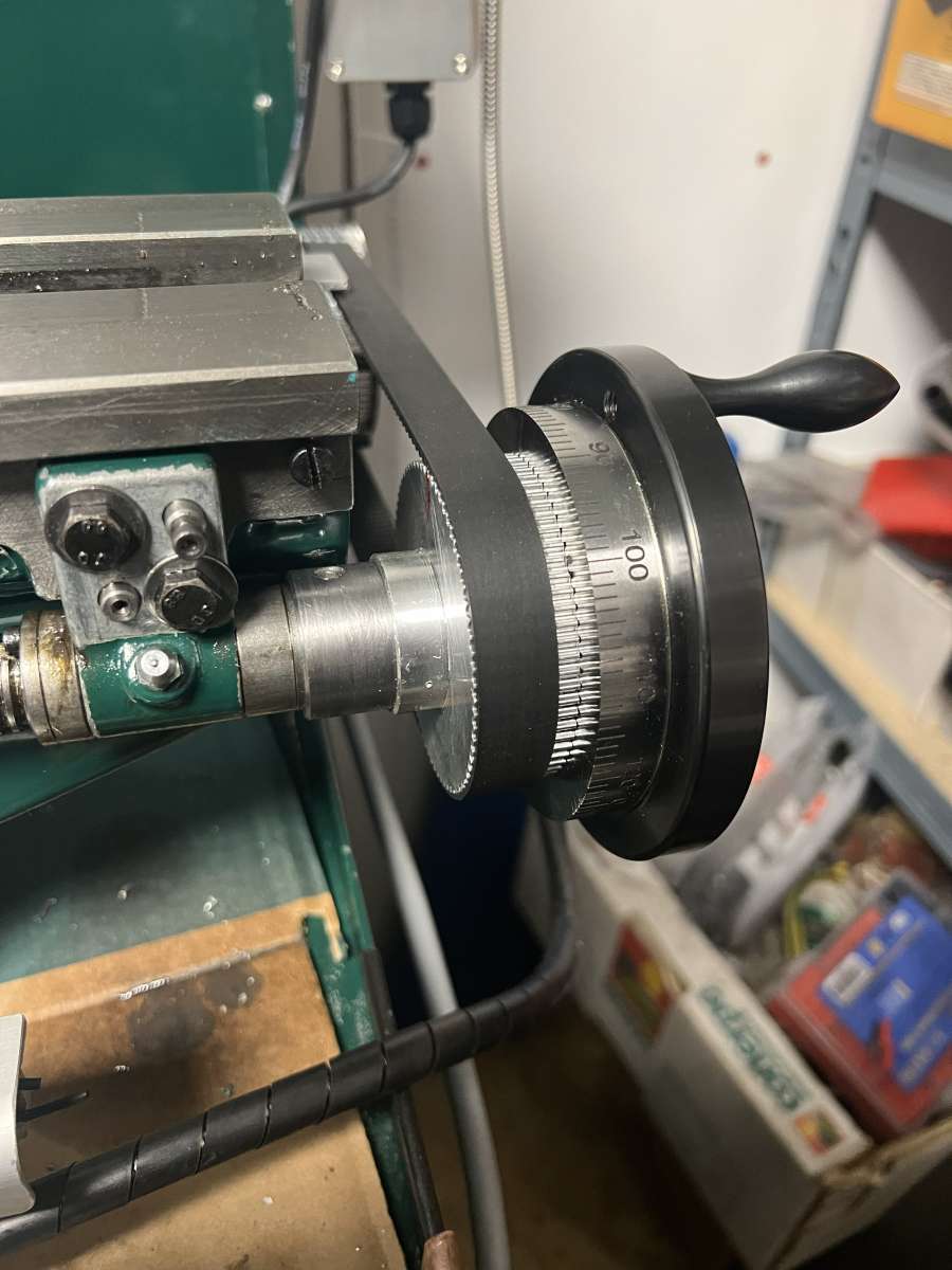

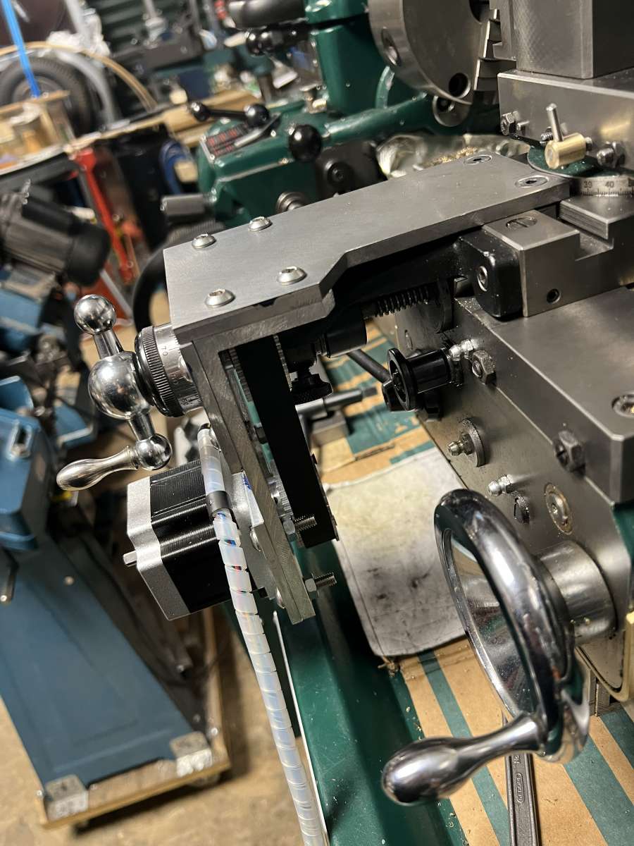

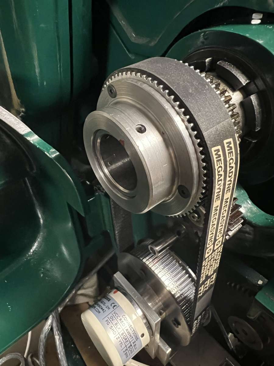

      I have recently fitted my Myford Super 7 (large bore) with a Rocketonics ELS package.
      Fairly straightforward and most useful.
      with thanks to Dave Senior regarding the emergency stop set.IMG_2299IMG_2330IMG_2415

        Nice. Now you could go full CNC. Though a ball screw on the X axis would help.
        #834547
        Geoff Rogers
          @geoffrogers81118
          thank you John,
          ball screws would icing on the cake, but are a job too far at the moment.
          I am finding the set up, using the existing leadscrew and cross slide screw, good enough.
          main purpose of fitting the equipment is screw cutting and tapers.

            I hope you find it as useful as I do with my Raglan installation. It is a joy to use, and I keep finding other aspects I had never considered.
            For instance, last week I needed to wind some springs for the atmospheric inlet valves on an 1899 Panhard & Levassor car that I help out with at our local museum. I wasn’t exactly sure what I needed, so I played! 1mm piano wire, electronic control of the feed per rev, manual handle to turn the spindle. Start with 3 turns at 1mm pitch to give a good close coiled start, then 10 turns at 4.0mm pitch, then 3 more turns at 1mm pitch again. Clip off the excess coils, and test it. If required, try another with, say, 10 turns at 3.7mm pitch. Dead easy to change the pitch to whatever you want just by twiddling a knob.

              Probably helpful for someone if you could say what size steppers and voltages you are using for x & Y, and reduction ratios as you are using belt drive.

                  Bazyle – for information on the stepper motors etc it would be best to the Rocketronics web site (https://www.rocketronics.de).  They provide a variety of packages, depending on the lathe size (by weight).  Usual disclaimer.
