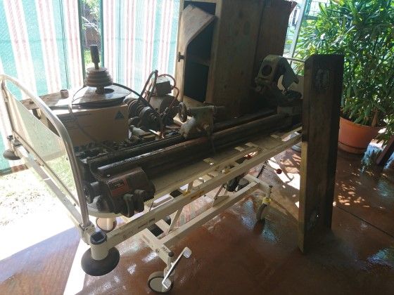

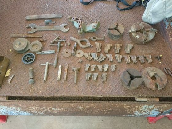

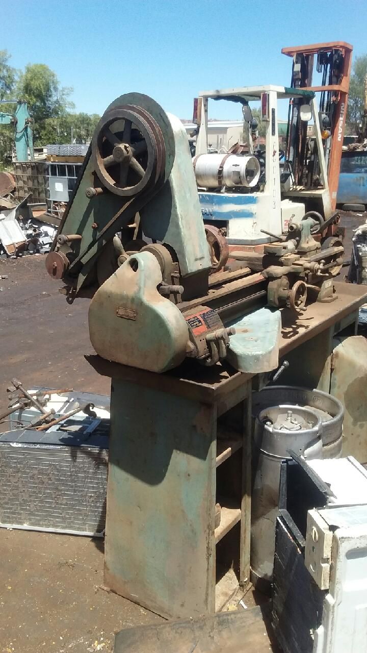

        My Hercus 9 Restoration has started, I am hoping any Hercus or Southbend owners will be able to help me.
        Finally got a nice cool day for a change, only 41°C.
        So I thought I would start cleaning up my Hercus 9 and try and keep the missus happy.

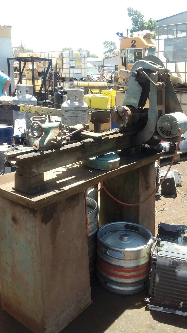

        I saw this lathe advertise in Alice Springs in a recycling yard ( Alice is the closest town 500 Km away) in March last year, I only wanted the stand for my Hercus 260, but when I picked it up I found out it was an Hercus ARL.
        When I bought her home, I had to dismantle her to get her off the trailer and stacked the parts on an obsolete hospital bed, 6 month later I transferred to a different department at work so bought home my bench that I originally took there because it was too big for my shed.
        For some reason the missus is keeps whinging about 2 lathes, a hospital bed and a bench on the back veranda, strange woman.

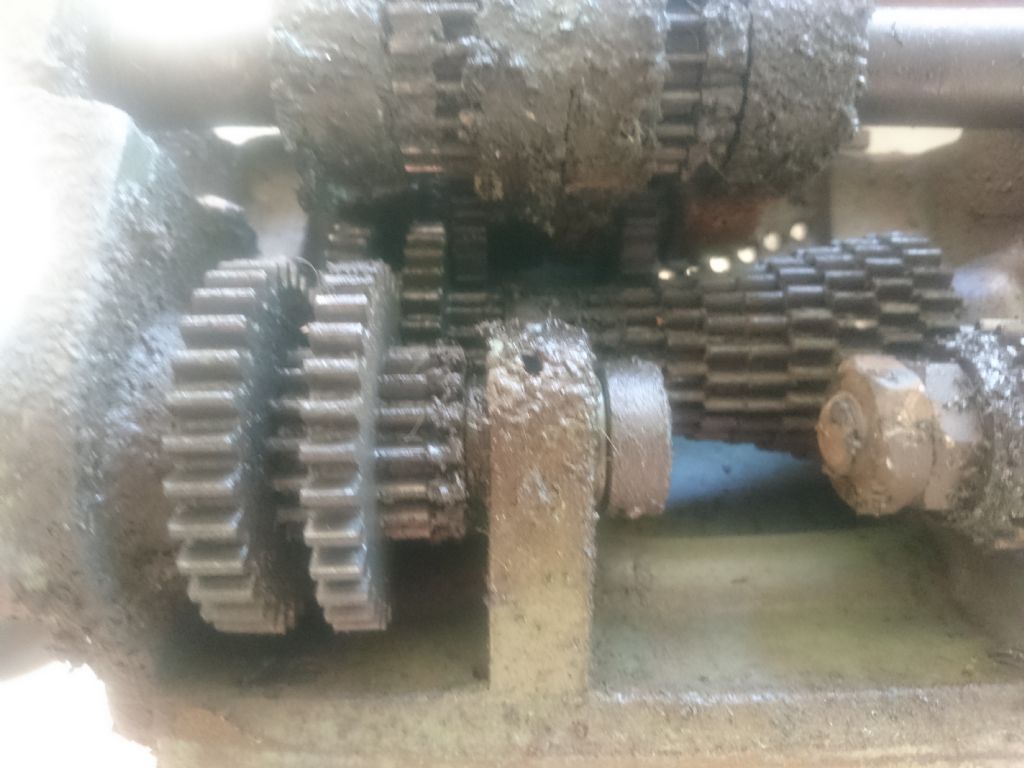

          Inside the cabinet amongst the swarf, rust, cobwebs and dirt., I found these goodies.
          As well as the spare parts manual with the inspection certificate inside it.

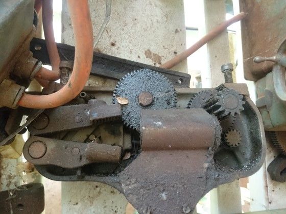

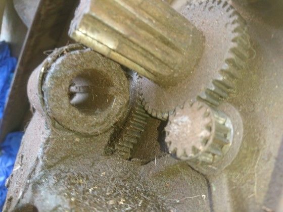

            Just a couple of photo showing the crap in her.
            Bit of a difference.
            #391663
              That hospital bed is a touch of genius Mark yes
              I hope the patient makes a full recovery.

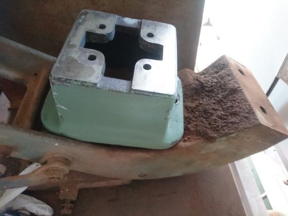

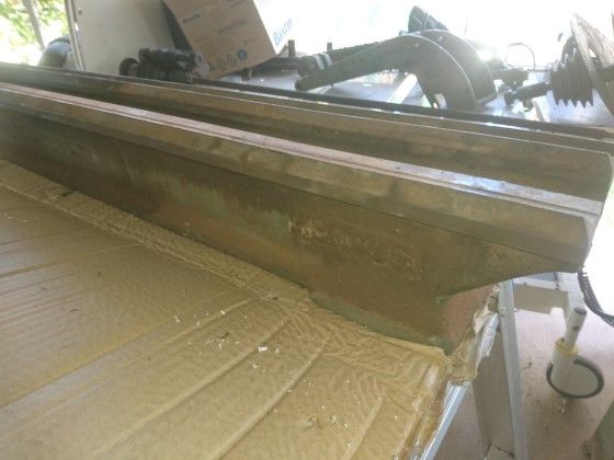

                                              Derek I finally had succuss , the S/Bend tailstock has square recess and the Hercus is dovetailed, I finally got the base off, now just got to get the cap of the end.

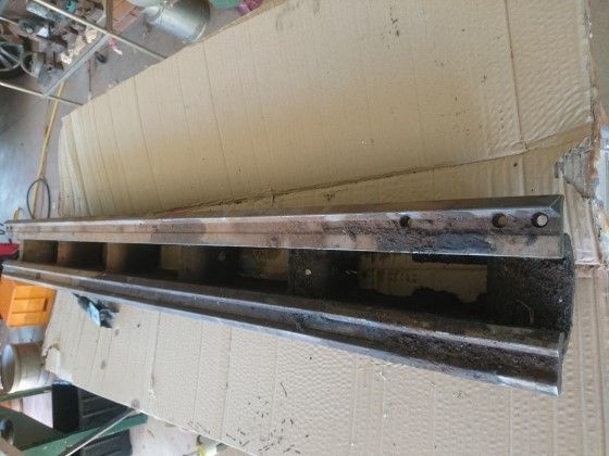

                                              The bed is cleaned up, All the Hercus I have seen all have been paint red inside the bed except mine.
                                              Hang on whats this.

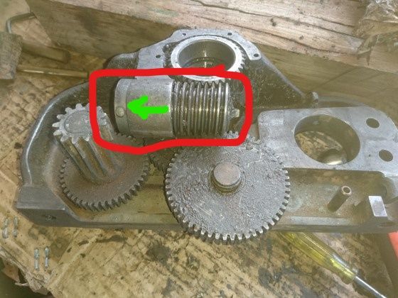

                                                How can I get this pin out without wrecking the key?
                                                I have tried gently tapping it etc with an success.crying 2
                                                According to the Southbend Army manual, there is a worm, key, pin and collar.
                                                #392885
                                                Robin King
                                                  @robinking15611
                                                  That pin passes through the locking collar into the key to hold it in place lengthways in the keyway. If you give the projecting end of the key a light tap inwards towards the centre of the bore it'll separate from the pin.
                                                  To remove the pin – put the key back in the keyway with the blank section pressing against the inner end of the pin. Put something like a piece of steel tube or a socket over the outer end of the pin, then fit a C clamp over the key and tube, tighten it, and it should push the pin outwards. Don't be tempted to use a hammer/punch from the opposite side as it can damage the collar.
                                                  When that's out you can unscrew the locking collar and remove the worm gear. On my Boxford it was a tight fit doing this as the plain end section of the worm went tight up to the clutch gear but it's just do-able.
                                                  Edited By Robin King on 25/01/2019 10:16:07

                                                    Thanks Robin, got it apart no problems.
