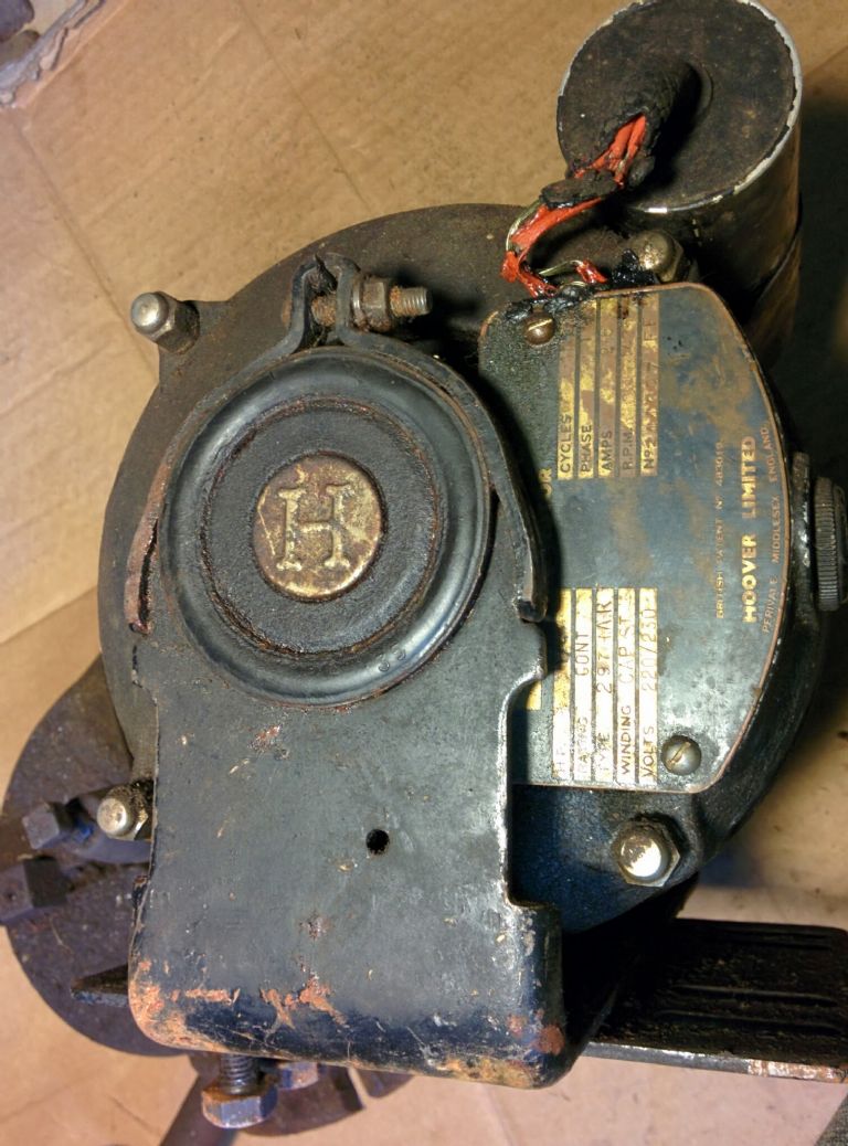

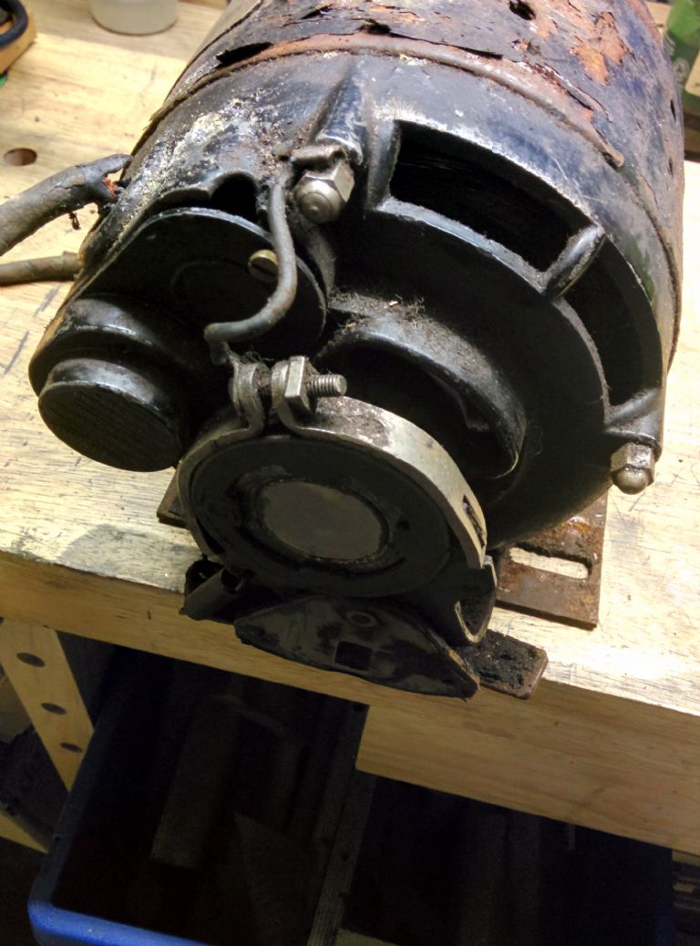

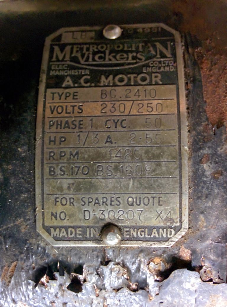

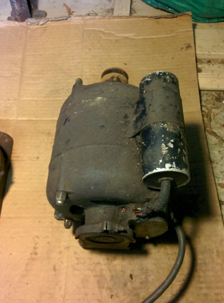

      Hi,
      I'm at the point of restoring the motor for my ML7, but I need to consider the ways forwards since they are both pretty old and in bad shape
      1) 1/3 hp Vickers motor, but not in great shape. The cradle is very rusty and cannot be dismantled.
      2) 1/4 hp Hoover motor, also not in great shape and needing work on the motor run capacitor.
      3) Buy a new motor. Based on the assumption that modern motors are more efficient, better performance and more powerful for their size (I was thinking of a 4-pole ~q1500rpm 1/2hp)
      Anyone have any recommendations for a new motor?
      What would you do?
      Matt

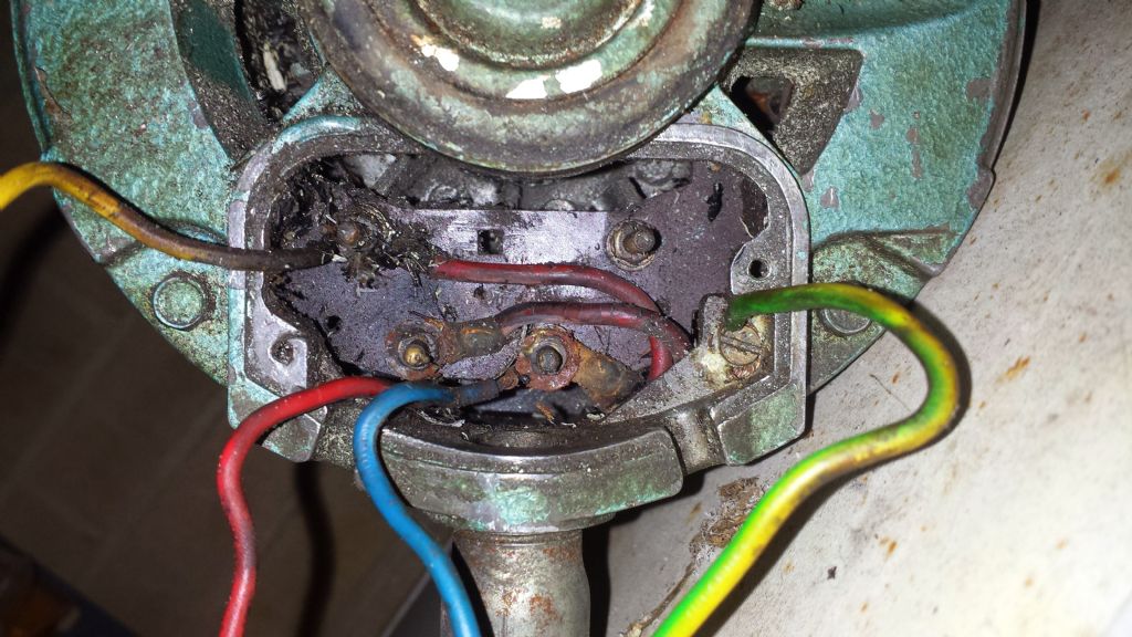

                  Tagging onto this one as I seem to be following in Matt's footsteps…
                  The ML7 I'm gradually putting back together has a 3 phase, dual voltage English Electric 1/3HP motor with it. It seems to have 4 terminals, 3 of them wired to lines. No obvious way of changing wiring between star and delta. I've ordered the Tee books on motors – my experience of 3ph motors is limited (mech eng only got taught rudimentary 3ph power theory) – but in the meantime I see the options as follows:
                  1. Find a way of wiring it for 1ph use and see how it goes. May not be possible and the amount of swarf I can see through the vents makes me a bit twitchy (and that's with no current flowing).
                  2. Replace it with a single-phase motor; either with resilient mounts or a much cheaper one from e.g. Machine Mart.
                  3. Buy a 3ph inverter and run it off that.
                  4. Buy a 3ph motor/inverter package and fit that.
                  3 & 4 I'm not certain make good financial sense – at this stage, the lathe is a bit of an unknown quantity. I've got about 3 thou of wear on the front shear for the 1st 1/3 of the bed, I don't know how good the spindle runout is yet and it still needs to be bolted onto a bench.
                  I'd already decided I didn't like the MEM contacter and sourced a more up-to-date NVR with emergency stop… The Dewhurst switch looks fine at least. What's puzzled me is that the wiring in those was 1ph, but the motor has the red/blue/yellow I'd expect of 3ph. Decommissioning was done with cutters it seems.
                  Any advice?
                  #176161
                  Harry Wilkes
                    @harrywilkes58467
                    Peter ref your motor one of those four terminals as 3 wires on it that's the star point you'll need a meter to check out the wires a cheap meter will do fine, the terminal that had the 3 wires on becomes redundant the other 3 terminal will have 2 winding wires and a incoming phase on each of them. Have just had to do the same thing on a motor I've just fitted ! If you need advice on how to pair the winding let us know.
                    H
                    #176162
                    Les Jones 1
                      @lesjones1
                      Hi Peter,
                      A picture of the terminal box on the motor would be a great help as I do not understand your description. I do not understand why you say it "seems" to have 4 terminals. Also I do not understand "3 of them wired to lines" Was lines meant to be links ? I think your first step should be to dismantle the motor to remove the swarf. Mark the endcaps and casing so the end caps go back in the same position. A 3 phase motor will have 6 wires coming from the winding. If it is single voltage then these may be linked inside insulation in the windings so only 3 come out to the terminal box. If it is dual voltage then all 6 need to come out to the terminal box. The Dewhurst switch can be used for both single and 3 phase reversing. If you use a VFD to generate 3 phase then DO NOT connect the Dewhurst switch between the VFD and motor. It could still be used to reverse the motor via the VFD control signals.
                      Les.

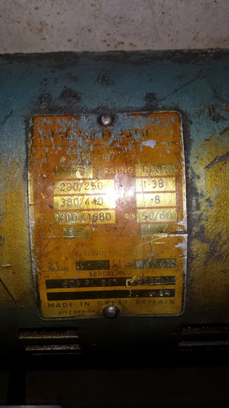

                      #176165
                      Peter Bond
                        @peterbond14804
                        Motor terminals
                        Motor rating plate
                        As it stands, it looks like L1, L2 & L3 are connected (and an earth – I'm almost surprised). No cover plate, so I'll have to cut a new one (not a big deal, really).
                        I was working on the assumption that if I do go VFD, I'd use that to control reverse and the Dewhurst becomes redundant.
                        #176167
                        Les Jones 1
                          @lesjones1
                          Hi Peter,
                          I suspect that the top right hand terminal is the star point. This is where one end of each of the windings is connected together. If this is the case you will need to remove these 3 wires from this terminal and connect them to the 3 existing terminals with wires on. You will need to identify these wires so they can be connected to the correct terminals as Harry has pointed out. I cannot see how the terminal strip is fixed but it will need to be removed as the wires to the star point terminal must be on the back. IF your motor is the same model as Harry's then he will be able to tell you how to remove it. From your pictue it looks like the terminal strip needs a good clean before applying power.
                          Les.
                          #176170
                          Harry Wilkes
                            @harrywilkes58467
                            Hi Peter as Les suggested remove terminal board and give it a good clean and again as Les suggested I think you will find the other 3 winding wires on the top right terminal. I think it worth persevering with the motor so give it a good clean and get your self an inverter assuming you do not have a three phase supply, it's not hard to reconfig the winding for delta but as I said you will need a meter .
                            h
                            #176174
                            Peter Bond
                              @peterbond14804
                              Thanks both – I shall dismember the thing and clean it. Meters I have aplenty, so buzzing out connections is not a problem. I've found a VFD at a good price on EBay (a Bosch, so it even has a comprehensible data sheet); 2HP may have been overkill for this motor, but even this is only a short-term solution I can rig my belt grinder to use it instead.
                              Sounds like I might have this sorted before the books arrive…

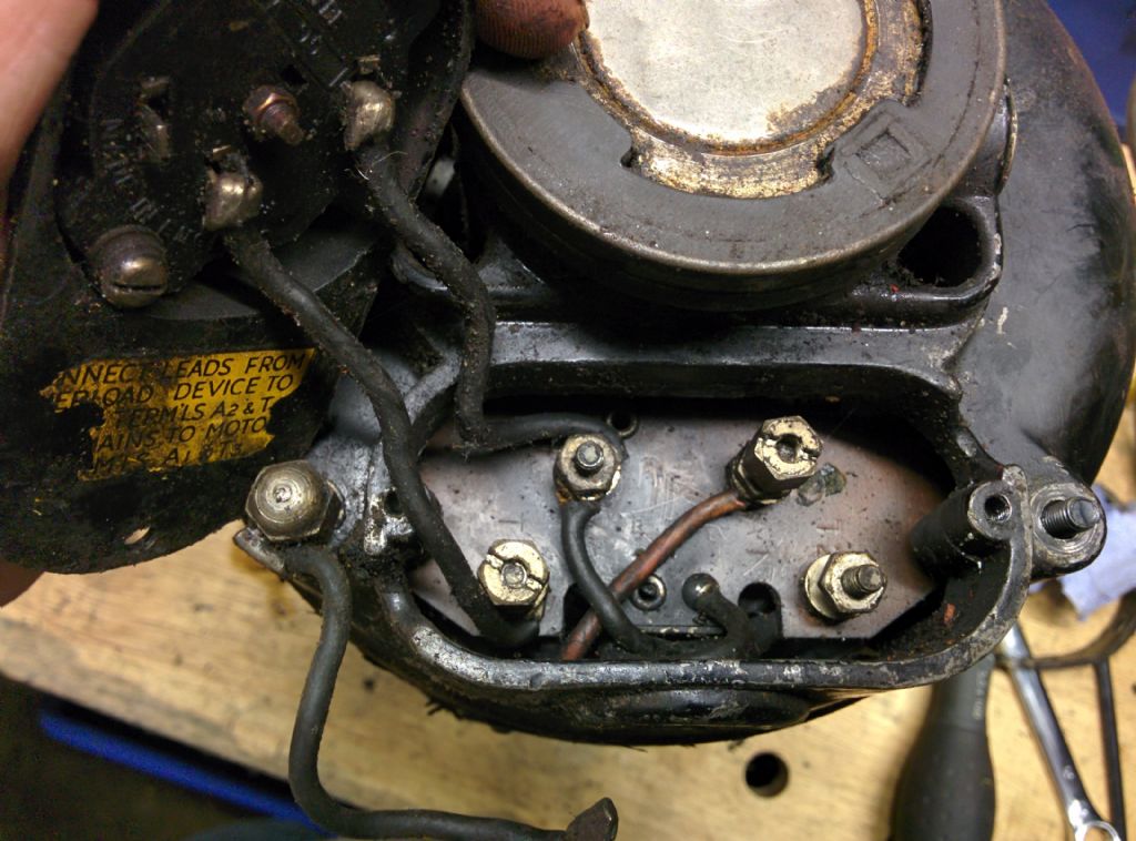

                                      #176902
                                      Peter Bond
                                        @peterbond14804
                                        Well, I've had mine partially dismantled now and found:
                                        Most of the swarf is plastic and brushes out. A blast with compressed air might shift the remainder.
                                        The terminal plate is a case of WYSIYG – there are no other wires, it's supply to coils as seen. Still need to buzz out to work out if it is star or delta. The 4th terminal is just a post.
                                        Oh, and the books have arrived.
                                        #176906
                                        Les Jones 1
                                          @lesjones1
                                          Hi Peter,
                                          I do not believe it is possible to identify is it is star or delta connected just from resistance readings. If you call the three connections A, B, & C if you measure the resistance between A and B then short A to C the ratio of the readings will be 0.75 no matter if it is star or delta connected. You will have to find the ends of the three windings and see how they are connected.
                                          Les.
                                          #176908
                                          Harry Wilkes
                                            @harrywilkes58467
                                            Hi Peter glad your progressing with the motor, just out of interest if the fourth terminal is just a 'post' have you found where the other 3 ends of the winding are ?
                                            H
                                            #176910
                                            Peter Bond
                                              @peterbond14804
                                              If it's star connected, I should be measuring twice the coil resistance between terminals. If it is delta, it should be 2/3 the coil resistance. So, is twice an unknown variable or merely 66% of it?
                                              All well and good, but it does rather depend on whether a trivial fag packet calculation based on the current reqs of the motor is valid for 3 phases and AC (DC is far simpler to work with!). More reading required.
                                              The 3 wires lead into the motor; I need to unbolt them to take the end cap off completely. Best guess is they go direct to the coils.
                                              #177078
                                              Phil Whitley
                                                @philwhitley94135
                                                Hi Peter, Your motor is almost definitely star connected, the box on the label under the frequency should have a symbol, or S or D in it, but as far as I can see it is not marked. the star point will be on the winding itself where the other three ends of the coils will be soldered together and insulated. If you want to run this motor in delta, you will have to find this connection, unsolder the ends, solder a tail wire onto each one and bring them into the terminal box.Test with a multimeter to find the three coils. designate the three connections you already have as A1, B1 and C1, designate the other ends of the respective coils A2, B2 and C2. Connect A1 to B2, B1 to C2 and C1 to A2. put one phase of the supply to each junction. If the motor runs smoothly and quietly, but the wrong way, reverse any two of the incoming supply phases. If it runs slowly and growls, swap over the A1 and A2 connections. if it is still the same, put the A connections back where they were and swap the B connections.if no better,swap the B connections back, and continue with the C connections , and you will be sorted!
                                                Phil
                                                #177110
                                                Peter Bond
                                                  @peterbond14804
                                                  Hi Phil –
                                                  I suspect you're right on the connections, particularly given the age of it. Reading the books, I'm intrigued as to how it is dual voltage without any obvious wiring links. I note that some of the VFD manuals advocate delta connection only, whereas others don't mention it at all.
                                                  The rewiring sounds worse in description than it is likely to be in practice!
                                                  #177121
                                                  Phil Whitley
                                                    @philwhitley94135
                                                    Hi Peter,
                                                    The motor has been rewound at sometime in its life, the varnish on the rating plate is a dead giveaway. the motor would have been star connected for high voltage, and delta connected for low voltage. Obviously this cannot be done with only three connections available, so it looks like it has been rewound in star only configuration. strip it down and see if you can find the other connections.
                                                    Phil.

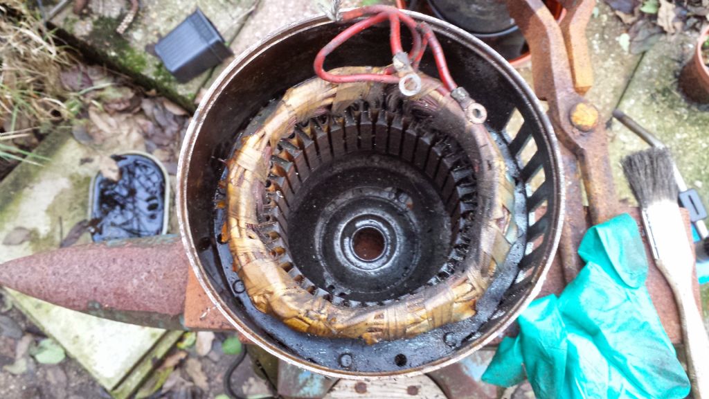

                                                    #177295
                                                    Peter Bond
                                                      @peterbond14804
                                                      Interesting – why is it a dead giveaway? The thing has been resprayed at some point too – assuming it wasn't standard practice to paint the motors after assembly.
                                                      Windings exposed
                                                      There's a nice load of resin over the insulation, so it's going to be entertaining trying to find the termination…
