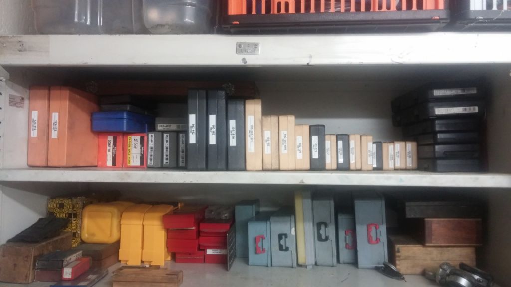

                I bought all my Mitutoyos second hand on ebay. All chosen carefully, not accepting any that show signs of any rust. Most are as new, tending to cost in the region of 15-25 GBP each. Ive got a full set of standards and never have any problems with repeatability against the standards.
                You could say my mic collection has become somewhat obsessive.
                I don't have any digital micrometers, but all of my absolute digital calipers sit on my bench pretty much 24/7 with the displays on, as they don't seem to auto off, and i've not replaced any of the batteries in the last couple of years. I don't know if the mics are worse for some reason.
