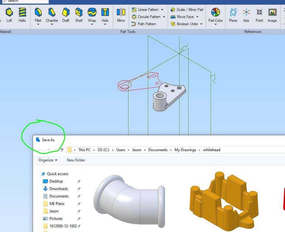

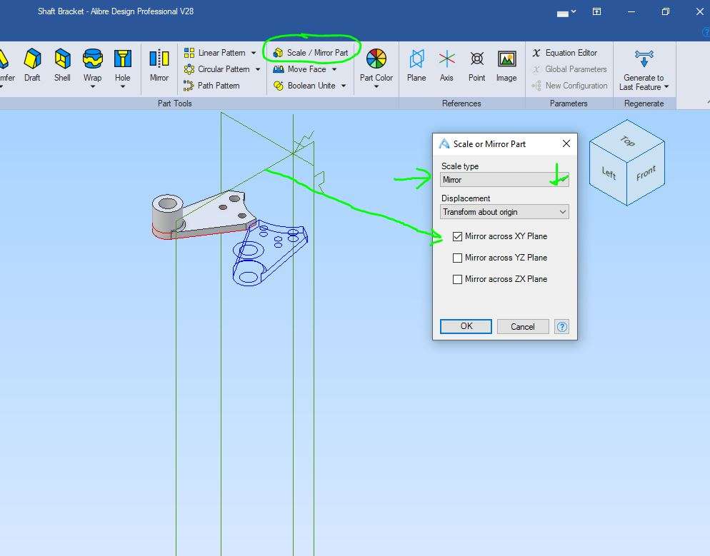

      #842286
        This is what I would do with my Pro version and I am fairly sure Atom does the same.
        Open the original part file. Along the top bar you should have a tab for “Scale/Mirror part”, click that.
        Then in the top box click the drop down arrow and select Mirror, select th eplane you want to mirror the part in and it will show the new part in outline.
        mirror1
        When you click OK the part will be mirrore dbut the sketches used stay as original. Click File and then Save AS top left and give the mirrored part it’s own name eg Bracket left. You could then make modifications to the “left” file without affecting the original right hand one.
        mirror 2
        Regarding your drawing only opening one part. It sounds like you had an assembly which had two of the same part but one orientated as a mirror of the first so only that one part would have come in. You can also select an assembly file which will bring all the parts in that assembly into the 2D drawing so that may be another option but not a one part on one sheet option.

          As Jason points out there are 2 different tools which can mirror in 3D mode in the Part workspace.
          Feature Mirror adds mirror images of individual features (or even the entire part), leaving the original in place.
          Part Scale/Mirror can be used to flip the part over – it does not leave the original in place.
