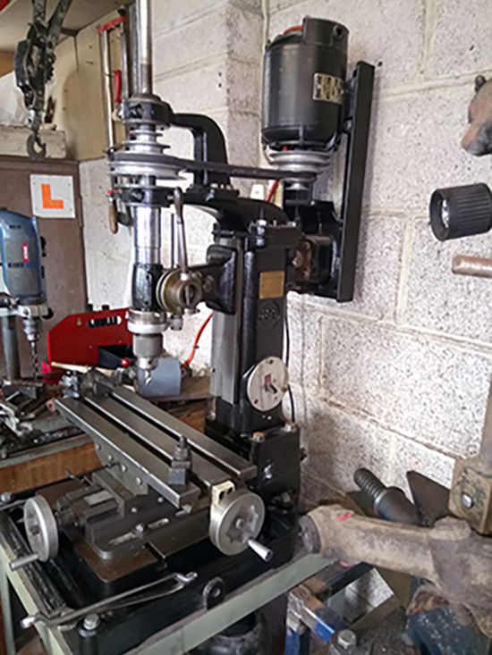

                            Is it this one, as advertised on lathes.co.uk at the moment?
                            Not a tool for removing lots of metal quickly I suspect. Looks like a mill-drill currently fitted with a Jacobs Chuck (no good for milling). I guess from its layout the machine was designed for delicate work and note the seller wants to upgrade to a Tom Senior or Centec.
                            Condition is everything. Are you able to travel to Newton Abbot to see it in action? Watching it cut metal will reveal if if suits your needs or not.
                            Anyone familiar with this machine or similar in action?

                              That's a Jones and Shipman drill with a far eastern XY table bolted to it, the fact it's been used as a mill is terrible abuse of a nice old drill, and trying to sell it as a mill is terribly dishonest, the seller must know this isn't a milling machine, which is why he wants to swap it for a milling machine.

                                Hi, I agree with Pete that the XY table is not native to the machine that it is on, I have one of those XY tables which was fairly cheap when bought new, compared to others that were available at the time.

                                  The pics show the vertical axis is not likely a very “precision” piece of kit.
                                  With the jacobs type chuck as possibly with a non-descript attachment to the column and a cheap table makes it not even worth a trip to look at it, even if fairly close. Simply a non-starter for anyone who is serious about milling.

                                    The add on x/y table also takes up all the z distance. If it's that one, it's a lovely old £200 drill.

                                        To be fair to the seller of the machine photographed, the ':L'-plate might be appropriate! It looks as if does take a pride in his machine-tools but was genuinely either unaware of what he was doing, or doing the best he could at the time.
                                        It is fine as what it is – a very good drilling-machine with a co-ordinate table, and possibly fitted with a raising-block to compensate for the table-height.
                                        It most definitely is NOT for milling though. No drilling-machine is.
                                        I'm a bit wary of that motor-frame too. It is difficult to make out but does it rely on tilting the frame to tension the belt; in a direction that would pull the belt out of line with the Vee-grooves? Not good for the belt, pulleys or bearings. I would have bolted the machine's stand to the floor and the motor-frame to the wall or to pillars rising from the stand, with a different tensioning arrangement.
                                        Up-grading to a Centec? Yes, that is a proper milling-machine but with a much smaller table and travels than on that drill.
