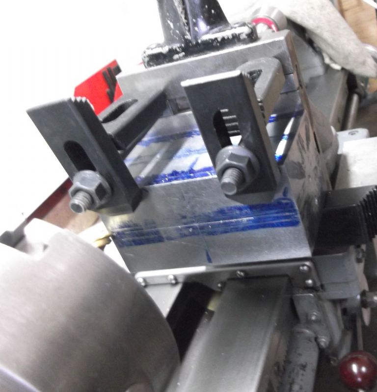

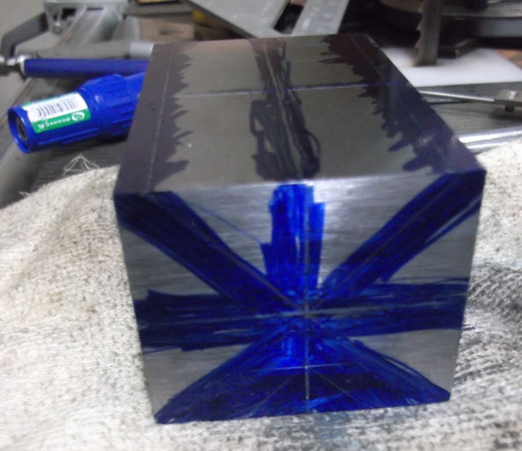

      I am on making V-blocks the block is 55x65x140L I will cut into two.
      I have already marked out everything drilled at the bottom of both V's and milled out the clamp slots on the sides. The ML7 vertical mill is a great attachment as are my hold down clamps.
      I am cutting two V's one large one small. Large will be approx 1" deep, small approx 1/2 deep.
      My dill-ema is in doing the V's.
      In all my web searches on making V-blocks each one I find has either another set of V-blocks to set the angles with for milling or an inclination/angled vice.
      To do this without using the above I have so far come up with.
      1 Hand cut rough the V then mill on the ML7 to finish
      2 Use the 4×6 BS in vertical mode again rough cut and mill
      I still need a way to mount and clamp the block on the lathe to mill it.
      Any suggestions

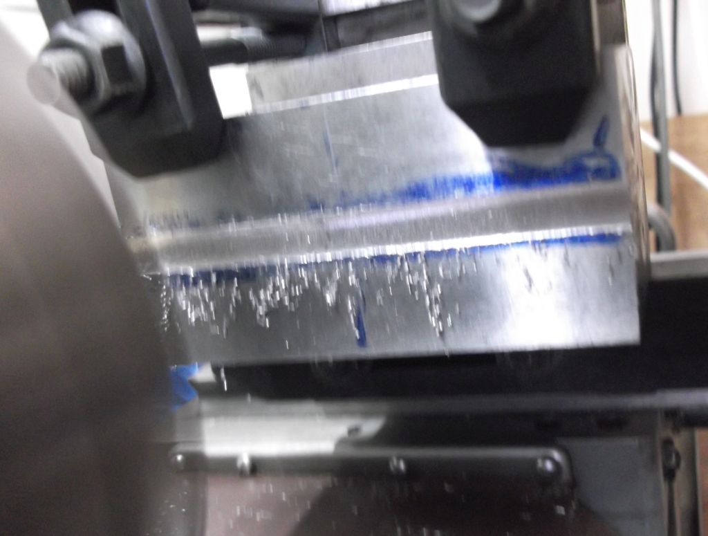

                  I have posted photos of the set up used for milling the clamping slots and marked block
                  #156645
                    Thanks for posting the photos, Raymond
                    I now see that my interpretation of your set-up was wrong.

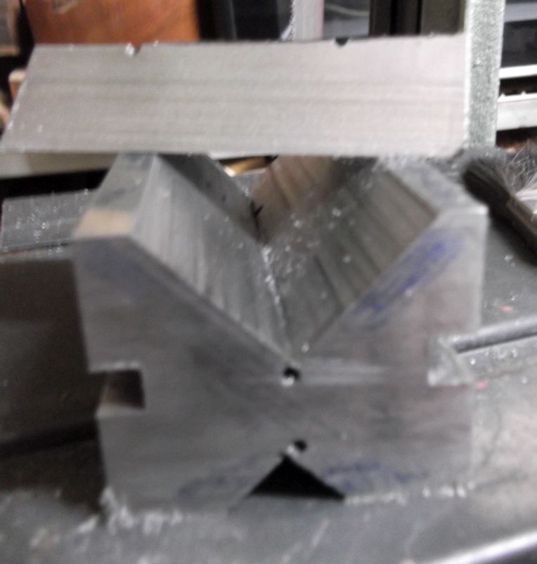

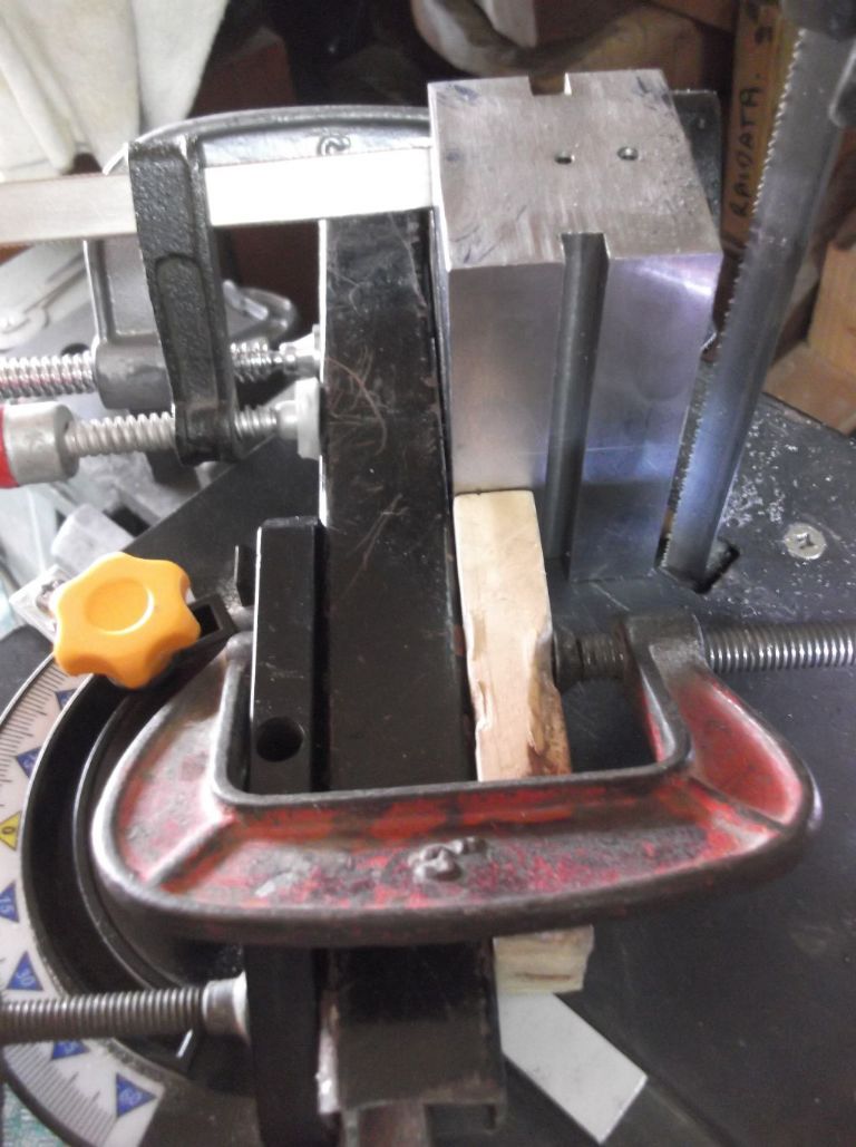

                                    dscf7885.jpgFirst full day in the garage so I set up the 4×6 bandsaw in vertical mode and rough cut the waste of the V-blocks.
                                    Glad I had a spare blade as about 1/3rd into 2nd last cut I stopped for a break and found a split in it.
                                    I am going to ache tomorrow.

                                        For a light clean up like that you might get away with using a large multi-fluted counter-sinking cutter to machine the V groove to finish size. If you leave a little of the notch in the root of the V you could even cut one face at a time and make life easier for yourself.

                                                Hopper your spot on here the smaller V could even be done with maybe a router cutter of HSS or Nitride.
                                                I have now less clean up to do.
                                                Friend who supplied the block is making a 90 deg cutter out of a 2 flute old Milling cutter. for the large V.
