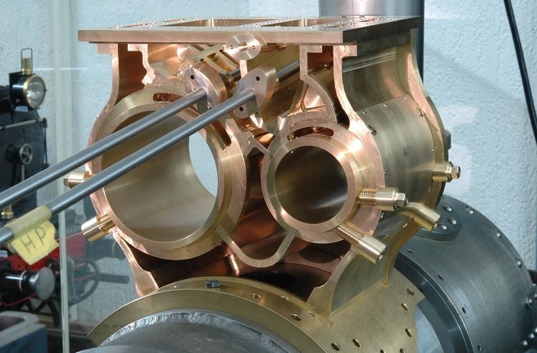

            A modern CNC would be able to do the compound face and with a fine stepover would require minimal lapping, the ports would be the harder ones to cut particularly on the HP side as the face is at a steeper angle so not as easy to get a tool at right angles to it unless the ports were cored and cast in as per the original.
            for a model then easier to fabricate the cylinder from many parts so you can do the face and ports while easy to get at, this is Jan Huijgen's 3" Fowler block part way through construction.
