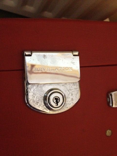

      Hello,
      My girlfriend came back from Brighton the other day with a vintage '60s leather suitcase (as you do). The keys for the lock are long gone and she reckons her engineer boyfriend can make her some new ones! Quite right too! and I don't think this is a job for the local key cutters. However I think I will ask for some advice here first before endevouring to undertake this task.
      photo:
      any help appreciated
      Thanks

          Being old enough to remember such suitcases, on cheaper ones (usually cardboard, not leather) the key is usually a simple pressed steel (about 1.5mm thick) affair with a little peg sticking out one side – i.e. it is no more than a simple lever to turn the lock. Some suitcases do have slightly more sophisticated keys, but the thickness of that lock suggests only a single lever.
          I threw away a set of suitcase locks and keys of similar type a few months ago…

            If you have some relatives who were about in the 1950s – 60s it might be worth asking them if they have any keys to try.
            The wife says (if it's unlocked) are the keys inside in a pocket? Apparently it was not unusual to put spare keys in cases!

              Locks in this era usually followed a limited range of patterns, as other contributors have said, ask around. (If it is locked a careful attempt at picking the lock is not difficult).

                Start off by using a nail with its point ground off and replaced by a 2mm long right angled bend. It should be easy to open this lock. Some people did it all the time to tuck boxes at School, with school compasses , so I am told.
