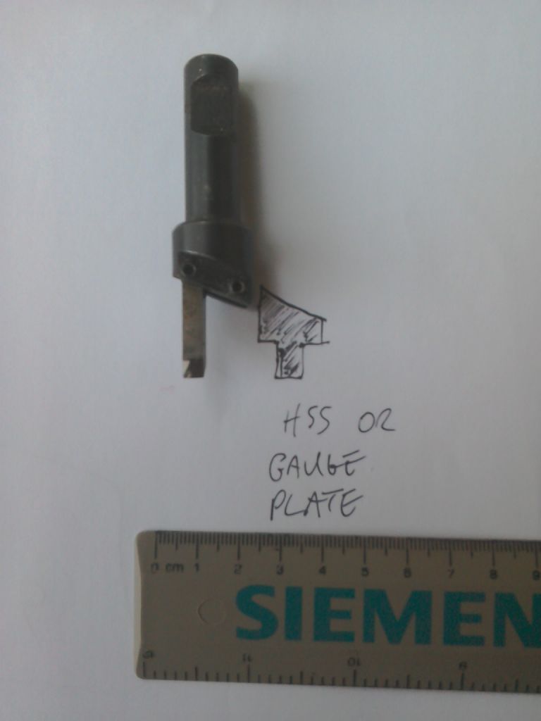

– Fly cutters by definition have a moderate radius and this means a thumping wallop each rotation.

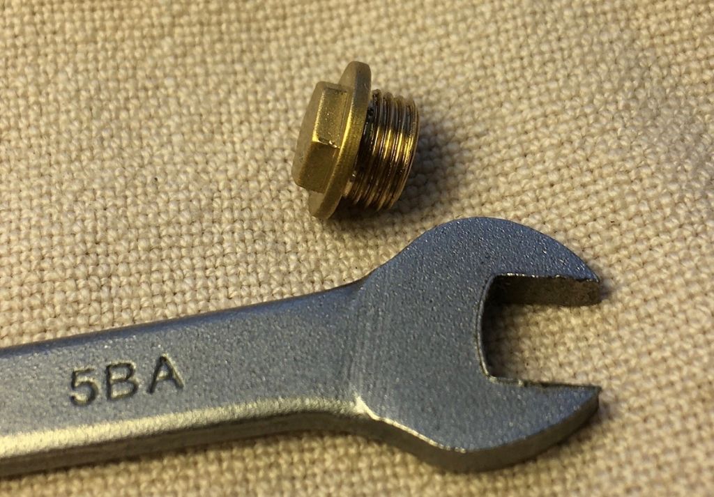

– Putting a small piece of work in a Stevenson hex ER block, and rotating that in a chuck manually, produces errors of at least 0.010". Been there, tried it, a mess. I am looking for 0.0001" in the vertical otherwise that small hex I show in my photo has all manner of irregularities in the horizontal land around it.
-The above is why working with the rotary table horizontally is better by keeping the cutting tool at a fixed depth of cut as it runs in the X or Y past each of the six faces in turn. Hence a perfect face around the hex sides.

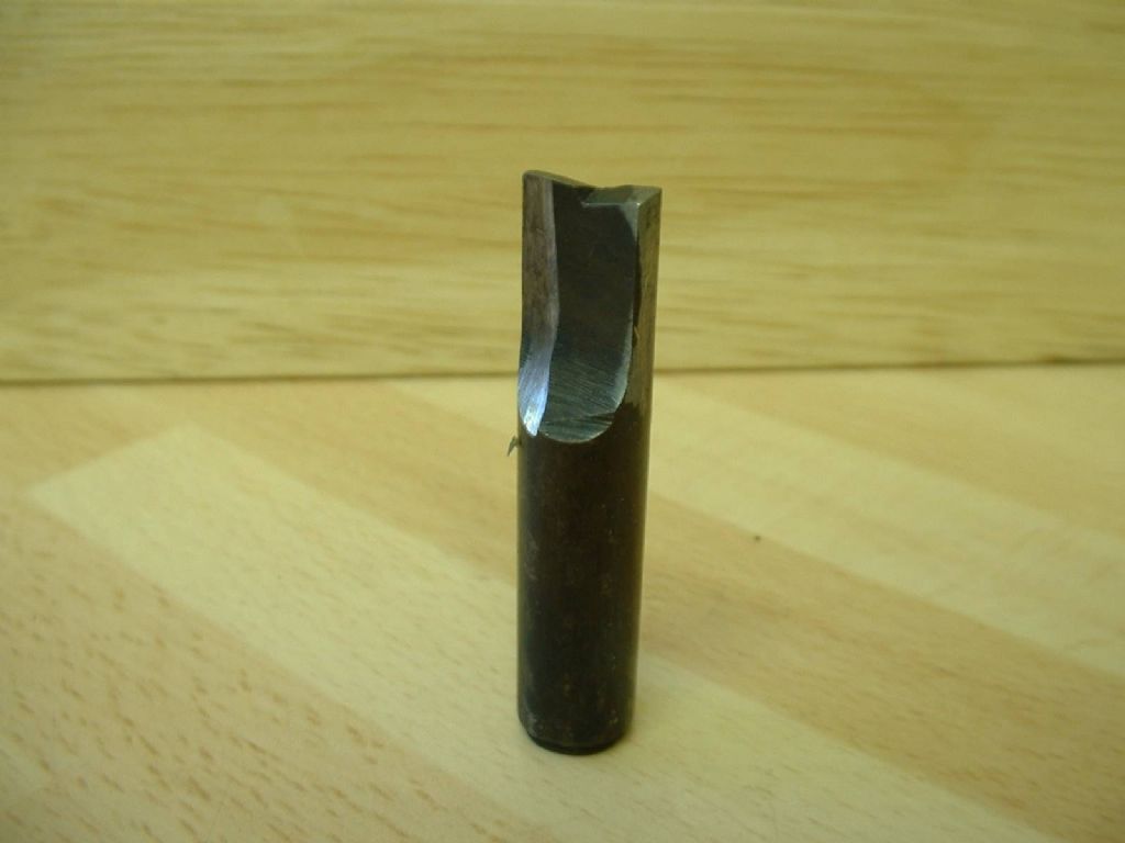

– A small, 6mm, three flute carbide cutter is the ideal cutting tool for the brass of this size. I just wish the Chinese made left hand cutting ones!
– I like Neil's suggestion and it is what I thought I would do. Make a 6mm dia cutter from silver steel, mill cut a pair of teeth with rake and relief, harden to a straw temper, then diamond hone the tips
