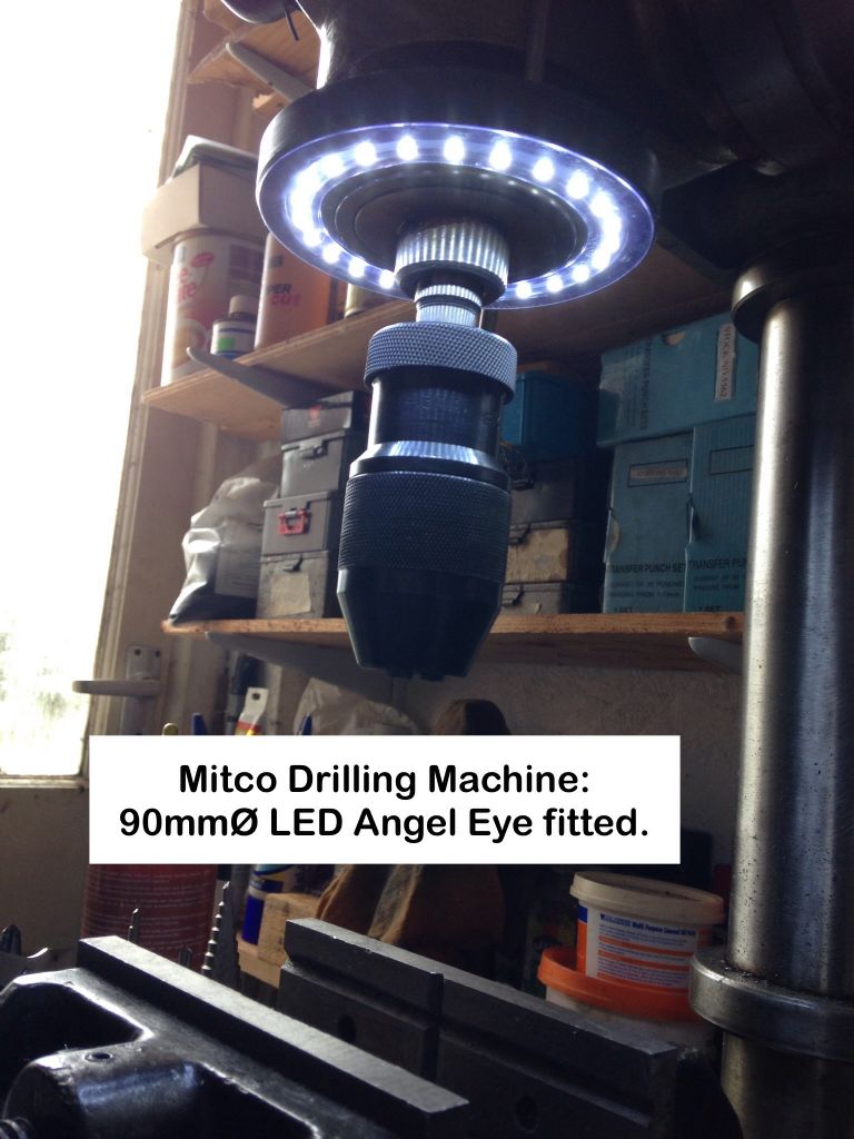

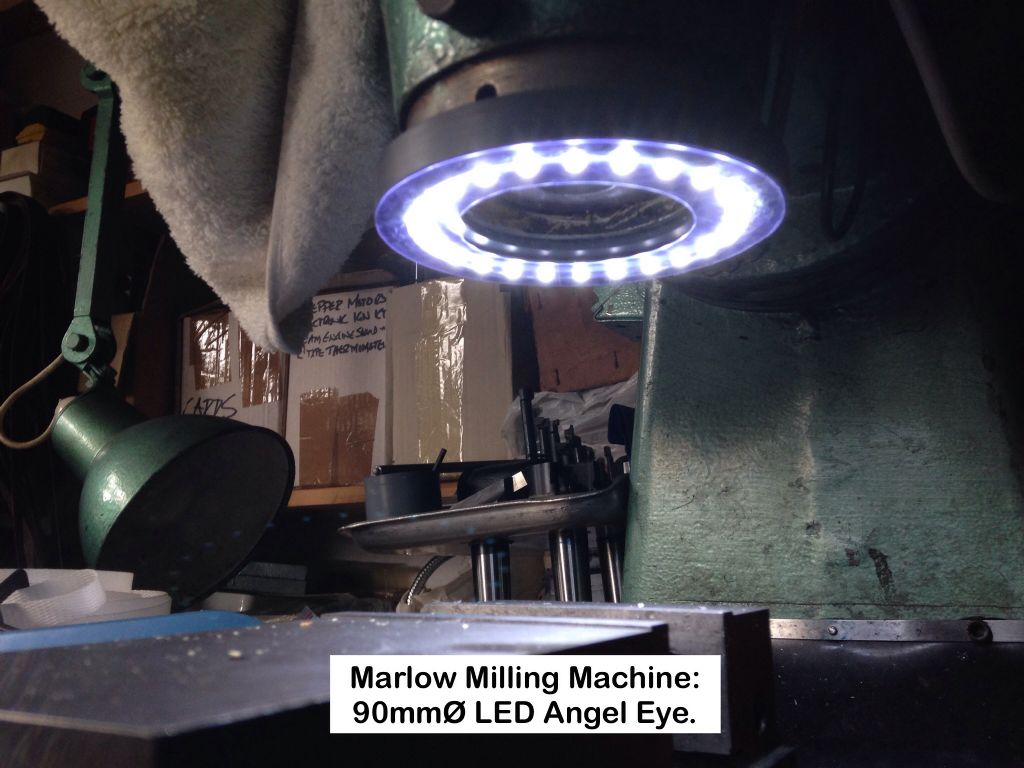

      With LEDs now easily available and in various forms, though I would kick-off with my usage.
      I have just fitted 90mm diameter LED Angel Eye lights to my Marlow milling machine and Mitco pedestal drilling maching.
      Although I have good lighting in the Workshop, there are times when I need more right at the point of action.
      Although the Marlow has articulated lamps either side of the main column, I have not found them very convenient to use, being difficult to get the workpiece and cutter illuminated to my satisfaction on occasions.
      The twin fluorescent above the Mitco is fine, but light aimed at the the drill bit and workpiece would be desirable.
      Much searching for a solution, the excellent Ikea flexible long necked ones being dismissed as they just mimicked the existing ones on the Marlow, with the same shortcomings if used on the Mitco.
      A mention of Angel Eyes on this or another Forum had me straight onto the World's favourite auction/selling site, resulting in a number of different sizes being ordered from the manufacturing centre of the World, all at prices that make one wonder how they do it.
      Some time ago I had bought 230vac/12vdc LED psu to power strip LEDS so decided to put them to good use.
      New Album added, but here are photos of them fitted.
      Marlow Milling Machine.
      Mitco Drilling Machine.
      Just need to sort out some for the Tom Senior I keep in Horizontal mode.

          Problem I have found with the Angel eyes is that they project a ring of light down but depending on diameter the end of the tool is often in shadow, with the light round it.
          I saw one fitted around the quill on a bridgy and in the photo's you could not see the cutter or say a line you were trying to follow.
          This wouldn't have suited me as for one and probably the main reason I get into setups so tight I often have the quill nearly rubbing a 4th axis or upright part of the job. This would entail removing the quill light so no point in having it. Secondly the shadow makes it unusable.
          I tried an experiment and bought the largest light I could off Ebay, sure it was 160mm but might have been 150mm and this just fits round the casting on the lower part of the head which usually is out of harms way. It was a quickly cobbled up job made from bean tins and some plastic cut on the laser. However it worked. Didn't get in the way and no shadow.
          Only problem was it was that skimpy built it used to come loose and after the third time it fell off and got whanged by the cutter, it died. New lights now on stock just waiting for some decent laser cut plates to form into a holder to class 10 on the Beaufort scale.
          #184956

            Haven't tried them in anger yet John, but will soon find out if I run into the same problem that you had.
            Would be easy enough to fit larger diameter ones if needed.
            The PSU should be capable of powering two lots at once, adding a larger one to outside of existing.

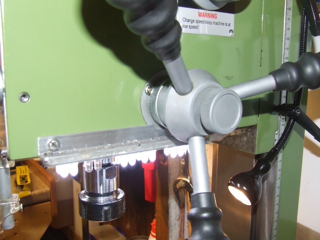

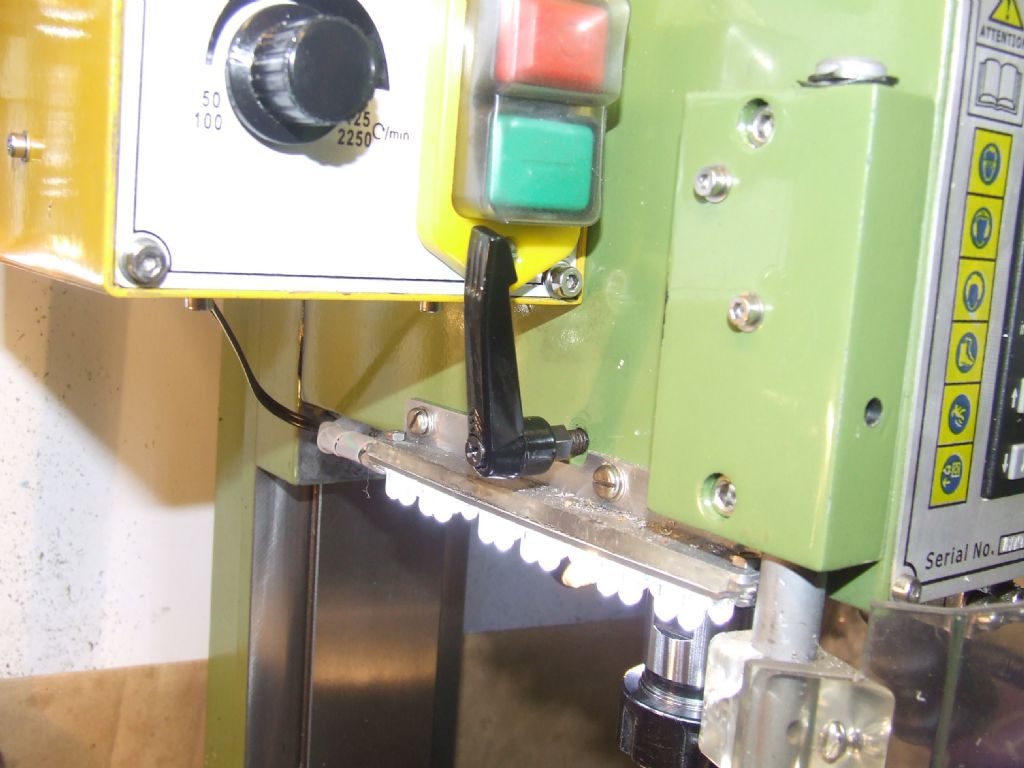

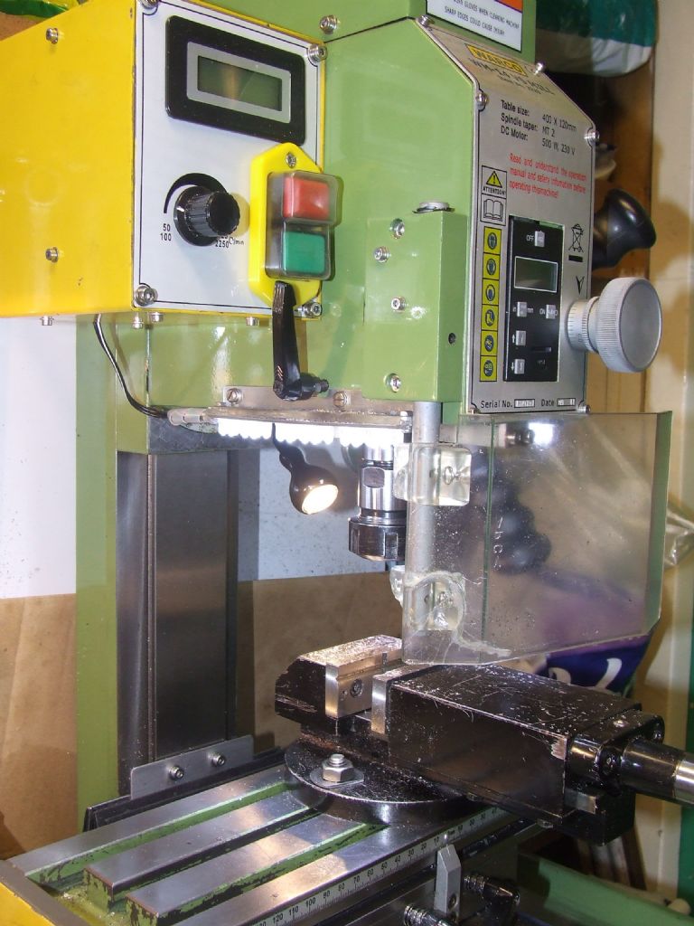

                      On my little Warco WM14 mill I have mounted two strips of 24LEDs one each side on the head of the mill. This gives a virtually shadowless illumination of the work piece irrespective of the size of chuck/collett being used. They were bought in from China, run on 12V DC and were pre-mounted on an aluminium support with threaded inserts
                      Martin
                      PS
                      Don't ask about the group of 4 that are not working on the right hand side, spanner slips oops says it all. Have got spares but not a round tuit,
