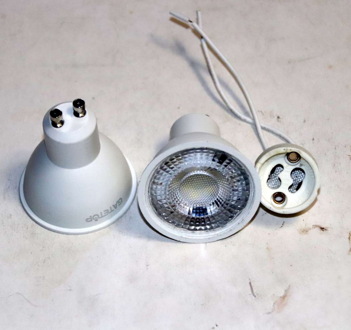

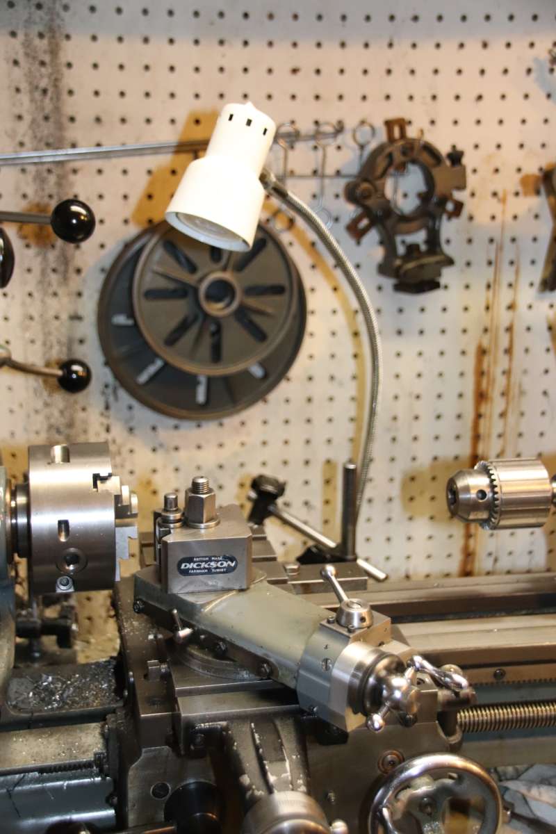

                                          This is what I use on the lathe, (and 2 on the mill), Lamps are GU10 base 8W 100-240V led running at 120V (our nominal line voltage on this side of the pond). I built the lathe one into a shroud from a defunct security light. The lamps, sockets, and goose neck were sourced from Ali. I used bright white but in hind sight ones a little cooler might be better,they are dazzling bright.
                                          Lathe Light
                                          Lamps
