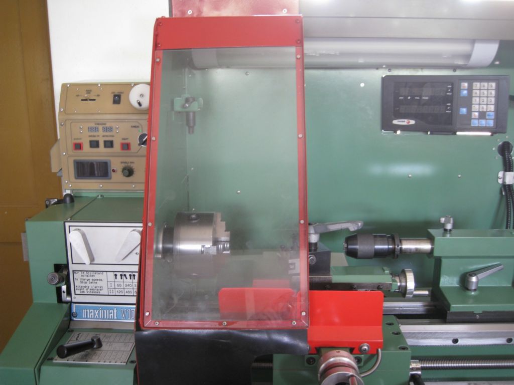

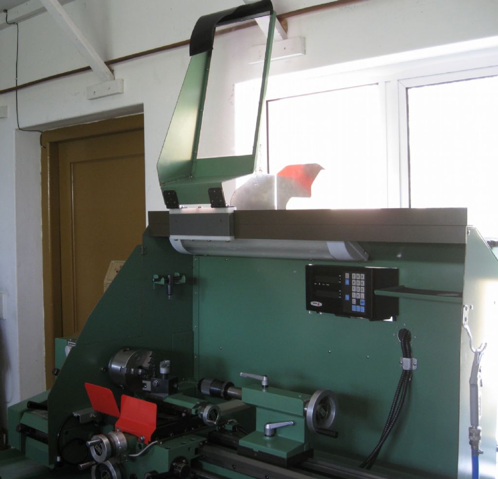

                                                    Made shields all around the mill and the lathe, with a clear acrylic swing down guard to look through at the work…
