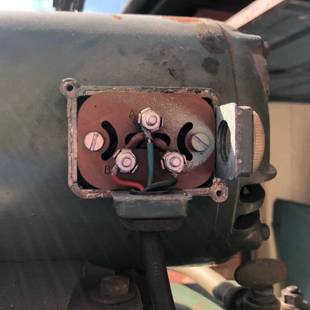

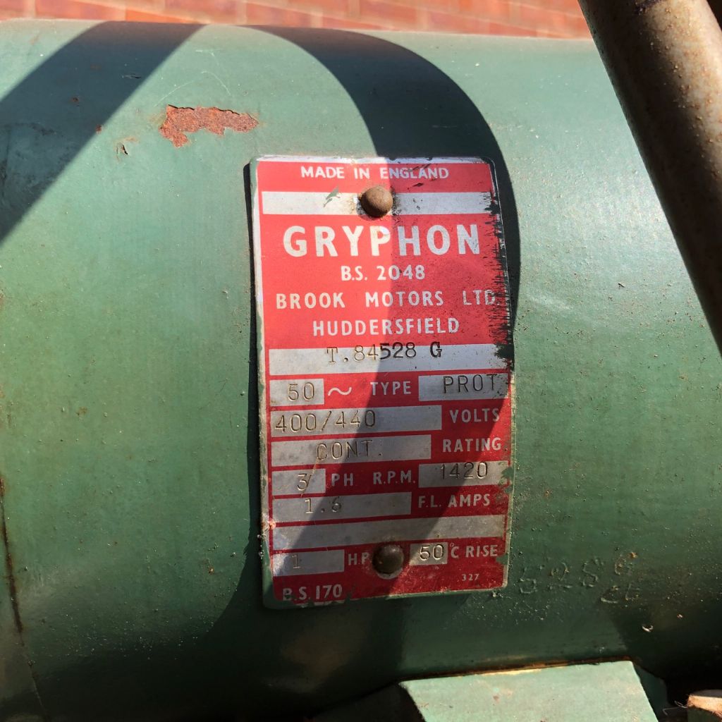

        I'm planning to convert my Senior M1 to VFD. Transwave's helpful "Converters and Inverters – layman's guide" is a lucid overview of the process, well worth a read.
        BUT…the original Crompton 3ph motor states 400V and I'm wondering whether these connections can be changed to delta/240V as required by inverters. Why does it lack the {W2, U2, V2, U1, V1, W1} that I've read about? Perhaps hiding behind that fibreboard?
        (NB I can't get to the motor for the time being for a fiddle, so am relying on these old photos.)

          As the data plate states, and as the connector block shows, the motor was supplied for 400v connection only. This means the srar point, the commoned connection of the three coils, is inside the motor body. To enable 230v three phase, you have to dismantle it, locate the star point and bring out the three wires to a six terminal connector block. Some motors are easy to do, others more difficult. The only way to find out is to take it to pieces and look.

              Having looked into using a step up transformer before I'd say its never worth it unless you happen to luck into something suitable. Allegedly such things can be found in some old fashioned welders.
              Seems to be a fairly low power motor, current stamping on the data plate appears to be 1 amp, so maybe one of the multiple output transformers on machine tools with a 240 tapping might do the deed. The Bridgeport one can, allegedly, be used in step up.
              If I recall correctly the Brook Gryphon motors put the star point on top of the windings so its easy to get at.
              If the application is fairly undemanding one of the 220 V in, 380 V out economically priced import VFD boxes may well be satisfactory. We very rarely drive our tools at anything approaching full power so the odds are that the various performance limitations inherent to making an affordable device won't show up.

                  Have rewired a similar Brookes motor and found the star point where Clive said. Nothing to stop you running the motor as is with 240 volt 3 phase but power will be reduced. I have done this on a suds pump motor where the star point was well and truly buried.

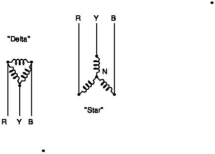

                    Three phase motors contain three windings (coils), that can be connected up in either of two configurations, Star or Delta:
                    On many motors, the ends of the three coils are brought out to the terminal box, ChooChoo's W2, U2, V2, U1, V1, W1, where W1 and W2 are the start and end of coil 'W'. etc. When this is done, the user can connect the motor in either star or delta. Star connected motors require 400V, delta needs 230V.
                    Unfortunately, not all motors provide full access to both ends of all the coils. Instead the connections are made inside the motor, not easily available to the user. ChooChoo's motor was sold for 400V service, with no intention it would ever be changed. However, it may be possible. When the motor is opened up to expose the windings, it's likely the star point (marked N above) is accessible. If so, break the connection and extend the 3 wires outside the motor so the coils can be reconnected in Delta in a terminal box.
                    Alternatively, it's recently become possible to buy affordable 230V input VFDs that produce 400V out to drive a star motor without modification. I'd be inclined to go that way because it's less work! When buying the VFD, it may be specified as 220/380V rather than 230/400V because most of the world is 220V based. Should be 'good enough'.

                      My mill has a similar GRYPHON motor on the table feed (see my Centec album). It too is stamped 400/440v and had no provision for converting to 220v delta, so I stripped it, located the star-point (where 3 windings are joined together), split it and extended the wires out to the connector block. Re-assembled everything, connected the 6 wires into delta and it now runs happily on a 240v VFD. See some photos in my Centec album.
                      It wasn't difficult and was well worth doing.

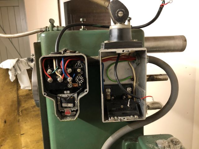

                                  Just managed to sort out the mass of photos on my computer – just created a new "Tom Senior M1" album. Should make future questions more straightforward.
                                  Important point I forgot: I'm undertaking this to give my adjustable table feed rates via all the pulleys and gearboxes on the back of the column. 90% of the time I envisage using the powered S-head for the actual cutting. Does this constitute a 'light duty' application?
                                  Please see "3 phase column panels" photo, as below. The 3 phase supply is tapped off for the Lo-Vo lamp, with it then going through to the handsome Brook enclosure that had the ON&OFF buttons (cover removed). Can connections be used in some way?
                                  Then again the Transwave Layman's guide is clear that
                                  the VFD should be wired straight to the motor with no paraphernalia in between.
