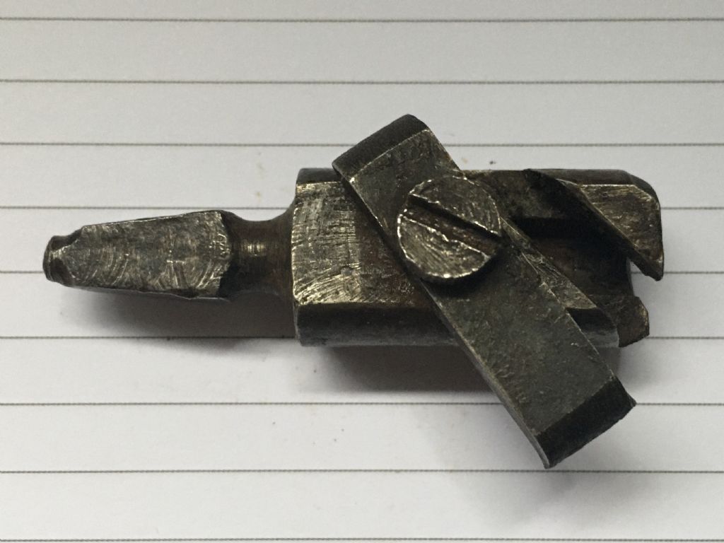

      Here’s a little mystery tool
      Looks like it should fit a carpenter's brace dont know
      There’s a plain bore up the middle, but no separate clamping arrangement for anything inserted therein.
      The clamping plate appears to be for a square section tool [and has been bent by abuse]
      I’m sure I can make something useful from it …but I wonder what it was.

          Tankcutter?
          #485790
            Posted by Nicholas Wheeler 1 on 15/07/2020 14:12:38:
            Tankcutter?
            I did wonder that … but I don’t think I have ever seen one with an angled slot.
            [ perhaps I have just led a sheltered life ]

                Joiners wood plug cutter ?

                  Possibly an early form of combined drill/countersink? The absence of a screw to lock the drillbit rather speaks against that, unless the toolbit in the slot can bear down on the drill and lock it. Or, is the bottom of the hole threaded to hold a threaded drill shank?

                      Does the screw also lock the drillbit?

                        countersunk wood plugs?
                        bored up the middle for stability

                          Just realised that the square taper, being only single … it’s more likely to be a plumber’s tool than something to fit a carpenter’s brace.
                          @Peter … the screw couldn’t clamp both the plate and the drill [or pilot] effectively … BUT now that I have separated the pieces, I note that the square cutter would clamp onto a flat on a drill shank [or a pilot]
                          As mentioned … more photos tomorrow : but I’m now thinking it might have be for facing tap seats.

                            A tool with plain shank and sideways peg would rotate into the slot and be retained by the plate. Clockwise rotation would keep the tool in the bit at the slot end, whilst perhaps drilling, screwing or cutting something, thus ensuring no rotational slippage of the tool in the bit. That implies much applied torque. Guess the tool?

                              Pipe end deburring tool.

                                I think this might be a barbed wire cutter…is there a broad arrow mark?

                                  How about a tool for twisting wire strands together?

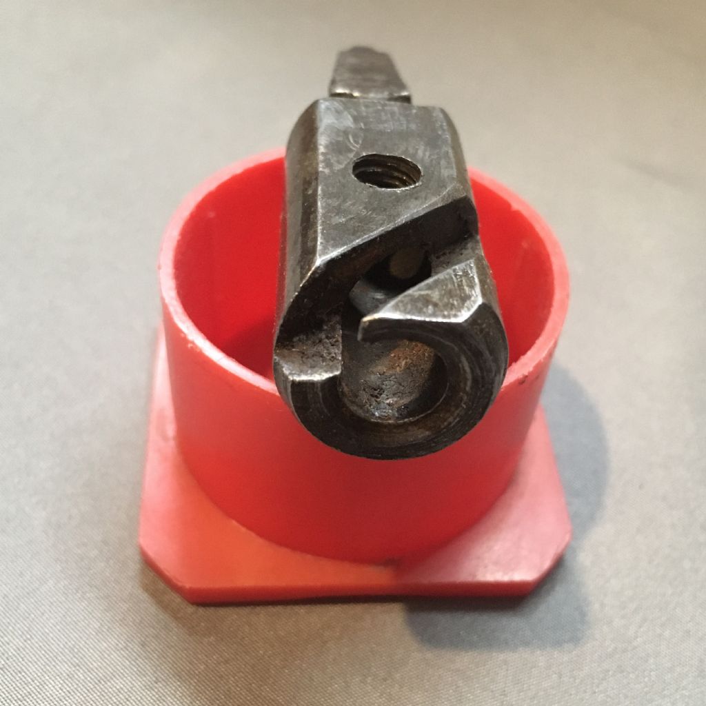

                                    It seems evident from some of the replies, that my first photo was rather ambiguous
                                    … apologies for that blush
                                    Hopefully this one makes things clearer
                                    The plain hole accepts an 8mm drill shank ; but I suspect it is nominally 5/16”
                                    … because the tapped hole is 1/4” BSF and the body is 3/4” diameter
                                    The ‘tooth’ is no such thing : it is simply the intersection of the square tool recess with the body
                                    Grateful for any further suggestions

                                      If I am detecting circular wear on the conical surface I think a pipe deburring tool is plausible. Noting that a plumber doesn't need to deburr a large range fo pipe sizes.

                                        My dad had one for cutting holes in aluminium home built amateur radio stuff in the 60’s. It’s used in a carpenters brace. A drill is mounted in the central hole which acted as a ilot. The cutter was bent at an angle so it was vertical at the end and sharpend ..wjhen pushed down the angled slot the diameter of the hole can be adjusted And clamped with the screw. I’d completely forgotten about it before this post!

                                          Plumber's tank cutter from the days of galvanised water tanks?
