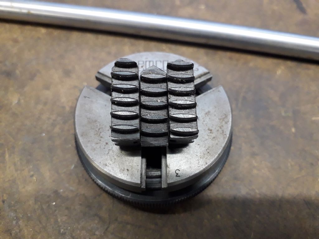

      I've got two lathes – one a bench top Austrian job, the other generic a Far Eastern 12×36. The Austrian lathe came with a Rohm 3-jaw chuck with a single set of jaws – it's only a matter of reversing them and remembering that jaw 1 becomes jaw 3 when putting it them in backwards to grip larger diameters. It works well enough. The other one came with two sets of jaws, which seems to be normal and also works well. Is there reason behind this?  Is one arrangement better than the other? Just wondering!

            I think the reversible jaws have the back of the "teeth" curved so they can fit in backwards, so there is some strength lost there, and would be more expensive to machine. Take a look at the profile of the teeth on the back of both sets of jaws and see how they compare. A pic might be of interest to viewers.
            #438813
              The smaller Emco machines had that jaw arrangement on the lever type SC 3-jaw, my view is that the thinner teeth make it weaker so OK for small machines with small chucks but not on larger chucks. As hopper says the teeth are curve don both faces which gives a flat ellipse shape, don't remember any problems of excessive runout on mine.
              Sherline are the same,
              EDIT Pic of mine
              Edited By JasonB on 26/11/2019 07:58:29

                                    Thanks for replies – should have said it is 100mm self centring. The tooth profile is as in JasonB's pic, and you definitely have to swop jaws 1 and 3 to get them to meet in the middle. The Rohm chuck is very accurate in both configurations, better than the the bigger (150mm) 3-jaw on the other machine, but that's probably down to one being Rohm and the other unbranded Far Eastern rather than the design of the jaws.
