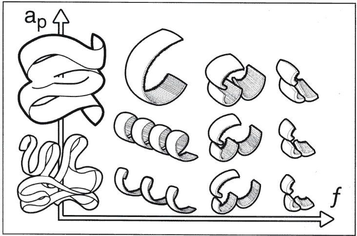

                            If you haven't got that information, your answer to 6 provides some guidance – you were cutting on the edge of the tip's envelope, or a little out of it. Have a look at this diagram, cribbed from a Sandvik publication, I think:
                            Tips are designed to produce comma shaped chips that are easily removed from the machine, and don't clog things up, and they would produce such chips if being used within their intended feed and depth ranges. Longer spirals suggests you're slightly outside the range for the tips you have. That's generally ok, a bit outside the envelope (in any direction) works fine in my experience, but as you are having some difficulties it would be better to have the tip cutting within it's range for now. So adjust feed and depth until you find a combination that gives comma chips.

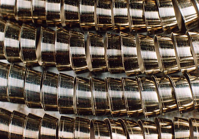

                                Something like this?….
                                Yes, that's swarf. Nasty stuff, gets into lots of places you wouldn't want it to get into ..!!! I'll stick to chips with everything!

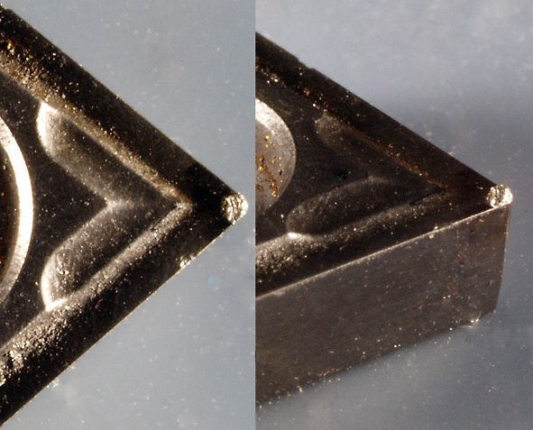

                                                Andrew, re turning aluminium…
                                                I've not done much with Al, only recently done the first serious job, turning and facing an 8" disc of the stuff using Sandvik inserts from Greenwood Tools, and did have a similar problem initially.
                                                Examination of the tip revealed the presence dreaded BUE phenomena. When this builds up, it has several bad effects, listed in no particular order:
                                                1) If it stays in place, it changes the geometry of the cutting edge and the chip forming surfaces of the tip. Chips don't form properly, or in the right direction, or both. Bits of metal stick to the turned surface, giving poor finish.
                                                2) It can break off cleanly, the tip returns to normal functionallity.
                                                3) It can break off and take some of the carbide with it – the tip is wrecked!
                                                In my case, and possibly yours, it was 1) above. I tried the usual paraffin lubricant, but the fumes were most unpleasant, so that experiment didn't last long. The answer that I eventually found was to run very fast – 2500 rpm (the VFD is set to 60Hz) at a high feed rate (the machine has power cross feed, thank God!) whilst standing well back and allowing it to shut the feed off of it's own accord! Excellent finish.
                                                If it happens again, I suggest that you take the tip out and put it under a lens. If you see something like this:
                                                then BUE is the problem. The photographs are actually steel on a Sumitomo titanium carbide tip, NSC geometry, which identifies the complex forms of the chip forming bits on tip.

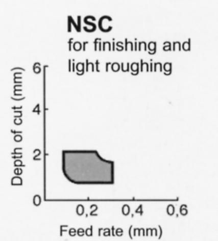

                                                However, you need the right tip to do it – have a look at the edges of the Sumitomo NSC tip above, you'll see that, by carbide tip standards, they're quite sharp. Some (many?) tips have rounded edges, which limit their minimum depth of cut and minimum diameter.
                                                Oh yes, whilst looking at that tip – set the tip of the tip to centre height, keep the gauge well away from the chipbreaker parts – the Sumitomo NSC shapes are significantly HIGHER than the very tip of the insert, so sitting the gauge thereon would result in setting the tip far too low.

                                                    From that we get that the NSC geometry is intended to operate with depth of cuts in the range 0.5 – 2mm (0.020" – 0.080" ) and feed rates of 0.1 – 0.3mm/rev (0.004" – 0.012" ). Within those ranges they will cut and CHIP FORM exactly as their designer intended. However, they will work outside those ranges, albeit without 'correct' chip forming – but acceptable in a model engineering, non-production environment. I've used them down to 0.002"/rev feed (slow feed tumbler gear on the S7) with depth of cut from say half a thou up to 0.125" – that photograph of the swarf was 3mm d.o.c., can't remember the feed, probably 0.004"/rev., but definitely not chip forming correctly!
                                                    So a tip that will do d.o.c. 0.5 – 2 mm at feed 0.1 – 0.3mm/rev would be a good starting point. These tips would not be suitable:
                                                    ap is the d.o.c., fn is the feed range, Vc is the cutting speed. Don't worry about cutting speed, not significant for model engineers, and they'll all work outside those ranges. The speed ranges are for 15 minute tool life – cut faster and they'll wear out quicker, cut slower and they'll last longer. We're not worried about optimising tool life, and they'll all go faster than we would need anyway!
