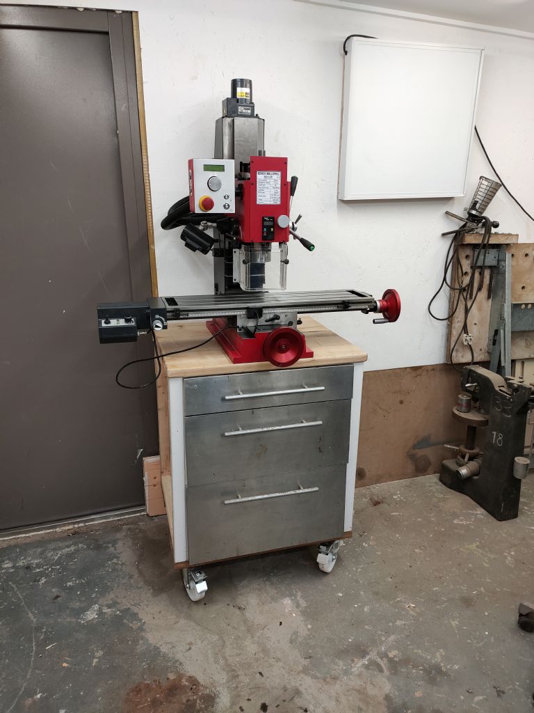

          Some minor glitches with the mill, but I'm over that now. The box it comes in is huge and an almighty bother to move but now the mill is in place it is 'just the right size'. I have already moved its location in the workshop several times as I work out where it fits best. The Mill comes with 4 Tnuts to help fit the vice.
          I took a punt on the cheapest 2 axis DRO that still had the sexy features I'll never use like radial coordinates. Just over £100 delivered due to special offer on the day from Vevor. I only gave it 50/50 that I'd receive what I expected, and that it might take months…
          The DRO did come in two separate deliveries… but it all arrived in not much more than a week, and it works! Already I'm happy!.
          The X axis is 1m so a bit long… I'll just take an angle grinder to it and see what happens. Not sure if I put this on the mill or the Myford… Do I need 3 axis on a mill that already has dro on spindle?
          Edited By jaCK Hobson on 22/02/2022 17:12:23

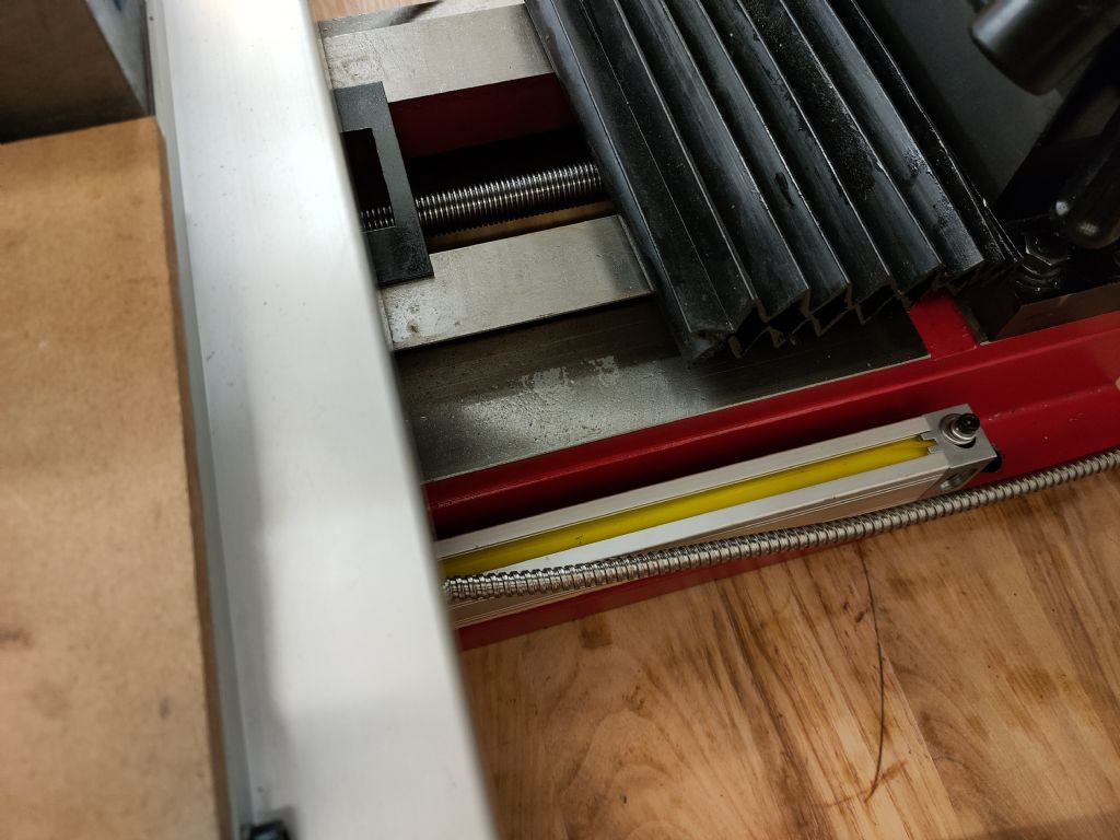

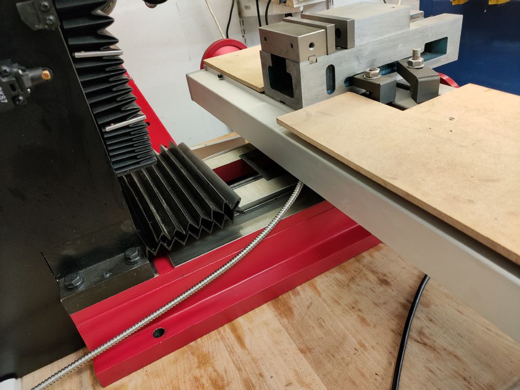

                      The DRO works. Bargain.
                      X is neat:
                      I'm a bit worried about Y – I should really turn the scale up the other way to minimise dirt getting in (for now I leave a bit of extrusion resting on top).
                      Does anyone want to encourage me to turn it upside down, or do some people live with a scale this way up?
                      Tips for installation:
                      I started trying to complete the install without any dismantling of the mill but it is so much easier once you do! And tapered gib strips make is simples.
                      Again I am glad I got this size of machine and not any bigger – the cross slide is about as heavy as I would like to handle on my own without any assistance.

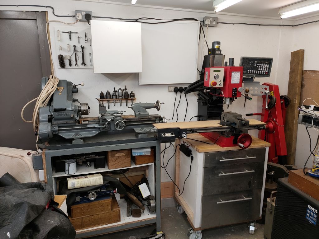

                      Thoughts on the SX3.5
                      The flaking paint issue is extensive on my mill. I was forewarned so I'm managing not to let it bother me. Be careful to check if paint is going to bother you!
                      The X power feed installation feels like it lets the side down. The electronics and motor are fine, but the hosing is thin plastic and will not last much longer. I have had to take the cover off a few times and if you put the wrong screw in, or over tighten, then the plastic cracks and that screw hole is then no good. I got 2 screws left holding the panel on… and they come undone because I don't want to over tighten like I did the others. I thin I will be 3Dprinting a new box within 12 months. The wire to the limit switch dangles around … not sure what the soln would be though. The power is via a separate brick about the size of an old laptop power supply, and the power input socket has its threads stripped so dangles out the box. Note that there are extensive power supply options hidden in an enclosure behind to column so a nice soltion would to have been to provide the power from there.
                      The column is no where near as massive as it seems in the sales pictures – most of that is a steel sheet covering to enclose the power and electronics.
                      The Z power lift however is a nice install. Enclosed power supply, hidden wiring etc.
                      The quality of finish, including surface finish, tends to be good enough and no more. An example is the gib strip. Where you might expect a scraped surface, you have the same effect but achieved with a hand held grinder. The actual points of contact are probably less than 10 across the whole gib – but these are at the extremes so it does its job. I don't know what impact this might have on wear.
                      The rest of the wiring and circuit boards are all neat.
                      As far as being a good or bad mill… I have no idea as I have nothing to compare to. But if you are buying, then be prepared for the above and you will be much more likely to avoid dissapointment.
                      #588621
                        My scale is the other way up.
                        I was sent one of the same power feeds by Ketan 4-5years ago to trial before he made a decision to stock them and it's still working fine with no signs of cracking or breaking and I have had it apart a few times as part of the evaluation process, all screws still present and correct..
                        Edited By JasonB on 07/03/2022 14:40:17
                        #588626
                        Mike Poole
                          @mikepoole82104
                          I would remount the scale so that gravity is on my side rather than working against me, a stray chip could destroy the scale as they are usually glass and once broken or even damaged it will be game over. When I was a sparky in a tool room you had to wonder how swarf got to the places it finds, but almost nowhere was safe.
                          Mike
                          Edited By Mike Poole on 07/03/2022 15:04:19

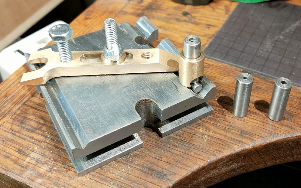

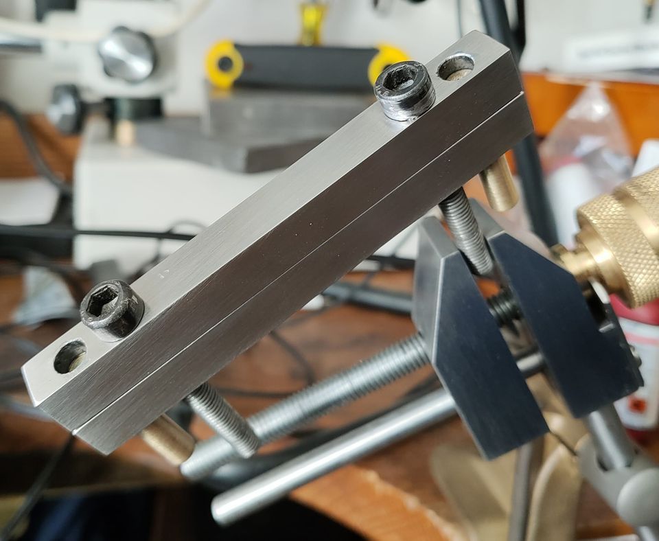

                            I made something, mostly on the mill, using lots of different cutters, saw, power tapping, workholding, positioning etc!
                            I just made it up as I went along, so design flaws, but lots of fun! I haven't quite worked out how to use the thing best in all situations but I can at least use it. Not got to 5000 rpm yet.
                            I failed to make a brass thread to fit despite using matched M6 tap/die! Std m6 bolt goes in brass hole, std m6 nut goes on thread, but brass thread don't go in brass hole

                              Posted by jaCK Hobson on 26/07/2022 16:10:39:.
                              Either it's a little bit tighter than the commercial nuts and bolts (which tend to be a rather sloppy fit). If so tighten the die up ever so slightly and take another pass.
                              Or there's a bit of a burr on the start of one of the threads that the chamfer on the commersical nuts and bolts are navigating ok. If so, a bit of work with a file or deburring tool might help.

                                      jaCK Hobson
                                        @jackhobson50760
                                        Posted by Mark Rand on 26/07/2022 17:45:50:
                                        Meanwhile:- Nice work. smiley
                                        The die is not split. Comes from the std machinemart metric tap/die set.
                                        I can't work out what happened. Maybe the thread blank was oversize slightly when I cut it – I remember it being a little tricky to start. I filed off about .5 mill of the thread diameter and ran the die up and down with positive/negative pressure etc to try and get a bit more metal off… but the threaded hole just won't have it.

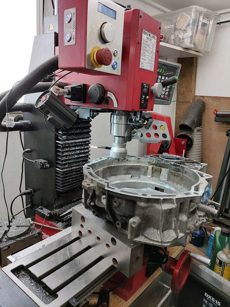

                                              A couple more useful basic milling projects.
                                              #679559
                                              jaCK Hobson
                                                @jackhobson50760
                                                Glad I didn’t go for a smaller mill. And I finally used the extra travel length on the 3.5 over the 3. Hurrah
                                                There is an argument I needed a bigger mill…
