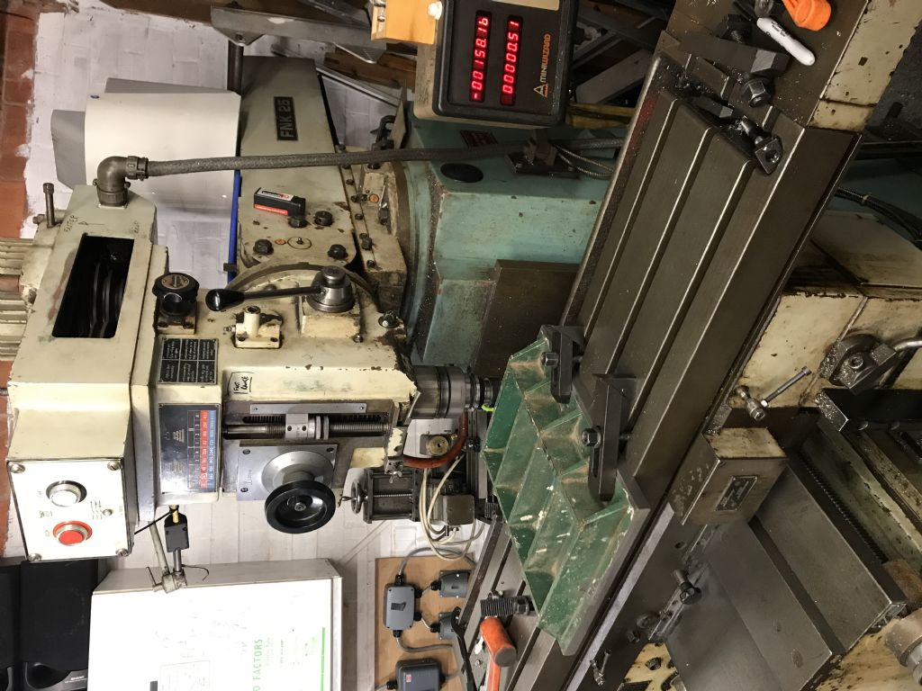

                  Dave S
                    @daves59043
                    Not directly comparable but my TOS has a top speed of 4500 and I often use it.

                        Pete Rimmer
                          @peterimmer30576
                          Posted by Dave S on 02/02/2022 18:54:48:
                          Which TOS do you have Dave? I am renovating a FN22 and it has a high-speed head for 3100-5000rpm.

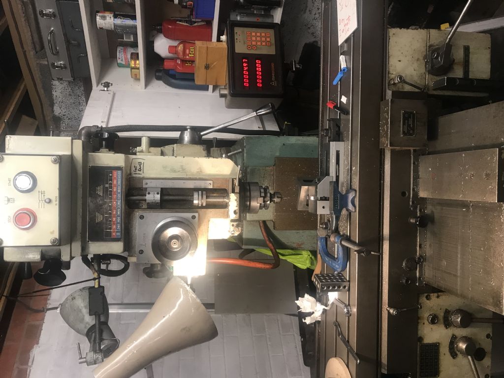

                            Dave S
                              @daves59043
                              A FNK25. Bought it on eBay for £600 a good few years ago. It was somewhat larger that I intended, but I’m very attached to it now.
                              The size is really useful sometimes, but it’s also sensitive enough to drill sub 1mm holes and use 2mm carbide cutters. It makes an excellent tapping stand – done a fair number of M1.6 threads with it.
                              This was during the making of a stainless steel watch case for my daughter. If you look closely you can see the tiny cutter.
                              I can’t figure out how to make the pictures the right way up.

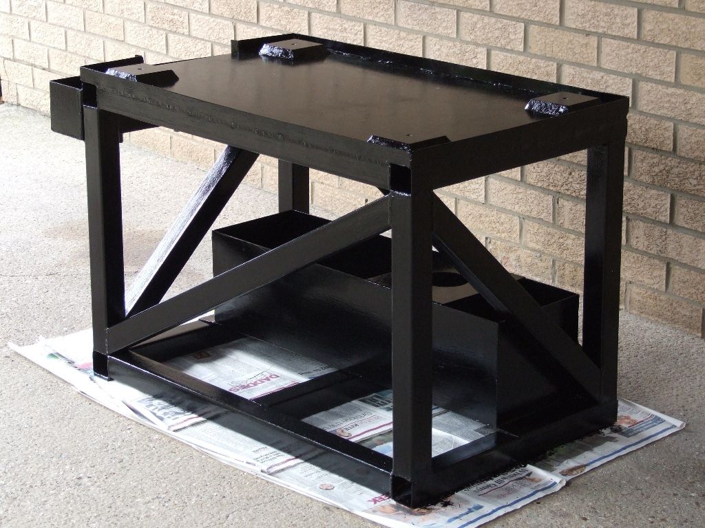

                                    Anonymous
                                      Posted by jaCK Hobson on 04/02/2022 15:37:10:
                                      ….anyone get excited about the stand for their machine….
                                      Not really; two of my mills are floor standing. For the third (CNC) I made my own stand and coolant tank:
                                      Andrew

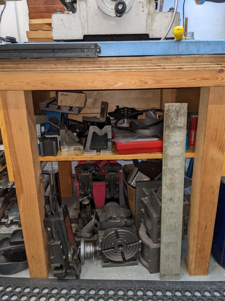

                                            If you put legs down each corner of the kitchen cabinet and a solid back panel over the lot that should stiffen things up.
                                            My X3 and SX2.7 sit on not much more than carcases with a solid bench over the to that is fixed to a batten along the wall. The KX3 is on a pair of legs fixed to the cabinet at the side with a tick ply top also tied to the wall
