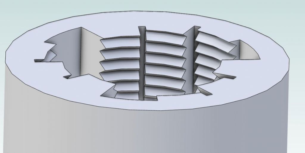

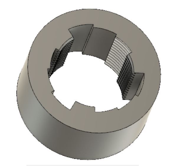

      Struck me today that modelling the Welin Interrupted Screw as used on the Vickers Bl 8 inch Howitzer (Mal Webber's build) would be a challenge for a 3D CAD package.
      My attempt with Fusion360 started well but failed at the last hurdle.

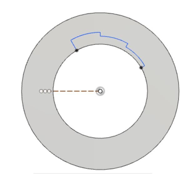

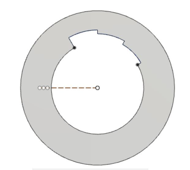

      Step 1: – Create breech ring and mark-out 30degree notches
      Step 2 – Pull-cut the slots
      Step 3 – Multiply slots by 3 with a circular pattern

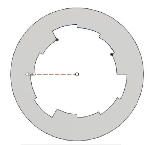

      Step 4 – Model a Real Thread on the innermost surface
      Step 5 – Model a Visual Thread on the middle ring. (A visual thread is a representation painted on the surface. It would generate g-code, but to save computer time and memory doesn't actually number crunch and add a real thread to the model.
      Although it looks promising at Step 5, Fusion breaks when asked to convert the visual thread into a modelled thread.
      Step 6 is mangled!
      Can anyone suggest a way of modelling a stepped interrupted screw thread in F360, or show how it can be done in any other 3D CAD package?

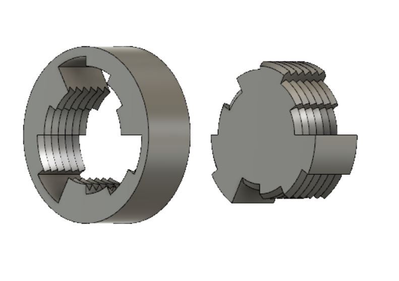

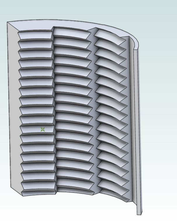

            I would do it this way:
            Extruding the core for a male plug
            Add the segments for the next stage, sweep out the threads.
            Add segments for the final stage and sweep out the threads.
            Internal would essentially be the same but starting with the largest diameter. This may be harder to visualise which is why I described the male version.
            Something like this – the order of parts in the history is important

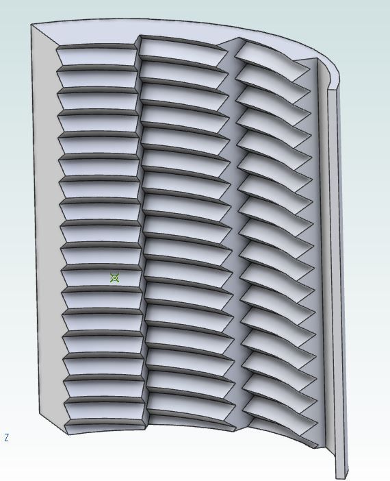

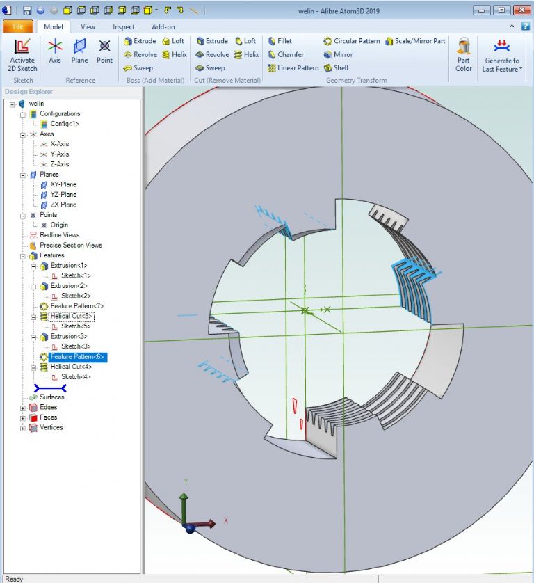

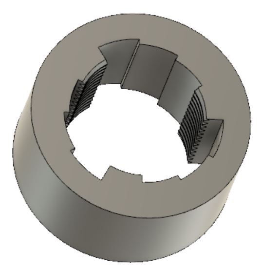

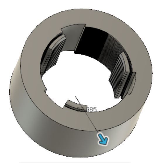

              Thanks Neil, I'll give that a try next. Jasons suggestion works fairly well but the 'threads' produced are straight, rather than screw spiral. (Actually I'm not sure breech threads are spiral cut on a real gun. Maybe they're just locking slots rather than a true interrupted screw. If the obturator provides the gas seal there may be no need to cam the breech into the breech block. Perhaps a trip to Fort Nelson with camera is in order!)
              On the right is an attempt at a breech produced by using a copy of the breech block to cut the outside of a cylinder. Nearly works but I'm having trouble cutting the excess smooth bit off without upsetting the model.
              #429753
                Mine come out spiral as they are done as a helical extrusion so pitch can be setbreech.jpg
                Shows up more if I double the pitch
                Edited By JasonB on 20/09/2019 15:46:05
