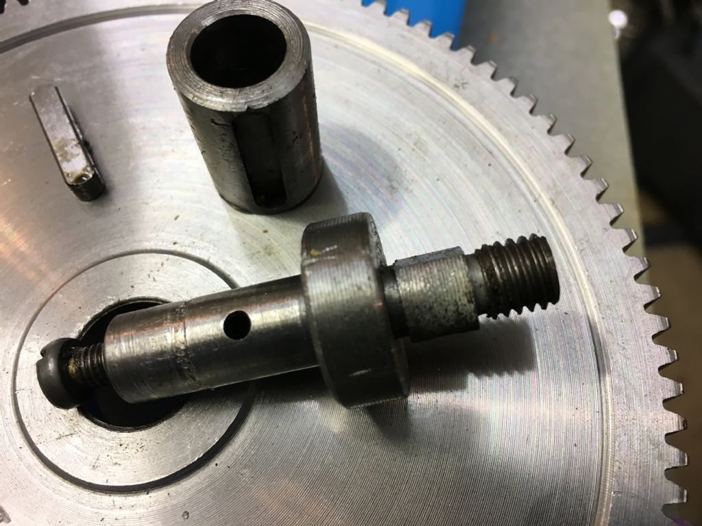

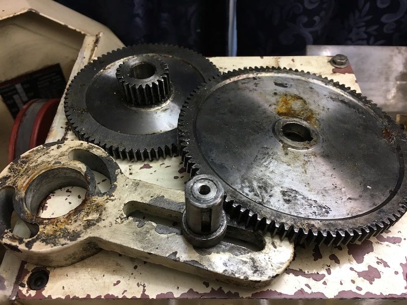

      I have an Axminster mini lathe that stoped working this morning. The motor was running but the chuck wouldn't turn. Like it had stalled.
      I started to investigate and found that if I removed the large gear that sits between the leadscrew and the driven gear the chuck would turn as normal.
      I found that the gear off the quadrant would not rotate on the shaft. (See picture of shaft below) It screws into an arm that is bolted around the lead screw shaft.
      I'm assuming that's a bearing on that shaft under the gear and that it is seized?
      If it is a bearing does anyone know where I can get another and how I get it off?

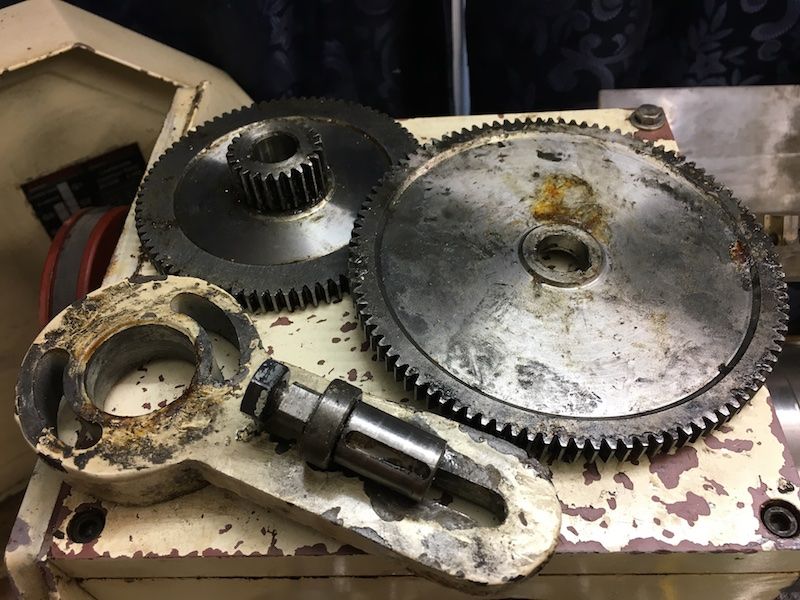

          Hello again.
          After a bit more research it seems it's a bush on that shaft and that is what has seized.
          I may try some heat to see if I can remove it that way.
          I can order a new bush but the shaft is out of stock. Ideally a new shaft and bush would put it all right.

                                    Hard to be sure from the picture but it’s looks a little like my BV20 Lathe.

                                      Just a quick update.
                                      Putting the gear back on, holding the assembly in my vice and wiggling vigorously worked after a soak in PlusGas (There is no other penetration fluid and don't say WD40) haha. Thanks Mike, good suggestion.
                                      As you can see from the attached photo the shaft is quite scored as was the centre of the bush.
                                      I started gentle, cleaning with a fine wet and dry. That had an effect but didn't allow the bush to run clean on the shaft. So, having cleaned the shaft of any burrs and high spots I put the bush in the lathe and using a very small boring bar I reamed out the centre by a really small amount.
                                      That had the desired effect and everything slid back together smoothly, with the addition of some horrible think black Moly grease it all works fine.
                                      I say fine, I still intend to purchase a new shaft and bush when they are back in stock.
