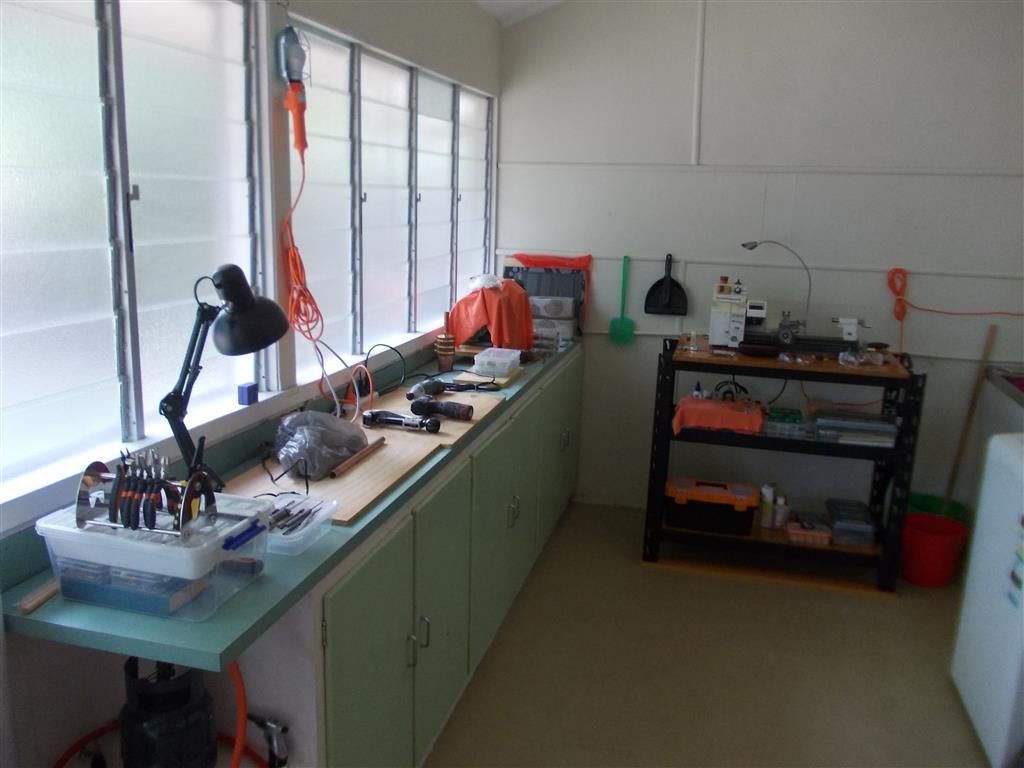

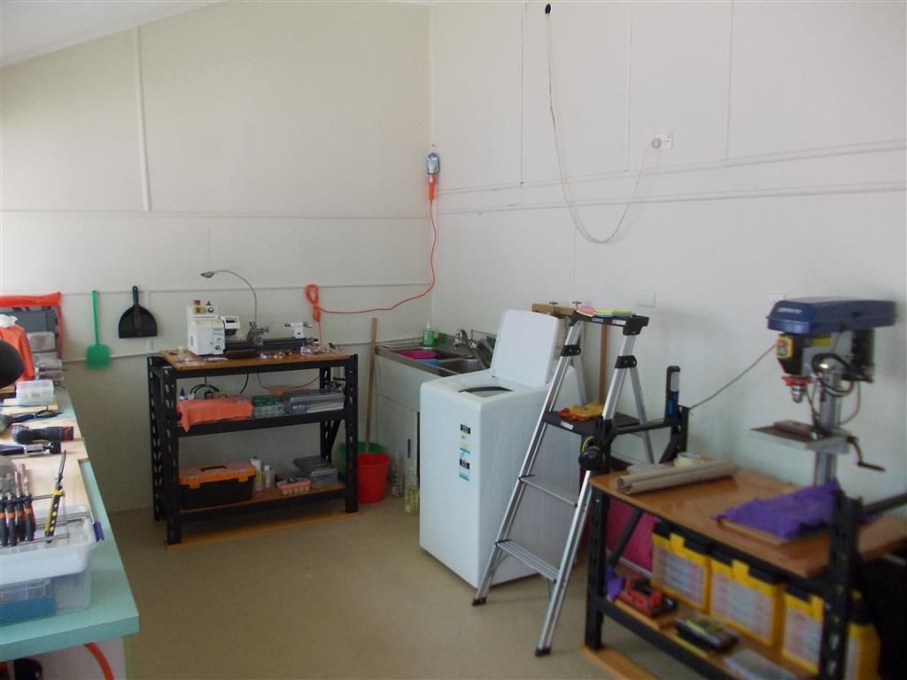

              Another holdup : I have spent the last two weeks moving house (wife's idea) and cleaning the old apartment to vacate standards. The new workshop has much more room than the old living room ; lots of cupboards and storage space.
              The drill press seems a bit wobbly for some reason and that will have to be looked at. The lathe bench is firm and stable. I have spent the morning rereading this thread and working out where I am at. I don't even remember making some of these parts !
              For Australian residents : Now that Miniature Steam are no longer selling bar stock, who are you buying your brass and gunmetal bronze from ? What is the smallest diameter gunmetal bronze that you can readily buy ?

              #308618
              Hopper
                @hopper
                Brian, the new workshop looks good. I buy my bronze and brass from Allied Bearings usually. Not sure how small they go down.

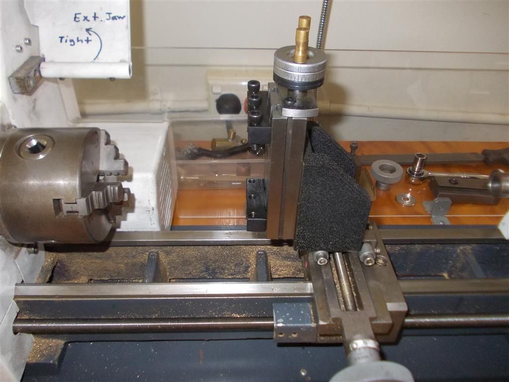

                    The vertical mill slide arrived today and I have been watching some youtube videos on milling in the lathe. Some people seem to think that holding the milling bit directly in the lathe chuck is a bad idea and it should be held in a collet to avoid damaging the chuck. Is this correct ? What type of collet should be used ?
                    #309213
                      It won't damage the chuck, some say a 3-jaw won't hold the cutter as firmly as a collet but if you just take light cuts then it will be fine in the 3 jaw. That Minnie traction engine in my avitar had all the milling done on the lathe with cutters held in the 3-jaw

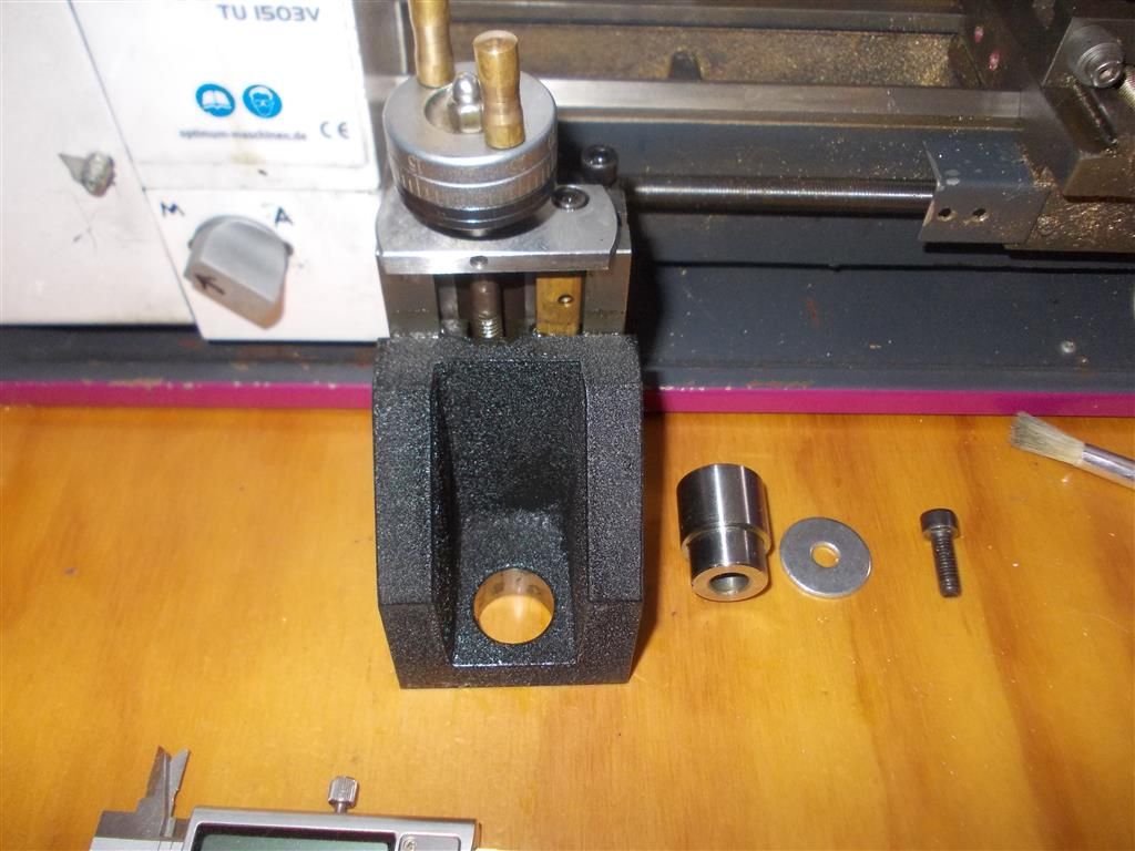

                        Trying to fit the vertical mill slide. I removed the top slide from my lathe. It looks like the supplied steel bush fits in the hole on the mill slide then using a washer and a M6 X 44mm socket cap it will be screwed onto the cross slide. Unfortunately I do not have an M6 x 44mm socket cap or an M6 X44mm bolt of any type so things will have to wait until I source that.
                        Am I on the right track here ?

                        #309310
                          To get you going why not use the long stud that is laying next to your tool post and a nut, may need a bit of scrap tube or a couple of larger nuts to use as spacers if the thread is too short.
                          Is there just one hole in the bottom of the slide casting?

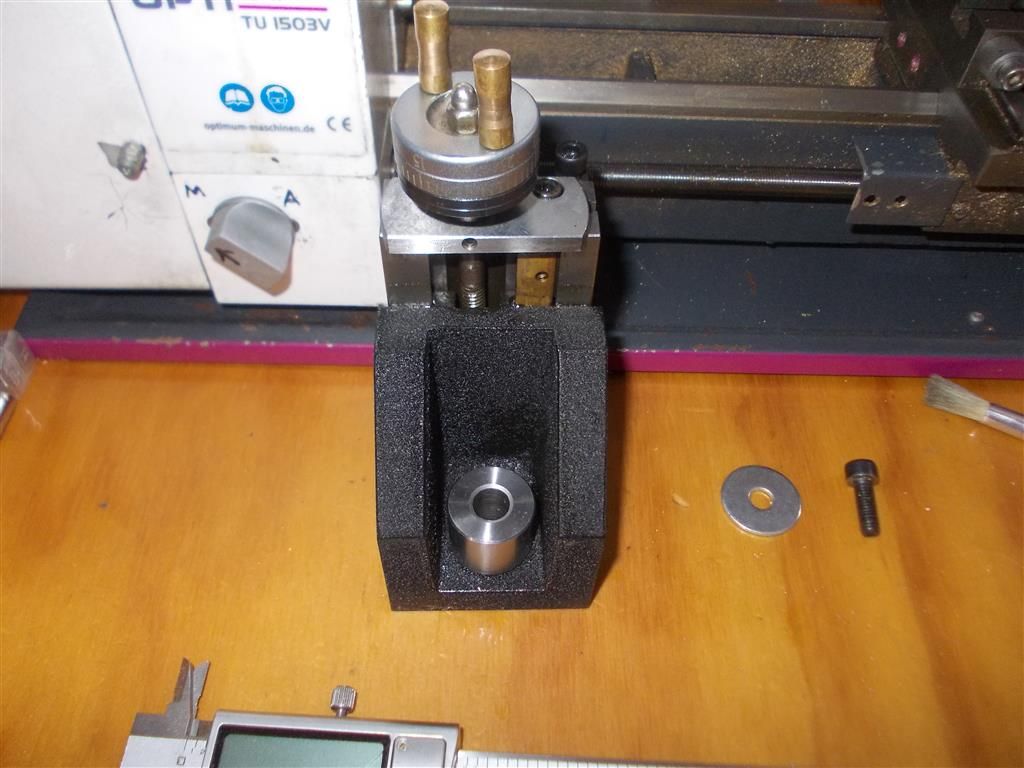

                          #309313
                          Brian John
                            @brianjohn93961
                            Here it is with and without the bush :
                            Why did they make the bush so long ?

                            #309330
                              by raising it up you will get more swing on an allen key allowing for the length of the short side of the key.
                              I'd definately try it using teh stud from teh toolpost and a packer if needed.
                              #309399
                              Brian John
                                @brianjohn93961
                                Wonder of wonders : Bunnings had some M6 X 45mm socket caps on the shelf. I used two washers to get a good fit and it looks like it is ready to use.

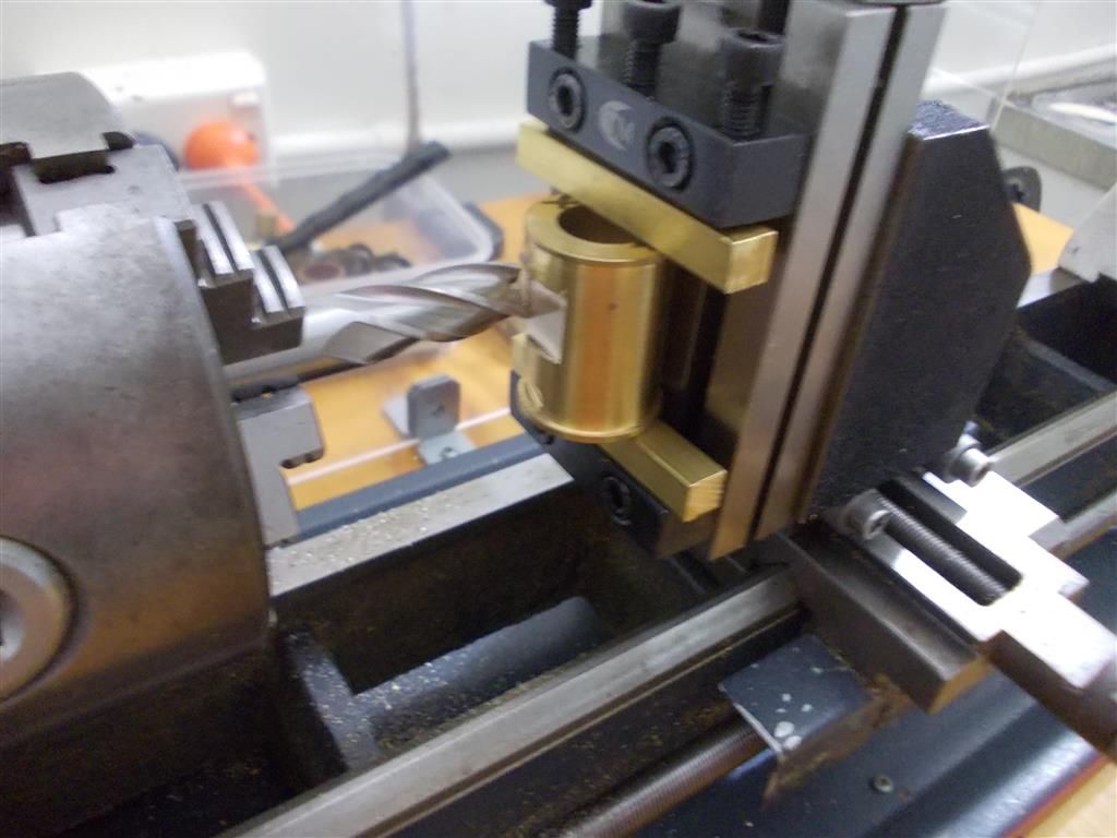

                                    #309427
                                    Brian John
                                      @brianjohn93961

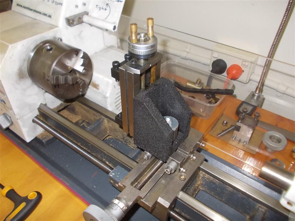

                                      Please check out how I have mounted the cylinder in the mill slide and comment if this is correct. I have removed 1.0mm from one section taking 0.25mm at a time. I am using about 600 RPM on the lathe ; it seems to be working.

                                      #309439
                                      Lawrie Bradly
                                        @lawriebradly72996
                                        Brian, Success at last. How anyone at Bengs could suggest that 'the flat' could be achieved with a file is beyond me. (Though apparently apprentices at Rolls Royce in the early 20th century had to be able to file a one inch square on a round shaft, to earn their papers.) Anyway, with the vertical slide, for you and the Danni engine hopefully it'll be all plain sailing from here on in!
                                        In the meantime I've been trying to post a photo of my progress making a scratch-built twin cylinder version of the Danni, alongside the single cylinder kit – which still has a long way to go – but I can't access my photo album when I try to post it to the forum. I might have to ask my son how to do it.
                                        #309443
                                        Brian John
                                          @brianjohn93961
                                          Lawrie : I wonder how long it would take to file the flat by hand ?
                                          It is progressing slowly : the only problem I am having at the moment is the top of the cylinder is pulling slightly away from the mill slide towards the cutter (about 0.5mm). I will experiment tomorrow with better mounting methods than the brass bars I am using now.
                                          ''A one inch square on a round shaft'' : Was that brass or steel ? Did anybody on this forum have to do that in their apprenticeship ?

                                                Hi Brian, I reckon I would try to grip the ends of the cylinder with not quite parallel brass jaws – so the outside of the jaw grips (with a bit of clearance) towards the slide. Sort of clamping the work piece against the slide. It would involve making a shallow angle (a couple of degrees) chamfer on the brass jaws. But then, what would I know. My only qualifications are in economics!
                                                #309453
                                                Lawrie Bradly
                                                  @lawriebradly72996
                                                  I think the expression I might be looking for is "pulling it into a taper"!
                                                  #309456
                                                    It is only a face to be soldered so not that hard to file to a suitable flatness, the solder will take up any slight variations.
                                                    Brian I would take the bottom packing out and move the lower jaw up if needed. You may also need to tap the cylinder back against the slide as you tighten up the screws
                                                    #309467
                                                    Brian John
                                                      @brianjohn93961
                                                      I was worried that if I took the bottom packing out then the steel jaws of the vice might leave some sort of mark or indentation on the brass. I am going to try a larger piece of thick, flat aluminium for both top and bottom if I can find something suitable from NORWELD tomorrow.
