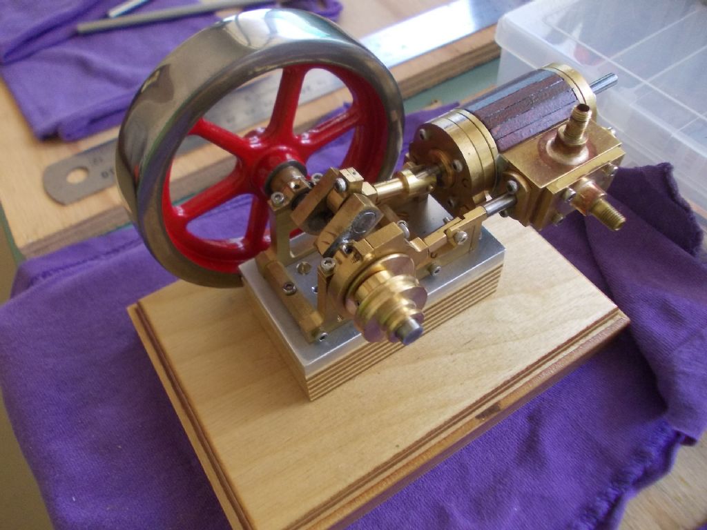

      Lawrie : your chuck probably weighs as much as my lathe

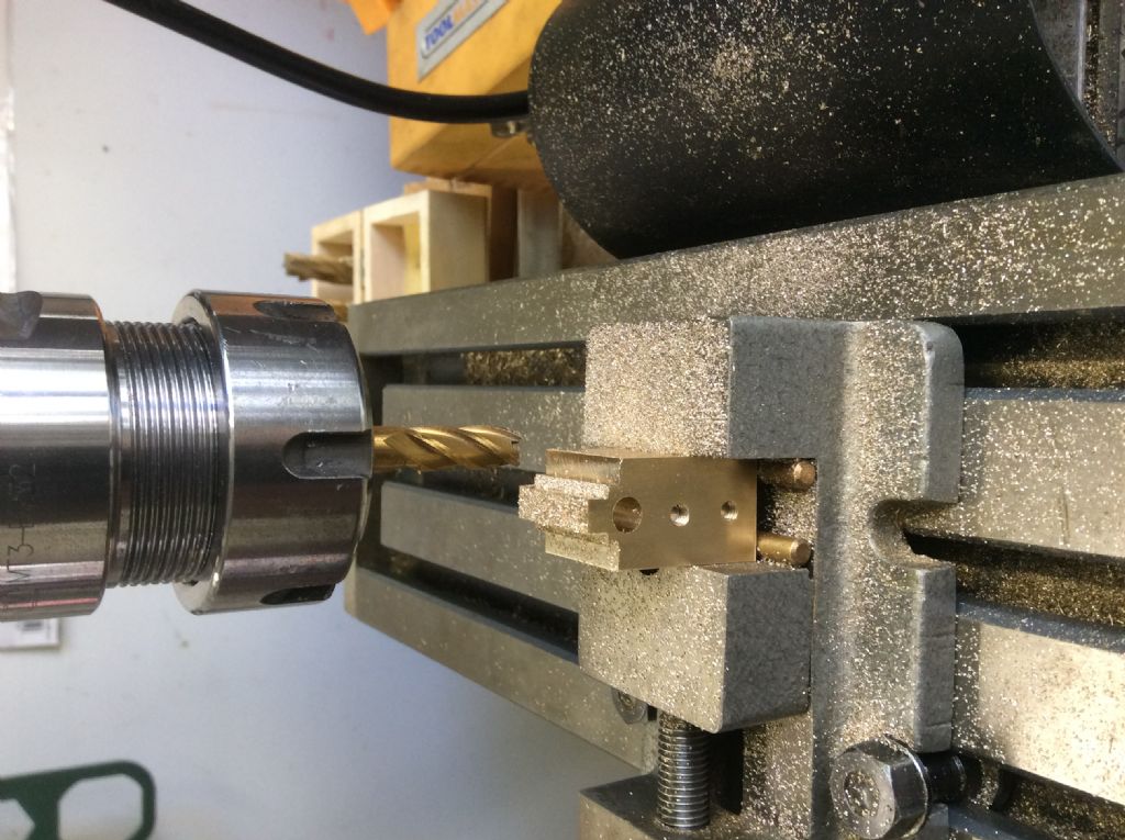

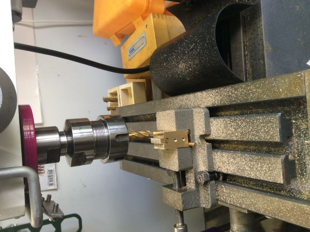

      I spent the afternoon mucking around drilling and tapping holes and finally ended up with something I am happy with. I have drilled and tapped the 6mm thick aluminium plate to take two M2 X 14mm cap head screws which pass through the engine frame and the plate. These are further secured on the under side of the plate with two M2 nuts ( not necessary but I did it anyway). The plate was then screwed to the wooden block using five 5/8'' #2 wood screws ( five was overkill). I fitted the large flywheel and it all runs well.
      Tomorrow I will glue the wooden lagging to the cylinder. That large bare space on the cylinders always looks a bit odd to my eye. I was going to file a flat on the crankshaft for the eccentric grub screw but then I realised that I would not be able to make any fine adjustments to the timing if I did that. Any thoughts on this ?
      NOTE : I did think about painting the Al plate brunswick green but decided against it. And the same with the engine frame… it's really not worth it. The wooden lagging will give it a lift.

        best to leave filing the flat until you have tweaked the settings to what works best, you can then mark the shaft, take of eccentric and file the flat.

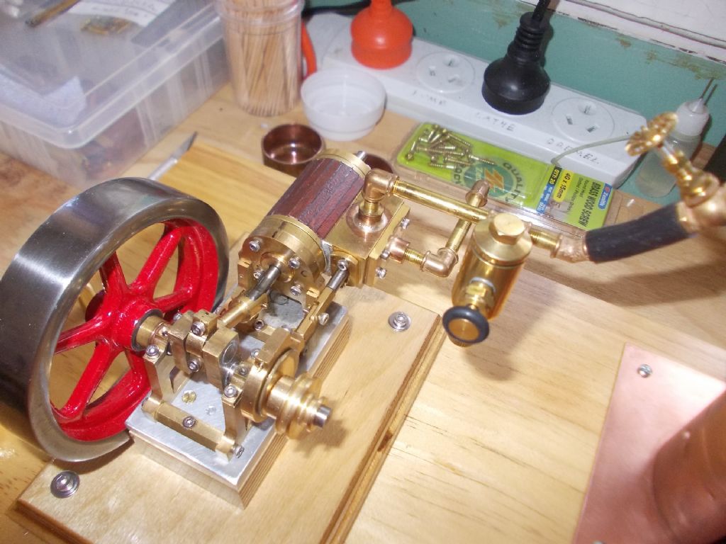

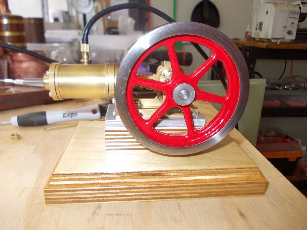

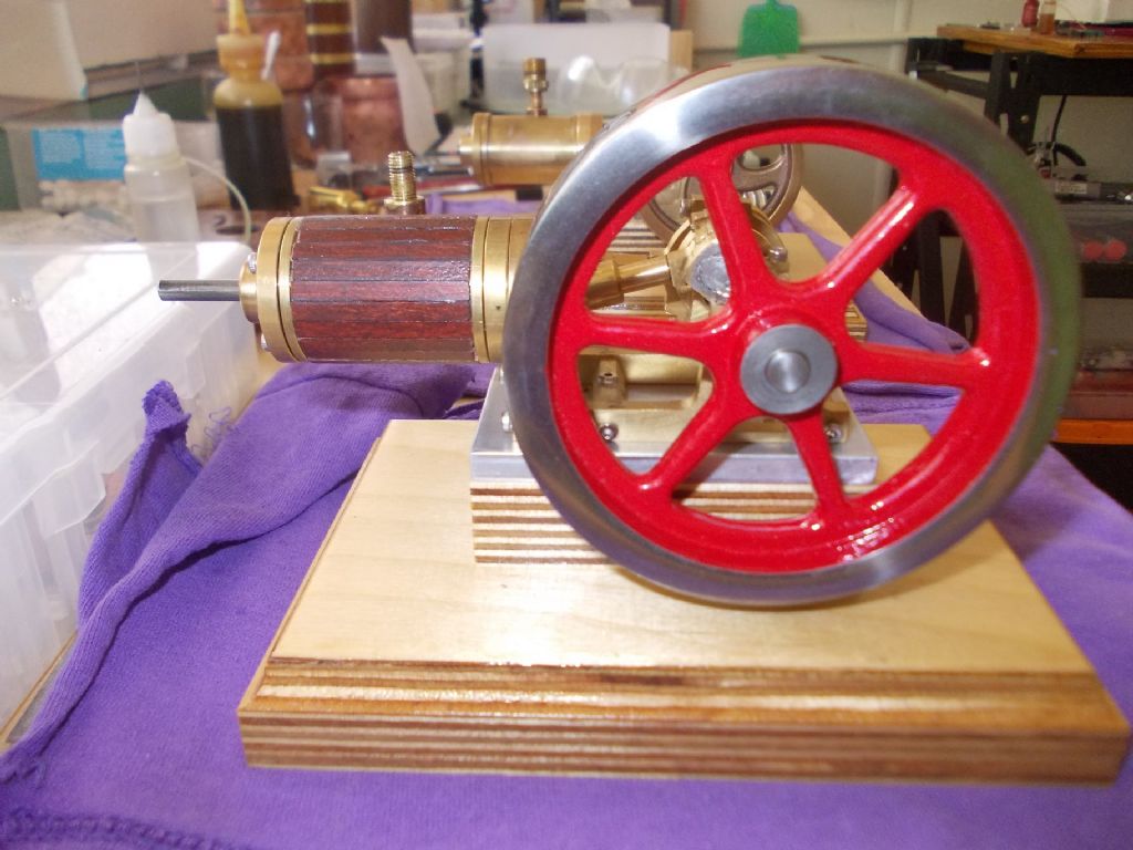

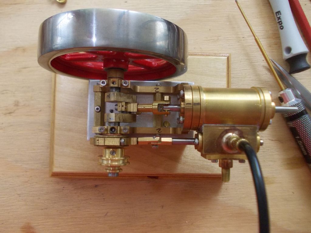

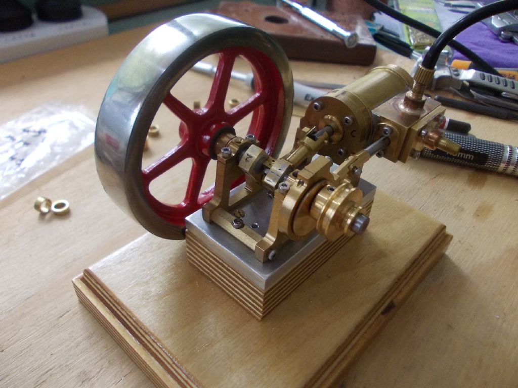

                  That is one engine finished. It looks quite elegant with the timber lagging on the cylinder. I don't have any more of the thin strips of timber to do the second engine the same way so I will have to think of something else. I also have to add displacement lubricators to the engines before running them on steam.
                   The second engine is giving me problems : the solder joint between the cylinder and the steam chest keeps ending up with two or three pin holes along the seam. It looks like air is blowing out of there while the solder is setting. I pulled it apart and re-soldered it a second time but I am still having the same problem. I am not sure what is going on there as this did not happen to the first engine. I would take a photo but I do not think it would show up very well with my camera.

                    Brian, My unreserved congratulations. The engine looks fanstastic. I have every confidence that you will resolve the other engine's pin hole leaking problems. Some time, some day, I might similarly be able to report on the success of my engine projects, but don't hold your breath. Regards, Lawrie.
                    #314803
                      Brian you have not plugged up any of the other holes have you? That can trap air that will expand and bubble out when heated. Excess flux boiling off can also give similar bubbles.
                      Looks good, ice lolly sticks and wooden coffee sterers can be used for lagging.
                      Whats the next project?
                      #314805
                      Brian John
                        @brianjohn93961
                        The only holes I plugged were those holes from the steam chest to the cylinder as I did not want them to fill with solder. I used cut off toothpicks to do that. It was not a problem with the other engine but perhaps they were a tighter fit in this one.
                        UPDATE : I have watched closely to see if any air is coming from those holes and I do not think there is. I placed a few drops of water with a bit of detergent and I could not see any disturbance or bubbles. I think my air compressor has died this afternoon so I am not sure if I have an engine problem or not !
                        I will make the Al plate to go under the engine frame while I wait for a new compresssor to arrive from ebay.
                        Next project is a beam engine from Sussex Steam which I purchased from ebay. It is their old model beam engine and there is a lot more work in it than I expected. I suspect that is why the original owner sold it. Their newer version is much simpler to build but unavailable now due to illness according to their website.

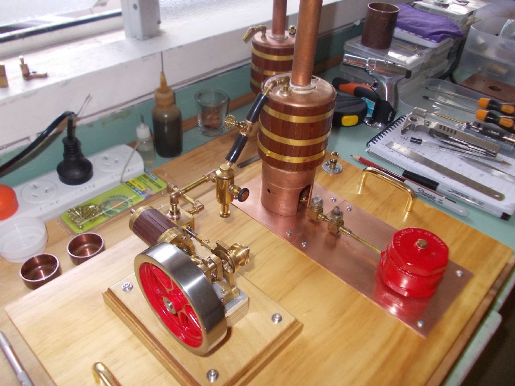

                              I am building a steam plant for both these engines. Danni #1 is done but I am losing quite a bit of steam through the pipe work so it keeps running out of puff after a few minutes. I will solder some of those connections and see if that improves things. I am hoping to fit a dynamo and light also but only if I can get the engine running fast enough.

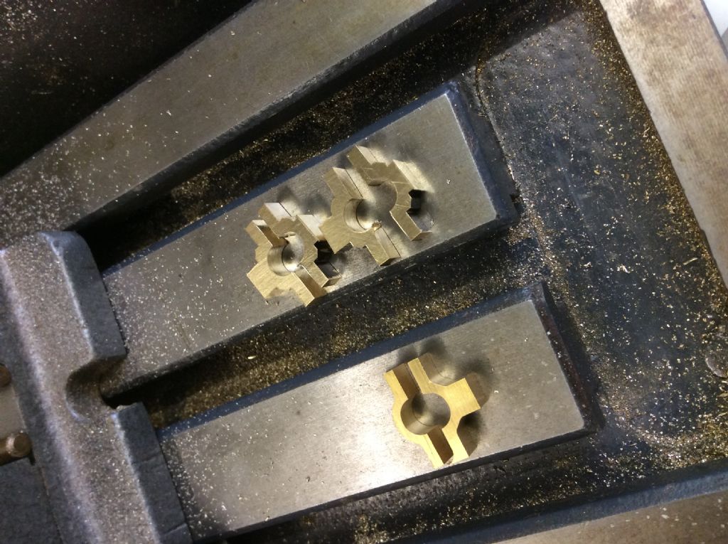

                                I made a bit of progress today on the big end bearings for the twin cylinder version.
                                img_2680.jpgimg_2676.jpgHi Brian,the steam plant is looking great.
                                The parts on the left are from the Bengs 'Danni' kit. It wasn't possible to replicate the radius on the scratch-made bits for the twin cylinder, so I settled for an approximate profile.
                                The opposing faces will need sanding down (on plate glass) to get the (now slightly oval) holes round and 5.8 mm diameter, then to be reamed to 6.00 mm. Drilling and tapping the M2 holes for the screws that hold them together is going to be a bit fiddly, but I've already done similar for the main bearings, so hopefully it'll be okay.

                                  Lawrie : How will you connect the two engines ie. from where to where on the steam chests will you make the connection with a steam pipe ?
                                  Danni #1 does not run all that well with the vertical boiler. I am surprised as it runs quite readily on air. The engine runs much better with the horizontal boiler which produces more steam. I am modifying the steam plant to take the larger horizontal boiler.
                                  I have put the timber lagging on Danni #2 and it should be ready for steam testing tomorrow.
