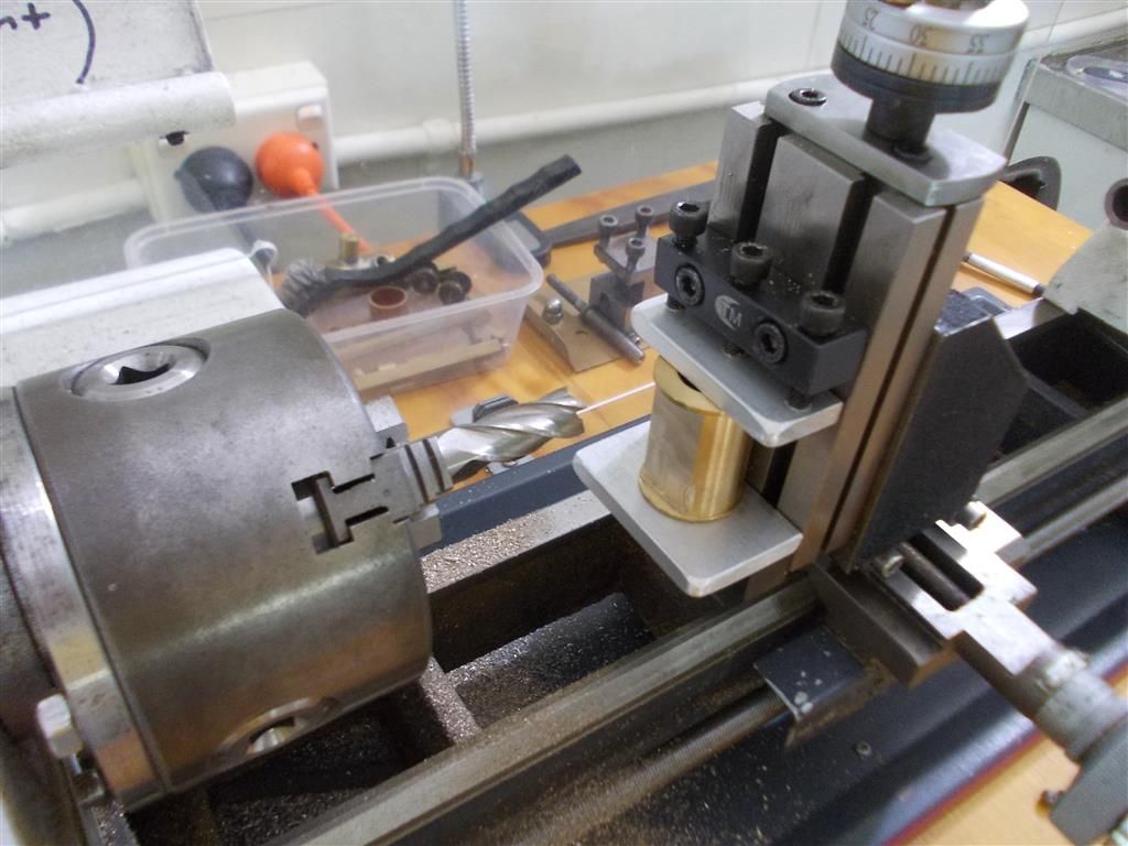

        I found some small aluminium strips today at Norweld but they have still not solved the problem of the top coming slightly away from the milling vice.
        I have to make the flat 4mm from the edge of the cylinder. How do I measure that without removing the work piece from the vice ? I cannot get my digital vernier in there and I am trying to avoid removing the cylinder all the time.
        I am advancing the carriage by 0.25mm at a time, How much of the 12mm cutting bit should I be using when taking a cut : 1/8, 1/4, 1/2 ….the whole thing ? Using the whole bit tends to cause it to dig in as you can see from the photo.
        This is my practise cylinder so I can afford to experiment a little on this one. I still have two more cylinders to mill after this ( I am building two engines at once).

          As I said tap the cylinder back against the slide as you tighten up the clamping screws.
          Make a not of the handwheel setting when the cutter first contacts the work and then it will be easy to feed it in a toatl of 4mm (16 cuts @ 0.25mm)
          For the roughing cuts go about 2/3 the cutter width so 8mm again as I said earlier start with light cuts and see how it goes, if you are getting dig ins then reduce the cut.

                        So I have modified that top piece of aluminium so there is no overhang obscuring my vision (photo1) and I finished milling the first cylinder (photo 2). You can see where I had a bit of a dig in but when the steam chest is fitted this will not be visible as it will be underneath. It should not affect the operation of the engine. Hopefully my next two cylinders will turn out even better than this. Definitely only 0.25mm cuts on my machine !
                        The cylinder still has to be drilled at tapped at each end for the cylinder covers then two holes drilled in the milled flat surface. I will then have to smooth out the inside of the cylinder after the drill bit has gone through and remove the ragged edges from the holes. I should have left polishing the inside of the cylinder until last !

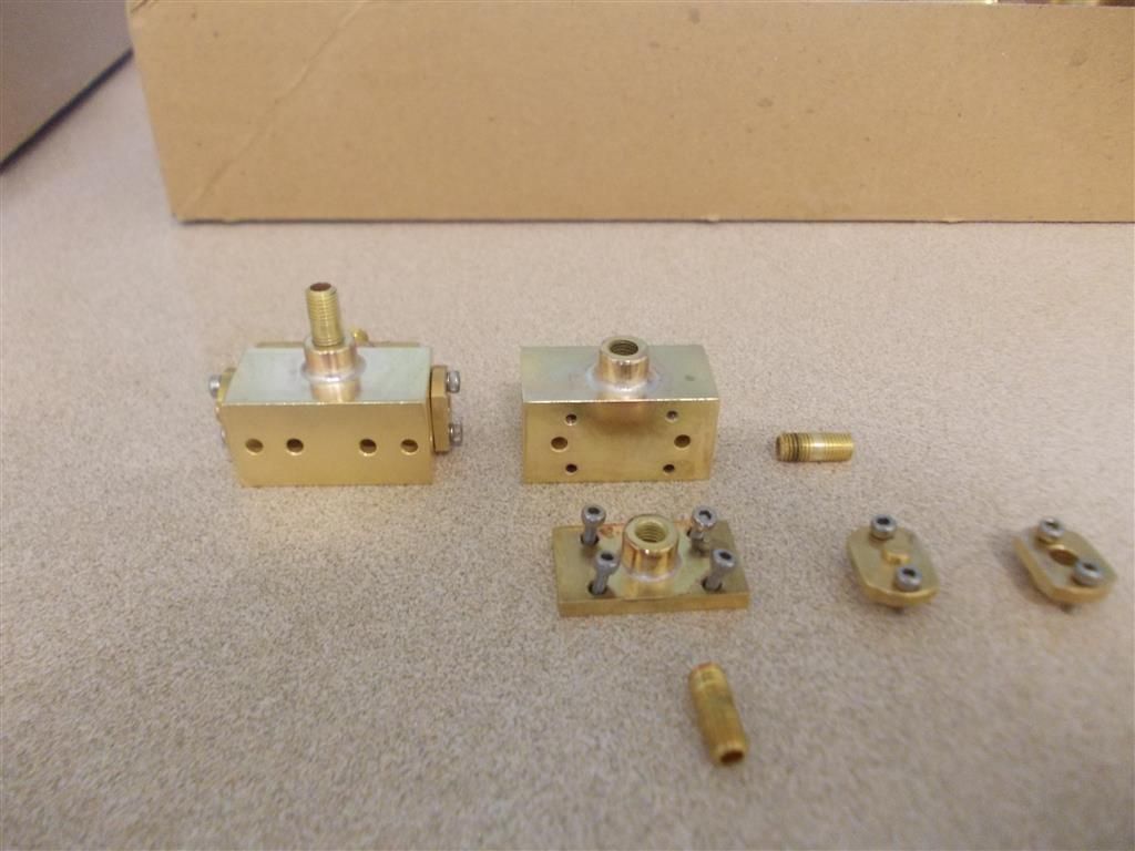

                                  I knew there was something else : there are two 2.5mm holes on the cylinder flat which mate up with two holes on the steam chest (24mm apart). I would think that these holes should not get blocked when soldering the two pieces together. The instructions mention nothing about this. What could be placed in the holes to be removed later in order to avoid these holes being clogged with solder : timber, aluminium wire, stainless steel wire ?
                                  #310094
                                  Ian S C
                                    @iansc
                                    You could probable stick a match stick in the hole, it would also help to locate things while you solder as things can skid around a bit on molten solder.

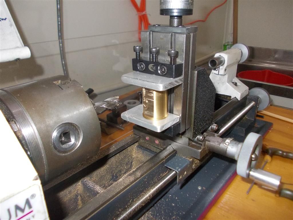

                                      I finished the second cylinder today. Should the milled surface be touched up with a file or just leave it as is ?
                                      I found that by drilling three 5mm X 2mm deep holes in the aluminium top plate that the screws on the mill slide could be more firmly located. This stops the cylinder pulling away from the vice. The two washers when held side by side measure 3.8mm so that gives me an idea when I am close to the required 4.0mm. There is no need to remove the work piece to measure it.

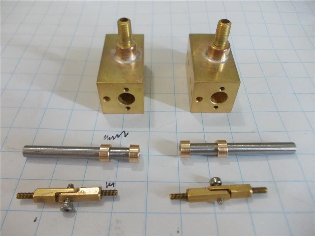

                                                  I have been thinking about the soldering of the steam chest to the cylinder while I complete the milling of the cylinders. The solder must fill the two inner holes on the side of the steam chest (the two outer holes will be plugged with timber or stainless steel to keep them open). The solder must also fill the two holes at each end of the steam chest. It all seems a bit ''iffy'' hoping that the solder is going to find its way into all the holes and do the job. Is there some way that the holes could be plugged PRIOR to soldering the steam chest to the cylinder ?
                                                  Edited By Brian John on 05/08/2017 09:47:04
                                                  #310461
                                                    The solder does not need to fill any of the holes.
                                                    You are basically sticking a flat (cylinder) surface to the area around the hole which will seal it just like if you put a bit of sticky tape over the hole.
                                                    Infact when you tin the surfaces you could keep the solder a couple of mm away from the holes which would help with reducing the risk of them filing with solder.

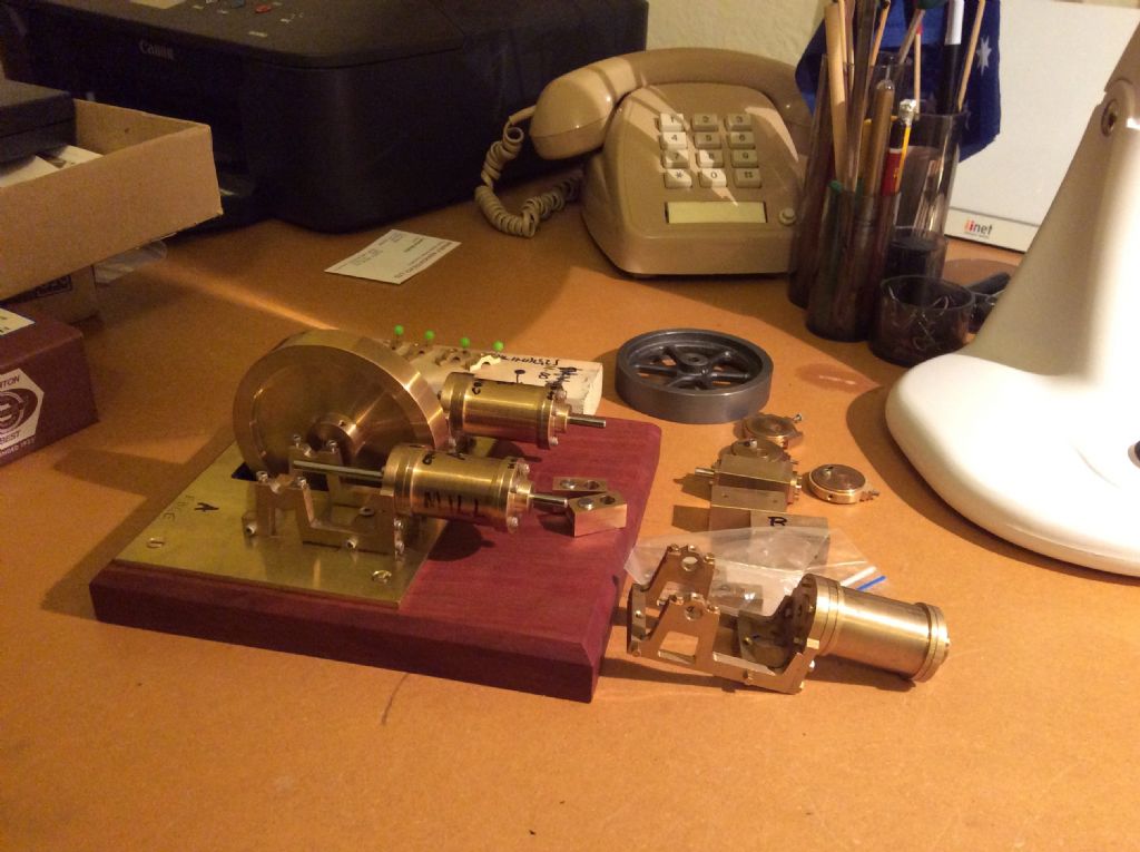

                                                      I thought people might be interested in photos of the bits for the single and twin cylinder versions of the engine, I have made so far. I had a bit of trouble getting the photos up, so I hope it works.img_2546.jpg
