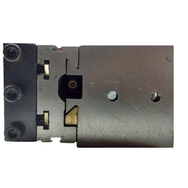

          #260418
            Posted by Brian John on 30/09/2016 10:32:43:
            Brian,
            What I have in mind for items 22 and 23 … just make an extended plate to fit the toolpost, drilled to suit the component.
            If everything is reasonably accurate, so far; use two 2mm pins for location and a bolt through the middle … cut one side, then rotate 180° to cut the other side at the same setting.
            Edited By Michael Gilligan on 11/10/2016 12:18:04

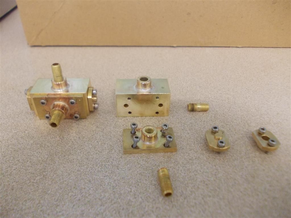

            #260972
            Brian John
              @brianjohn93961
              Michael : yes, I see now. I will try that next time.
              The two steam chests are now complete. The instructions were right and the steam chest is quite a complex piece of work with lots of M2 blind holes and steam holes that have to be drilled to the correct depth. I had intended to drill and tap the steam inlet pipe for 3/16-40 but the hole is too shallow for those taps so I ended up going with my original idea of silver soldering a bushing into the steam chest. The bush is threaded 3/16-40 so that I can fit a displacement lubricator later. (At this stage I am not sure how the lubricator will fit neatly with everything else.)
              I will make the control valve next. Now that I have completed the steam chest, I must get the valve to match the bore of the steam chest.
              UPDATES : the vertical mill slide from China will not be here until next year…maybe January ! In the mean time I am still waiting for the fly cutter which seems to have gone missing in action.

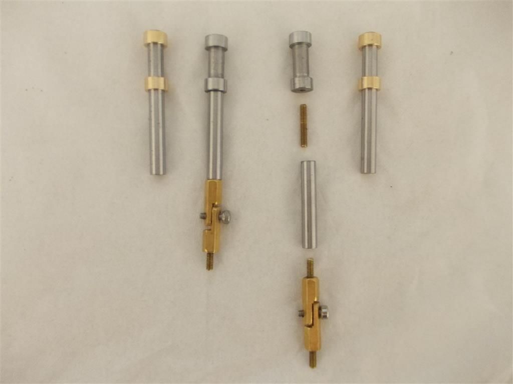

              #261340
              Brian John
                @brianjohn93961
                I have started making the control valves : I made the main shafts from 4mm silver steel checking for fit with the steam chest covers. I drilled and tapped the ends of the shafts so that the joint parts (20) will screw in. I only needed 5mm of thread but I drilled the hole down to 10mm so that it was more like a through hole than a blind hole… less chance of a broken tap. I used plenty of tap magic and I drilled out to 1.7mm rather then the 1.6mm I would use for brass. It all went well with no problems.
                The 6mm diameter parts I made from gunmetal bronze turned down so that it fitted the steam chest and then centre bored to 4H7 so that the silver steel shaft will fit through it. It was a fiddly job turning them down to 3mm wide after parting off !
                How should the 6mm parts be fixed to the shaft ? I was thinking of using some sort of Loctite product but I am not sure if it would hold. I could also soft solder it and I think that might be the better option. I also considered pinning it somehow but I am not confident of drilling holes in the shafts.
                Edited By Brian John on 16/10/2016 08:14:38
                Edited By Brian John on 16/10/2016 08:16:37
                #261651
                Brian John
                  @brianjohn93961
                  I was not totally happy with my idea for the control valve so in case the retaining compound does not hold I have come up with a plan B. The control valve has been made in two parts using 6mm silver steel and 4mm silver steel joined together with M2 threaded brass rod which will be held in place with Loctite 222 (low strength). The only turning I had to do was reducing part of the 6mm shaft down to 4mm. I used the flat edged parting tool for this, taking small 0.05mm cuts while passing it back and forwards between the 6mm sections.
                  Drilling and tapping took longer than expected due to rubbish drill bits breaking ! I hade to remake the parts a few times. I bought some good quality 1/6'' (1.59mm) drill bits today from NQ fasteners here in Cairns. They only had two in stock but it was enough to get me out of trouble. I will join everything together tomorrow. I have screwed one together on the photo and left one in parts so you can see how it fits together. I think somebody suggested this idea earlier…many thanks.
                  UPDATE : the fly cutter has gone missing and nobody knows where it is at this stage. It left Melbourne 16 days ago. I am starting to think about making some sort of jig and filing the cylinder flat by hand.
                  Edited By Brian John on 18/10/2016 08:10:49
                  Edited By Brian John on 18/10/2016 08:14:13
                  #261657
                  roy entwistle
                    @royentwistle24699
                    Brian I don't want to discourage you but silver steel will rust if you run on steam. Should be stainless
                    Roy
                    #261659
                    Brian John
                      @brianjohn93961
                      But it will be oiled by the displacement lubricator so wouldn't that prevent it rusting ?
                      There is no way I am going to try drilling and tapping stainless steel…I had a devil of a time with the silver steel…or turning it in the lathe either !
                      Perhaps I should have made the whole thing out of gunmetal bronze which was my original plan.
                      Edited By Brian John on 18/10/2016 09:46:29

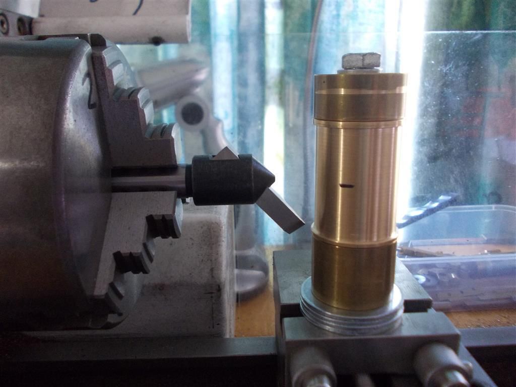

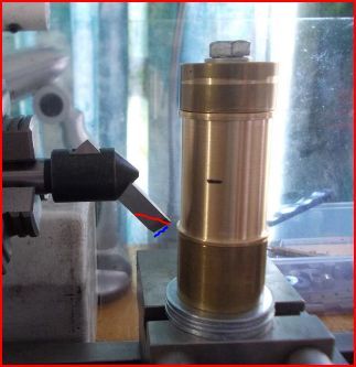

                                #262141
                                Brian John
                                  @brianjohn93961
                                  The fly cutter has arrived after going missing in transit for two weeks ; nobody knows what happened to it.
                                  Does this look even half right ? I have set the middle of the cylinder (marked with a black line) at the height of the tip of the fly cutter cone. Then I have adjusted the cutting tool so that it sweeps right to the edge of where I need the flat. This is my practise cylinder. I have drilled and tapped two other cylinders but I will not be using them until I get some idea of how this works.
                                  Edited By Brian John on 21/10/2016 07:24:39
                                  #262143
                                    You need to do a bit of grinding on that cutting tool otherwise the edge marked in blue will catch the work and also not produce a square corner. Grind it where shown in red. If you look back at the one I posted a photo of you can see the shape.

                                          #303631
                                          Brian John
                                            @brianjohn93961
                                            The vertical mill slide for the Optimum lathe is back in stock at machinery house. What diameter end mill bit would be suitable for machining the side of this cylinder ? I was thinking of the 6mm bit. I have not done any milling at all so I do not have a clue.
                                            **LINK**
                                            **LINK**
                                            Edited By Brian John on 22/06/2017 10:10:48

                                                  #303643
                                                    Hello Stranger!
                                                    As Michael says it could be done with the flycutter that you already have if it is ground like I showed on 21/10/16 to miss the flanges.
                                                    If you do go with a milling cutter in 6mm there are two things to check.
                                                    1. do you have sufficient movement to cover the whole surface in one setting, you will need to be able to move 24mm (30-cutter dia) a bigger cutter or the flycutter will cover a wider area so you won't need to move the work as much.
                                                    2. 6mm cutters are often quite short so make sure nothing will hit.
                                                    Both are easily checked by holding a bit of 6mm bar and doing a run through.
                                                    Edited By JasonB on 22/06/2017 11:43:30
                                                    #303653
                                                    Brian John
                                                      @brianjohn93961
                                                      I doubt that I will get anywhere with the fly cutter ; I cannot get the shape correct.
