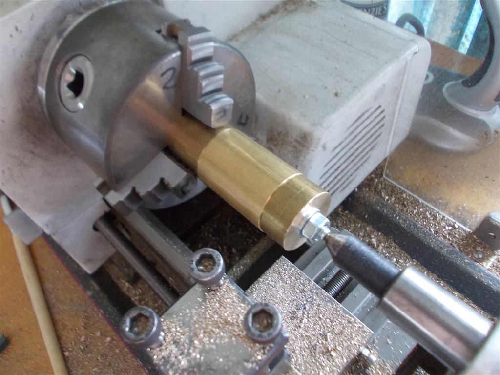

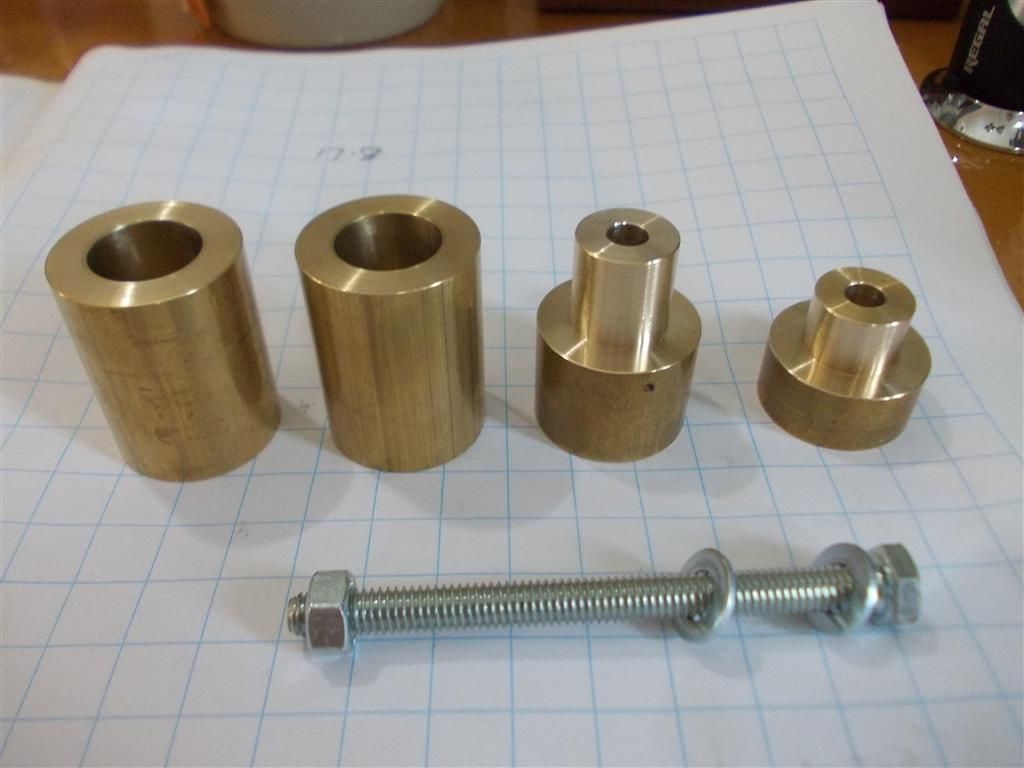

        I have made two jigs to support the cylinders while I turn the outer contour. I will do that tomorrow as I ran out of time today. What tool should be used to do this ? I used a centre drill to drill a small hole in the end of the M6X75mm set screw so that it can be supported between centres.
        I still have not decided how to make the flat on the cylinder : I am considering all options. I do not think the 4 jaw chuck would be successful. Like it or not, I may have to wait for the vertical milling slides to arrive in Australia in December. The other way is to remove the top slide then bolt the cylinder to the tool post and use a fly cutter in the lathe chuck.

                    I used the parting tool from the Arc Euro cutting tool set to do it : this parting tool is too thick to use as a parting tool on my lathe but it worked perfectly for this. I put some back rake on it with the bench grinder. I was able to take a 0.1mm cut then just move it down the length of the cylinder until I got to the other end. I did this ten times at that was it.
                    I have ordered a 14.5mm  fly cutter to cut the flat…I may as well give it a go.

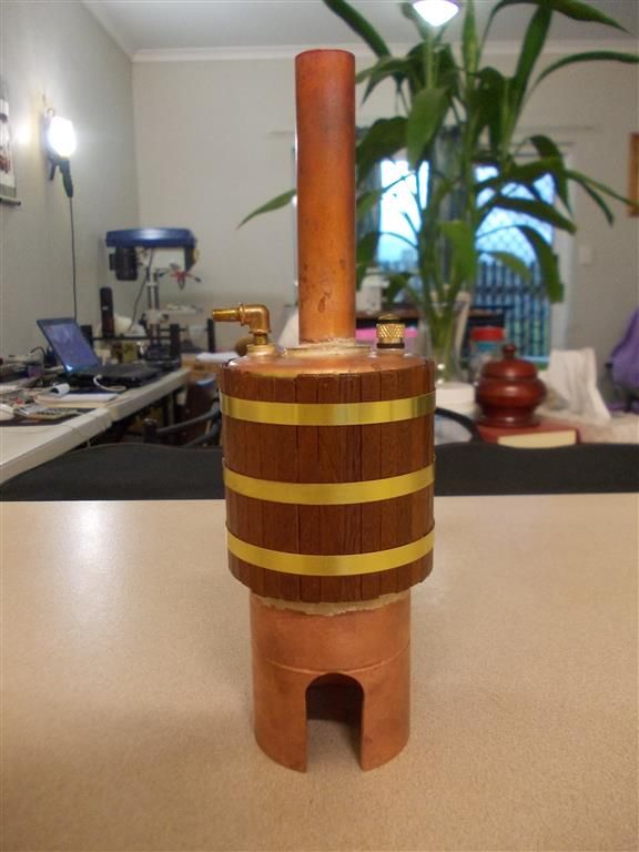

                                    We had a power failure in this area this afternoon so I was without a lathe for most of the day. I finished putting the mahogany timber lagging and the boiler bands on the boiler instead. There is no real need to do this but it does look much better and makes it a easier to pick up when it is hot….it looks quite smart too !

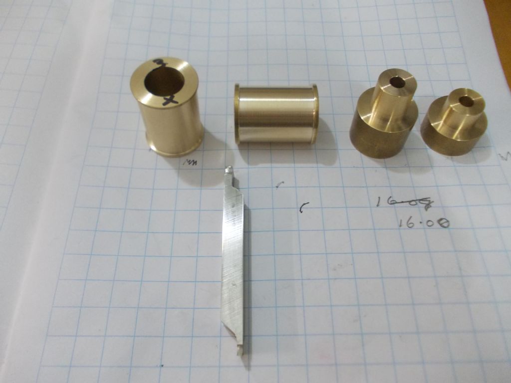

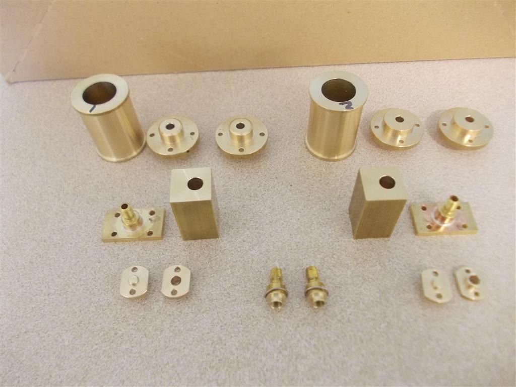

                                                I am still waiting for the fly cutter to arrive so I have not cut the flat on the cylinder yet. I have made four cylinder covers but I have not yet drilled and tapped the cylinders. I will wait and see if I stuff things up with the fly cutter…I am not very confident about it !
                                                I made the steam covers today (parts 22 and 23 – front row of photo) : very fiddly little things. Grinding the flats on each side was a real pain. I used a stone in the Dremel tool ; you only get about 20 seconds of grinding before the brass part gets too hot to hold. I tried using thick riggers gloves for my hands but the part was too small to get a good grip. How would you have done this ?
                                                I have also made  threaded bushings (3/16-40) for the steam chest covers (part 18 – middle row) and silver soldered these in place. The instructions say to soft solder it  but this will make things easier after the steam chest has been soft soldered to the cylinder with solder paste. I have also made threaded bushings (middle of the front row) to be silver soldered to the top of the steam chest although the hole there is 7mm deep so I may be able to drill and tap for a 3/16-40 pipe nipple…I am still thinking about that.
                                                Tomorrow I will finish the steam chests. I have only drilled and reamed the 6H7 holes so that I could make the steam covers.

                                                  Brian Do not grind brass It clogs the wheels

                                                    @iansc
                                                    Use a nice new file on brass, and keep the file for brass only, use older files for steel.

                                                      Then how are those ''edges'' to be removed ? I was going to use a slitting saw but the items are far too small and cannot be held in the tool post.
                                                      NOTE : Dremel stone wheels are cheap and can be discarded once clogged.
                                                      Ian : we posted at the same time ! You mean hold it in one hand while filing with the other ?
