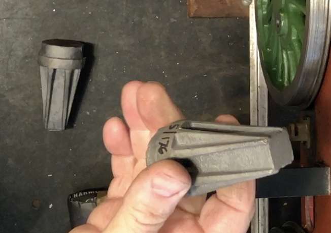

      I am working on a part built Clarkson’s D49. I just recieved valve guide castings from Blackgates and I am a bit stumped on the best way of machining these. There is a lot of metal to be removed and if I understand correctly quite a lot of undercuts. The drawings for the D49 are no help at all!
      I am wondering if these have been described in the “words and music” for any other Gresley locomotive? Any idea where to find something?

            So I am still looking for ideas on where to start. I have considerd trying to band saw out the middle or alternatively drilling down the middle however I don’t know what kind of cutter I would need to make good running faces on the insides for the valve cross heads. I really could do with some advice on how to proceed!

              I think a jig might help. I might start by turning the mounting spigot, and perhaps tapping a temporary hole in that end so that I could fix it to a rectangular block with a matching recess bored in one face. This would allow you to re-position the job repeatably, so that you could rough out the slots all round before taking light finishing cuts.

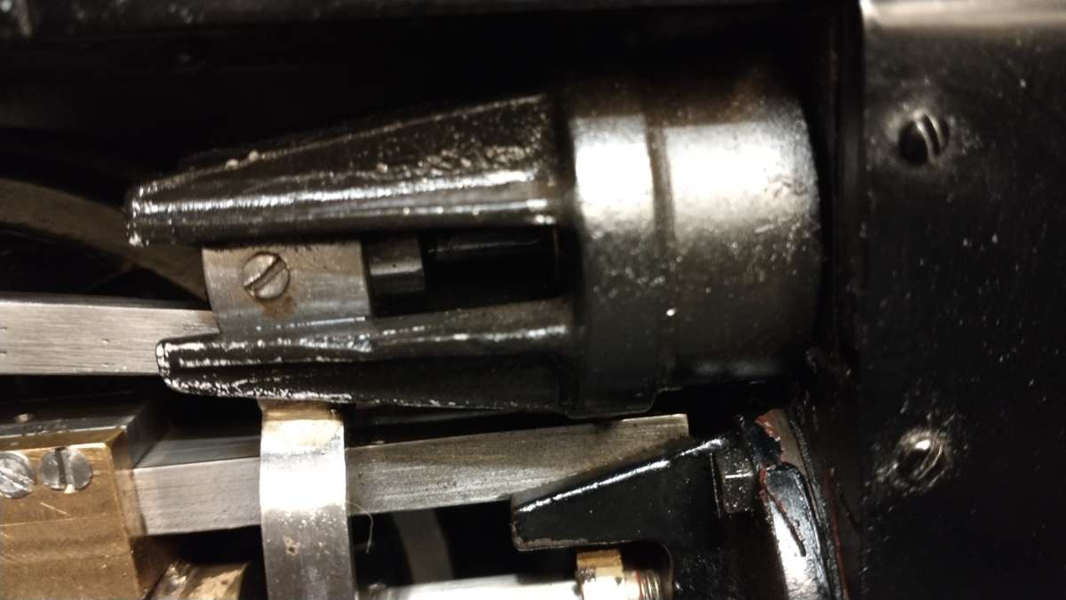

                    I have these on my LNER L1 (Clarkson’s!!!).. as they’re just for show and dont serve any actual purpose I bored them through on the lathe and then milled out the slots.
                    It’s secured onto the steam chest with a grub screw.

                      That is interesting. The previous constructer of my loco has set screws in to retain the end caps and guides as well as the valve sleeve. The drawings don’t show anything for the inside cylinder but suggest the valve crosshead engages with the guides on the outside cylinders.This might be necessary for the conjugating links.

                        I took a close up photo off my L1 last night for you.
