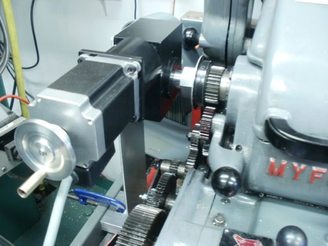

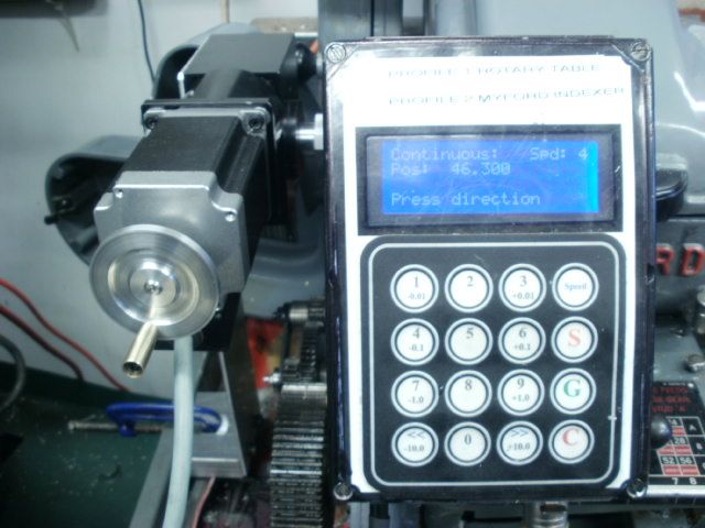

                                p2261369.jpgThis thread inspired me to build a stepper motor spindle indexer for my Myford ML7RB lathe. The stepper motor is geared down via a 30:1 worm/gear removed from a skipped motor. I built the stepper motor controller some time ago from the information found here:-**LINK** and use it on my adapted rotary table,

                                  Nice job Ian.
                                  Certainly cheaper than the Sherline table.
                                  Do you get any backlash ?
                                  Alan
                                  #181523
                                  ianj
                                    @ians
                                    Alan.
                                    There is a little back lash, but no more than on my rotary table. It's not a problem as long as if you overshoot you rotate in the opposite direction half a turn and then rotate back to the position originally required. There's something very satisfying building a usefull tool out off scrap ( recycled ) parts.
