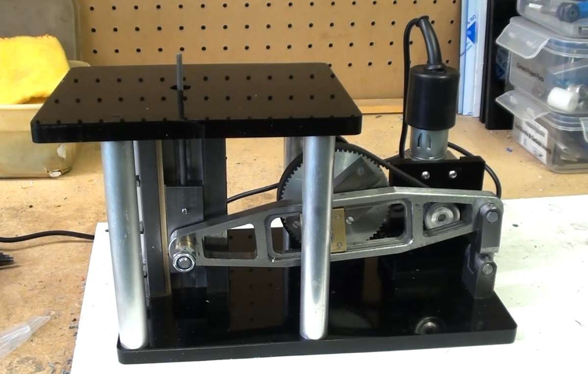

                      Some while ago, a question was posed on the “old” forum in a similar vein to your original request.  In that instance, the enquirer was asking for a different approach to the usual means of achieving the reciprocal motion of the file.
                      I gave the idea some thought and decided that it might be worth the mental gymnastics and CAD practice to adopt a “vertical shaper” design and came up with the following:
                      The finished article
                      Naturally, it attracted a number of detractors, not on here, but on YouTube.  It wasn’t meant to be a revolutionary device (pardon the pun), just an exercise to see if I could do it.  I admit that I haven’t used it much at all, though I will say that one of its attractions for me, is that the nature of the shaper-style beam action means that, depending on the direction of rotation of the motor, the down stroke can be the slow (cutting) stroke and the return (non-cutting) thus correspondingly quicker.  Additionally, the stroke itself can be altered.
                      To finally get to the point, the motor which I eventually used was a 12V, worm gear reduction Chinese one fed from a variable voltage power supply.  They currently cost around £12 each on that site.  The item desorption states that:
                      “Voltage: DC12V
                      Load torque: 10KG.CM
                      No-load speed choice : 0.6rpm/2rpm/3rpm/10rpm/25rpm/100rpm/120rpm
                      Suitable for: Widely used in windows, a door opener, miniature winch and other occasions.”
                      Assuming that the filer will only be used on thin, possibly non-ferrous material, I consider that it would be suitable for the job.
                      Make of that what you will.
