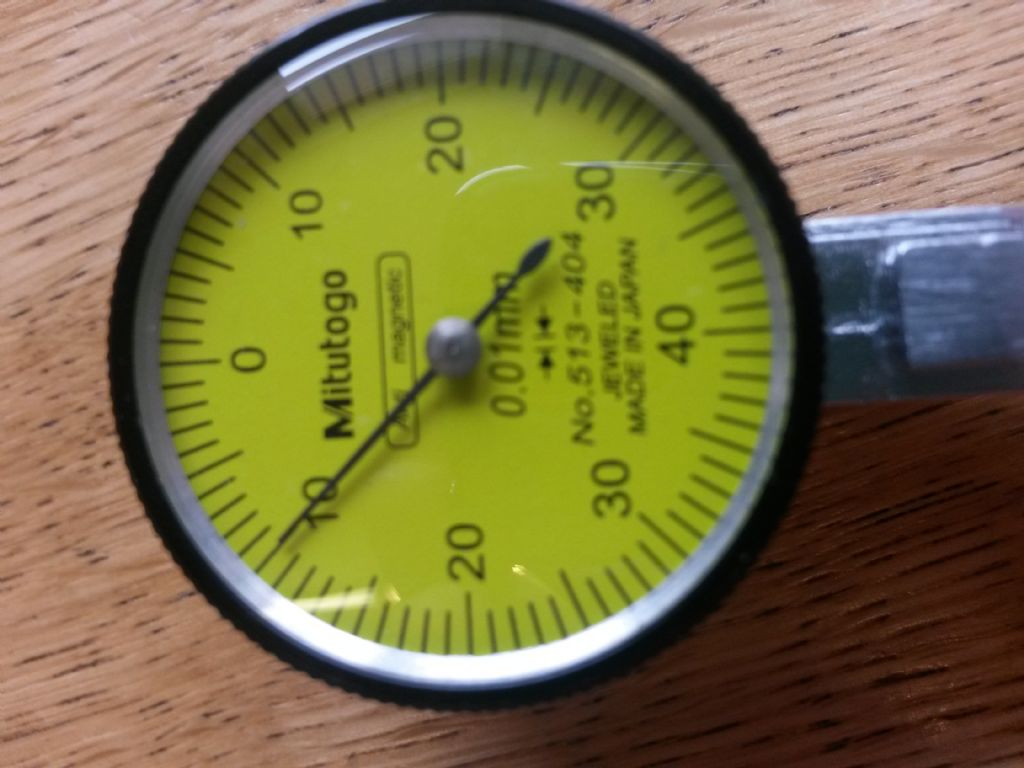

          Watch out for knock-off Mitutoyo dial test indicators too. Giveaway is point type bearing on the finger pivot instead of the Mitutoyo ball bearings. And different bezel.
          If they are too cheap to be true — they are!
          I lucked out and bought a cheapo generic Chinese indicator from Asia for about $25 and when it arrived it was all dressed up in Mitutoyo packaging with Mitutoyo written on the dial etc. But quality of the dovetails gave the game away immediately so I looked it up on the net and there is a Mitutoyo sheet on differences to look out for.
          So far the $20 knock off works just fine — but I would not have wanted to pay genuine Mitutoyo price for it!

                      jim’
                        @jim11037
                        20140607_120737[1].jpgi've got a Mitutogo DTI
                        Edited By jim’ on 30/09/2014 19:33:21
