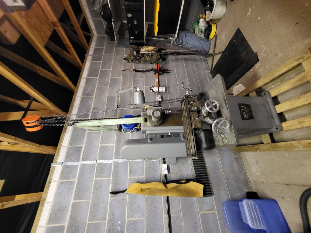

      Your thoughts on where to go from here. I'm concerned about damage to the lead screw as it is currently resting on the table. Still waiting for a full damage assessment. Had anyone had a similar case?

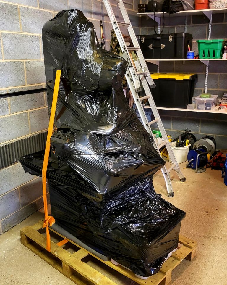

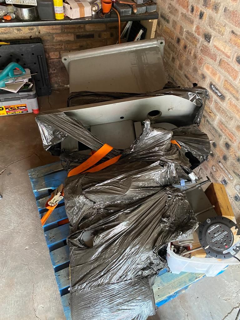

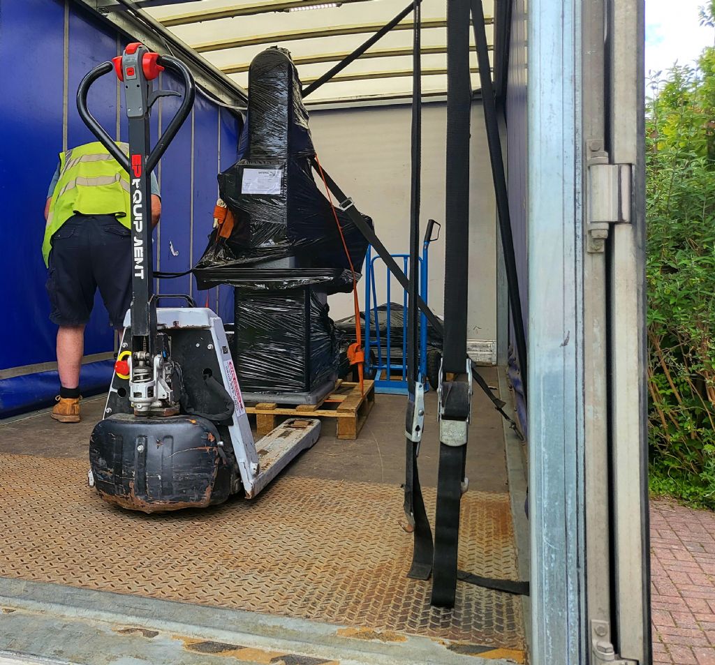

            The top picture is how it arrived, the bottom three are how it left. Needless to say I'm pretty upset by how the transport company has handled this – no communication prior to it arriving at its destination clearly having fallen. Note the box of tooling smashed and haphazardly repacked.

              You do not say whether you are the sender or receiver.
              In any case, the condition in which it left is deplorable. The pallet is too flimsy, the machine is not fixed to the pallet and a single orange strap (that has been knotted together) is in no way adequate to secure it. The sender is more to blame than the transport company. If I were the driver and was presented with that as a load, I would refuse it.
              #600548
              Hopper
                @hopper
                One strap like that is so not right.
                #600549
                Pete Rimmer
                  @peterimmer30576
                  Yep 100% wrong type of pallet that load was destined to fail (or fall). The edges of the base are mid-span on the slats and there's no bottom stringers so when the truck went round any bend the machine starts to lean and slats will bend then snap. If it has a sheet of ply on top, even 1/2" ply, it would probably have been ok. Using a blue pallet would have been even better. The ratchet strap is inadequate and it should have been around the slat the machine was sitting on not the outboard one which would pull out the nails.
                  The driver should have refused it as an unstable load.

                        Lucky it didn't fall through the soft side of the lorry and hit another vehicle.

                          Appears to be on a blue pallet on arrival. The original must have disintegrated in transit. Sad. Looks pretty traumatic.
                          Who did the packing job, the seller or the transport company?

                              Should have used the double Euro pallet in the third photo and laid it down. The first driver knows it's top heavy, and lashes accordingly but the warehouse in the middle does not, which is where it all went wrong.

                                        Separately, some effort seems to have been made to support the machine in the van. Strange how delivery seems to involve a pallet differing from the original one

                                            The second and third images show the mill on the weak pallet perhaps in the vendors garage/home workshop (block walls).
                                            The fourth image shows the mill in the vehicle on the original weak pallet.
                                            The first image shows the debris on a more appropriate pallet presumably repackaged following collapse of the original pallet and now located in the recipients garage/home workshop (brick walls).
                                            Defective packaging by sender, carriers exclude damage caused by defective packaging which seems to be the likely cause.
