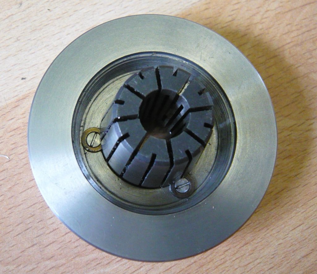

                      On my Stepperhead lathe the ER32 collet nut has two hardened discs positioned 120 degrees apart to act to remove the collet. I did it this way to avoid making the eccentric ring. This method has advantages in that it is easy to insert the collet and the hardened discs can be machined to a diameter and thickness to ensure they do not interfere with the concentricity of the installed collet.
                      Alan
                      Hardened discs for removal

                        Alan, nice simple solution. I hve made one chuck as part of a DIY fixture that works well but bought the nut..your method makes nut creation easy. whether it'll end up with better lead-in is another matter. I suppose i couls also fiddle with making a witness mark for thread start.
