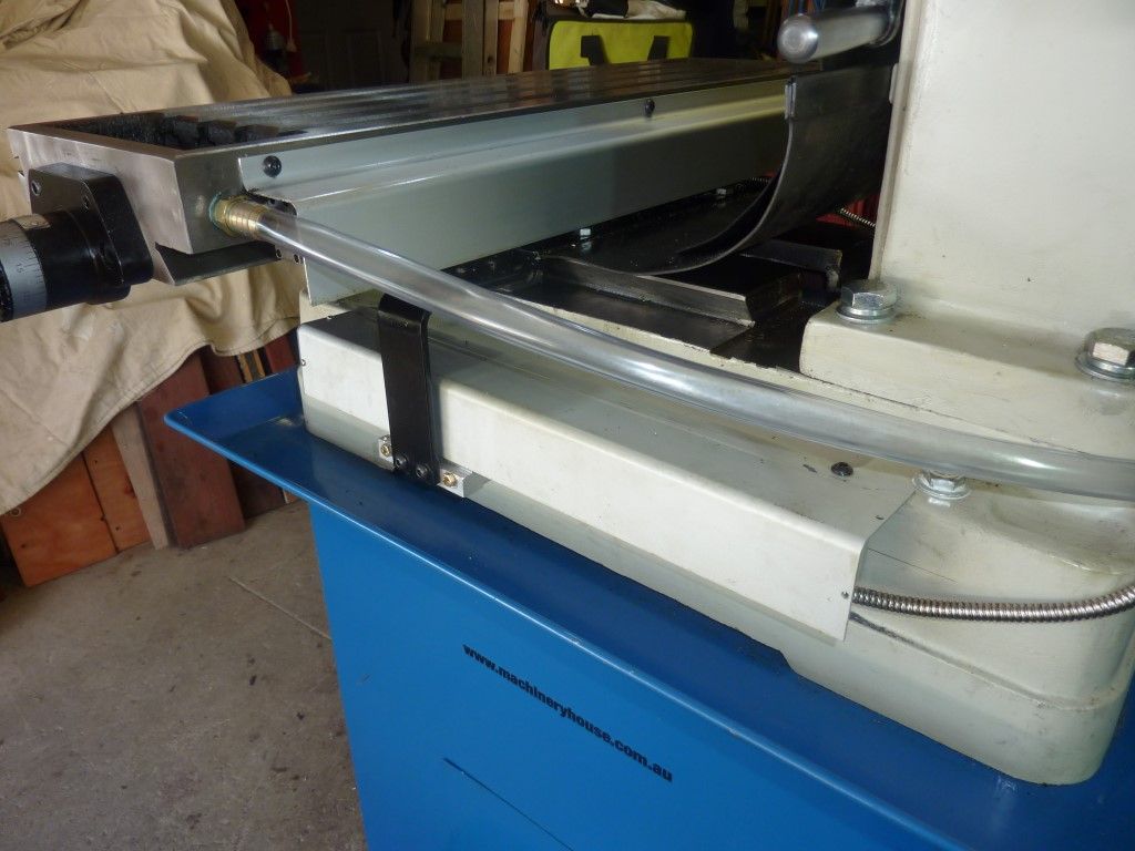

        I plan to mount a DRO on my Rong Fu 45 mill. I want the X scale on the back of the table. Doing so will block access to the ball oiler on the back if the table. The only solution I have come up with is to drill through the table so I can put a ball oiler on top of the table. It would have to be in a counterbore to keep it below the table surface. I will have to remove the table and do the drilling on another machine. I don't have enough Y travel on the RF to drill the hole for the oiler in the right spot.
        I do not want to mount the scale to the front of the table as it would interfere with the table stops and the clamp screws.
        I am looking an alternative to what I proposed. I hope the collective wisdom of this group will find me an alternative.

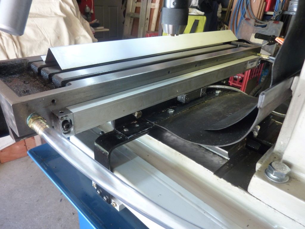

        Paul Lousick
          @paullousick59116
          I have a DRO on the back of my RF45 mill and it does cover the oiler hole but it is just as easy to lubricate the table slides by sqirting oil directly onto them when the table is estended to either side. (bracket for Y scale also used to re-attach rubber cover).
          Paul

            My scales have a protective cover that mounts above the scale. That is what interferes with the oiler. I guess I could just make a cutout for the oiler.

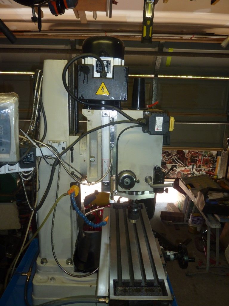

            Paul Lousick
              @paullousick59116
              I modified the protective covers which were supplied with the Easson scales. The oil hole on the rear of my table is about 10mm from the bottom and behind the scale, so not able to drill an access hole.
              Also added a scale to the Z axis.
              Paul.

                Thanks, Paul.
                It didn't look like things would fit. You proved they would. I would really appreciate any photos you could post of the Y and Z axis installations.

                          Sorry to hear about your arm. The oiler on my mill is at the bottom and coverred by the scale. Just as easy to apply oil directly to the slides wnen they are extended to either side. I did not have the luxury of a second mill to drill the mounting holes, just did them manually on the RS45 after removing the table. My scales have slotted mounting points, so accuracy for the bolts was not that critical.
                          My scale was mounted on the rear of the table because I did not want to clutter the front working area and wanted easy access to the table slide stops. I still get 180mm of Y-axis travel instead of the full 195 mm. I could get more if I removed the cover but have not needed to do so.
                          The table is easy to dis-assemble. Unscrew the keeper brackets on the end and remove the leadscrew. At first, I was unsure of the weight of the table and suspended the overhang from a temporary crane setup but found that I could lift it by hand to re-assemble.

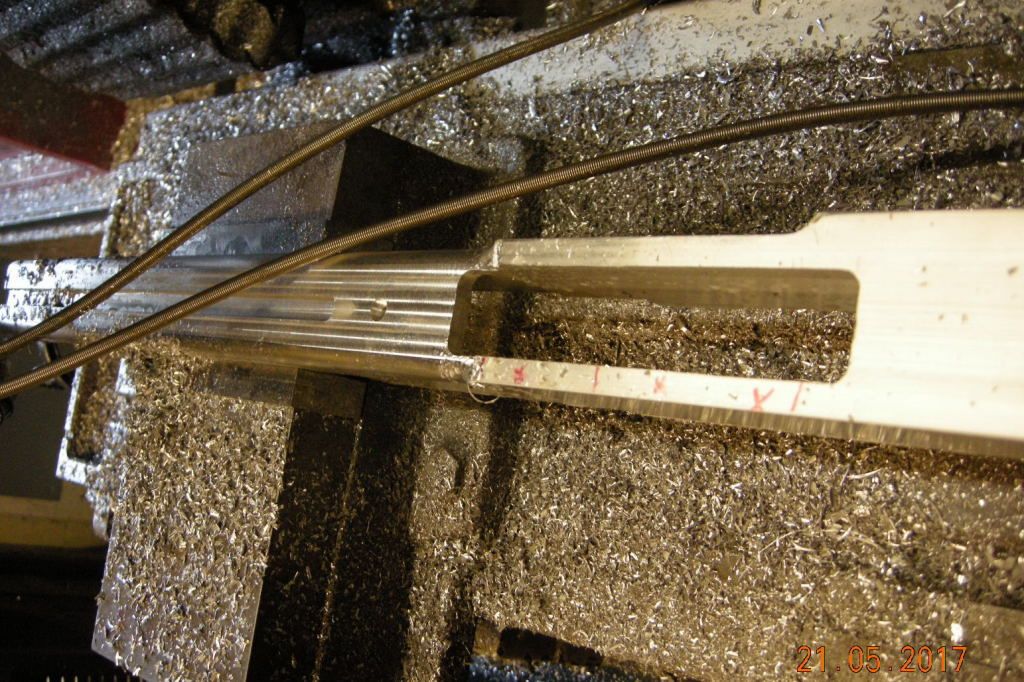

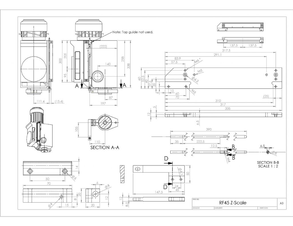

                            Sorry to partially hi-jack the thread, i have a Chester Lux RD 45 fitted with DRO to X & Y Axis. I have power feed and with the limit control fitted the x axis reader is positioned at the rear otherwise the stand off's would have been ridiculous. This may be helpful to know if you are contemplating power feed.
                            The point of my post I noticed Paul Lousick has fitted a Z Axis reader and I have been sketching, measuring and not reached a conclusion as to where to fit. From the images it looks as though Paul has come up with a neat solution. Paul have you any closer images that you could share please.

                                  I mounted my Z axis sale in pretty much the same way as Paul except for being on the other side. Scale bolted to the mill, reader head on an L shaped bracket fixed to the bottom thingie on the quill. Did a quick and dirty set-up using two pieces of "Speedframe" knock together square tube framing system with an L type flat corner bracket holding them together. Cost me an inch of Z travel which I didn't really miss enough to get round to doing the proper job. Just slapped the cover on and used it. Nowt so permanent as a temporary fix!
                                  Planned proper job would have had the bottom arm modified into a sort of U section where it bolted on so as to minimise lost travel. In retrospect it would have been better to fix the read head to the machine and have the scale moving.
                                  You can see a bit of the front mounting system for the scale too.

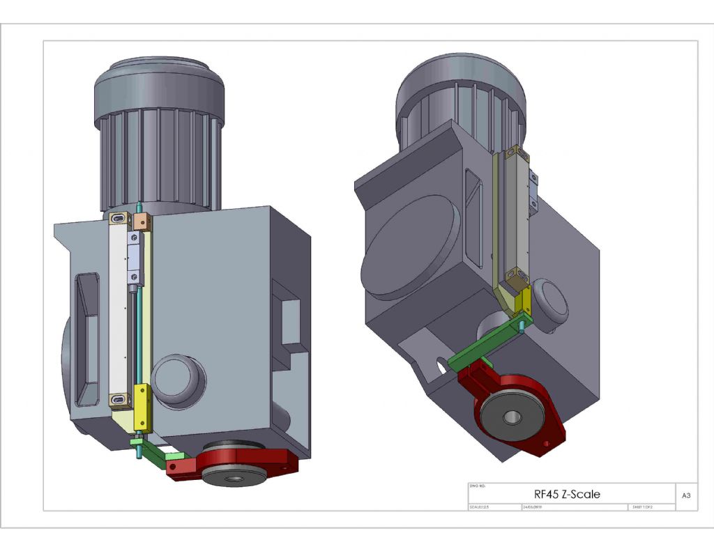

                                  Paul Lousick
                                    @paullousick59116
                                    Robert,
                                    You have caught me on a very generous day. This is the drawing which I made for the Z scale guide. Note the guide pin comes out of the top bush when the quill is lowerred and did not go back in smoothly when raised so I removed it. A longer pin could be used but the scale has been working for 2-3 years without any problems. Also in my roundtuit list is to make a modified version using a linear ball slide instead of the pin and bushes.
                                    Paul.

                                    Robert Butler
                                      @robertbutler92161
                                      Thank you Paul, Clive & John I am most grateful for your replies and particular thanks to Paul for the drawings I was only hoping for closer images. I had toyed with mounting the components on either side and front, fixed and moving read head and scales. Paul's solution seems ideal, mounted either side as the left hand side seems rather crowded but the mounting bracket/plate may overcome this. I intend to have a longer guide pin with linear bearing, available from Euro – Bearings for less than £20-00 (Jan 2019 prices – no connection etc.) with the scale fixed in place. The bearing will be mounted at the top of the gearbox and just provide some support to maintain alignment or as suggested by Paul a linear ball slide. Once again many thanks Robert Butler.

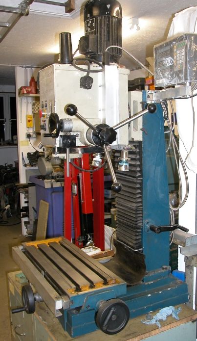

                                      John Hinkley
                                        @johnhinkley26699
                                        John (Reese),
                                        You don't HAVE to either lose Y-axis travel or access to the X-axis travel stops when mounting a DRO scale on the X-axis. When I was choosing where to mount mine, I came up with the solution below:
                                        x-axis scale 2
                                        As you can see, I mounted a slotted steel flat on stand-offs to move the travel stops outboard of the scale. (It also incorporates the limit switch actuators for the X-axis power drive as well, as it happens.) In use, I found that I was using the DRO to determine travel, and not using the travel stops and have since removed it. I don't miss it. Having said that, if I was carrying out repetitive cuts to the same dimensions, I might be tempted to put it back on, just for that job. It's easily mounted and removed.
                                        MY2P

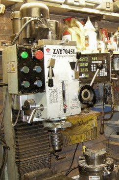

                                          Colin Heseltine
                                            @colinheseltine48622
                                            John H,
                                            Which model machine is yours. Is it one of the turret mills.
                                            Colin
                                            #401995
                                            John Hinkley
                                              @johnhinkley26699
                                              Colin,
                                              Yes. It's a Warco VMC. Fitted with Warco budget three-axis DRO, spindle digital readout and 3-phase motor with VFD and X-axis power feed.. Excellent bit of kit. Far exceeds my capabilities.

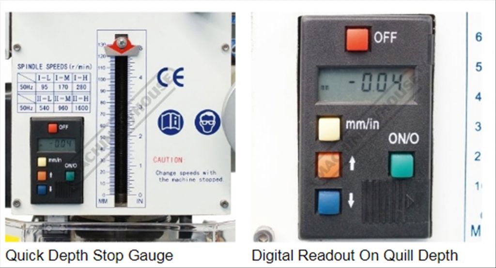

                                                      Our equipment supplier in Australia also sell a version of the mill fitted with digital readouts. On the quill they use a cheaper version, similar to that used on the Seig SX3 mill.
