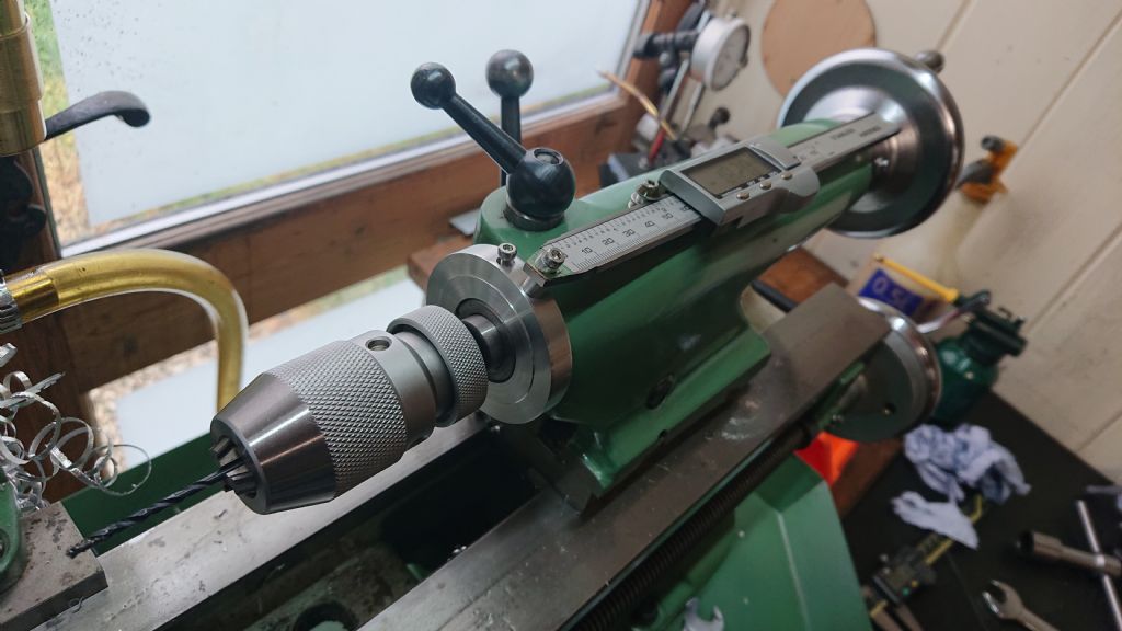

      Im thinking of buying the DRO set from Machine DRO for my super 7.
      Does anyone have any experiences with fitting this kit specific to the 7 ?
      I would be looking at the 'no drill' version as clearance at the back of my lathe is minimal. Ive had a quick shufty over Youtube and it looks quite straightforward.
      I did the tail stock yesterday doing the much used set of old calipers method. It works very well !
      Carl
      tailstock mod

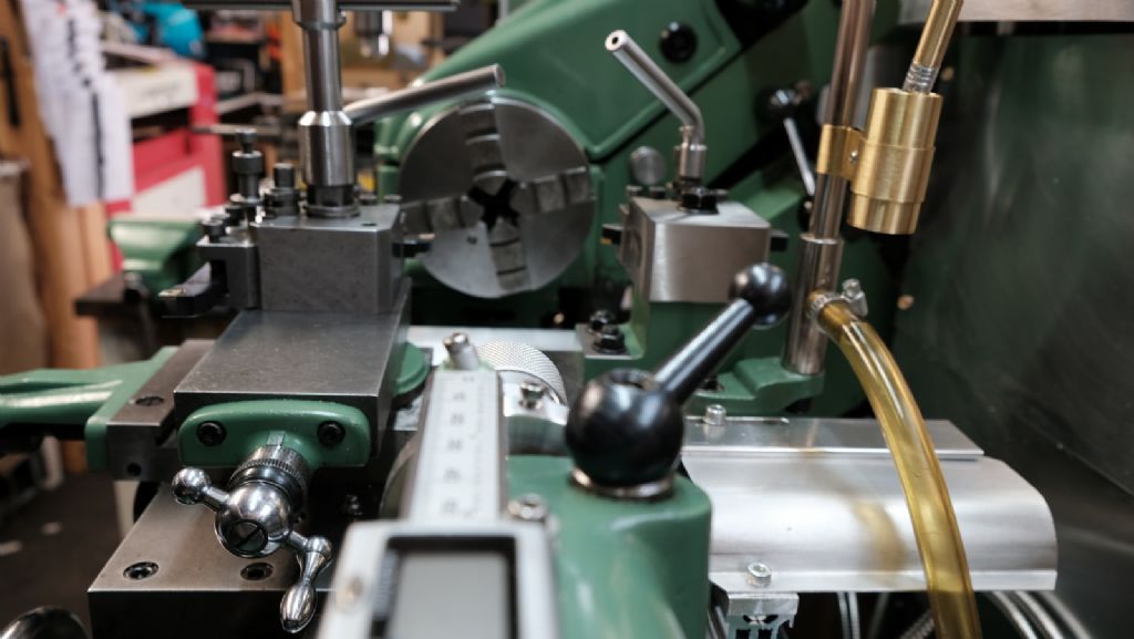

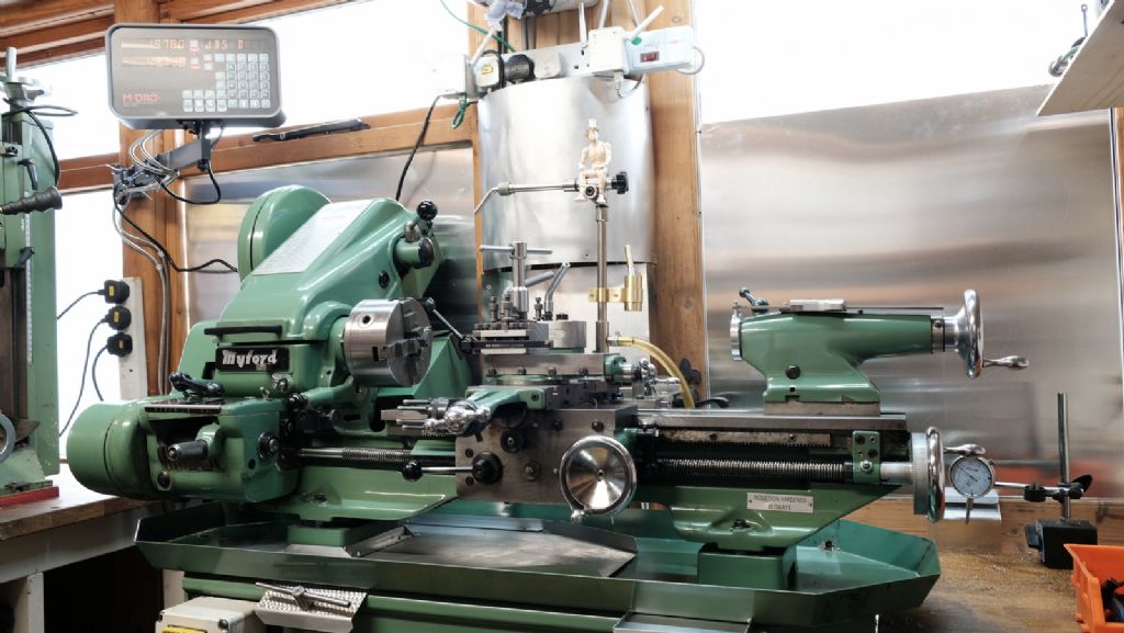

                    Die Hardenedbedway
                      @diehardenedbedway41166
                      So the DRO came and was installed without any problems.
                      The DRO when first turned on fluctuated wildly on the X until i realised it was the coolant stalk vibrating and transfering those vibrations to the reader. I had set the coolant on the DRO frame as it put it right out of the way. Once moved, bingo.
                      Only thing I added was a simple swarf shield to the X reader
                      So far so good
                      Carl
