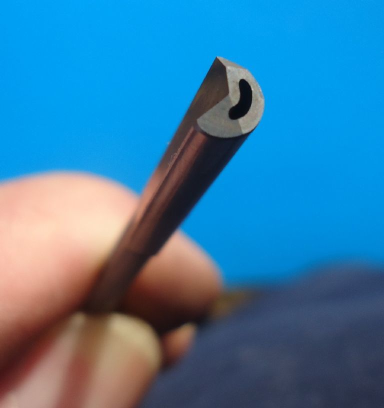

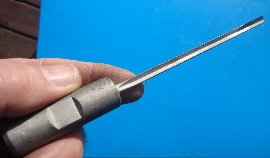

      I bought a large crate of tooling yesterday at the boot, mostly drills, reamers taps etc. about 15 kilos in all, some new and some hardly used from 2mm to 25mm dia. I was told that it was being disposed of at the end of a "one of" CNC product run. For the price of three pints of amber nectar I happily became the new owner.
      In amongst it all were five of these of different diameters – 2, 3, 4 and 5mm. I have never seen anything like this before and can only assume they are for extending the depth of an already drilled hole. The chap I bought them from mentioned engines and if my assumption is correct could these have been used for finishing oil ways to depth?
      As you can see from the pictures the last inch or so at the business end is made from carbide / like material. I am truly amazed at how ( especially the 2mm dia. one) how they managed to get that tiny curved thro' coolant hole machined down the 120mm long stem – spark erosion?

            They look like deep hole drills, the hole in the end for pumping the coolant into the hole to clear the swarf and cool the drilling, funnily enough I have just written a short piece on Archdale deep hole drilling rigs for another magazine, the company I worked for used to drill 2 – 3 mm holes into fuel injector bodies for about 4 inches.

              Rik, is it the photo or are they tapered? as the business end looks smaller

                Jason – It must be the photo – its the way I take 'em teeth 2
                No, the carbide business end is not tapered but it does stand proud of the rest of the stem by a few 'thou. All bar one are made by MOLLART the odd one out is by GUEHRING.

                    I am pretty sure they are known as, 'Gun Drills' for drilling deep holes in tough steel like crankshaft oilways and longer ones for actually drilling gun barrels. The coolant is force fed down the tube to flush out swarf so thatn it does not clog or mar the drill bore.

                      Well…the spiral flute through coolant drills I uses were made by in effect the lost wax process…the coolant holes were made from nylon ( I think nylon..might have been another plastic).rods .twisted in a jig..then drill material sintered around.then part of the final sintering process burns out the plastic…

                          I rather supect the coolant hole was formed into the final forged drill body using a blank having a filler wire in a drilled hole. Rolls Royce did very similar work in difficult turbine blade nimonic alloys where they called the process 'coining' with several small holes fitted with wires that could be acid etched out after forming the aerofoills to provide forced air cooling to the installed blades.
                          Keeping the correct wall thickness over the cooing passages in the finished aerofoil cross section was a special skill the forging deparment kept to themselves.
                          The outer shape of these drills is identical to that of gun drills where the drilled hole is burnished at the same time as being drilled , the head acts as a guide and with special machiinery depth to diameter ratios of 400:1 can be achieved.

                              We called them gun drills and used them to drill holes (dia 8mm) around 800-900 mm deep in 316 Stainless.
                              Not by hand but two holes/workpieces at a time. Re sharpening them was also done on a cutter grinder in house.
                              I can't remember what bar oil pressure we used but it was a bit silly, I do remember the machine took over 40 gallons of cutting oil which after a days drilling was rather warm!

                                Know them as 'gun drills' and will cut dead straight, dead size and highly polished. Must have coolant through the centre tube though.
                                The best peice of kit I have ever used. Officially they guarantee a 1mm wander for every 1 metre drilled, pretty good.
