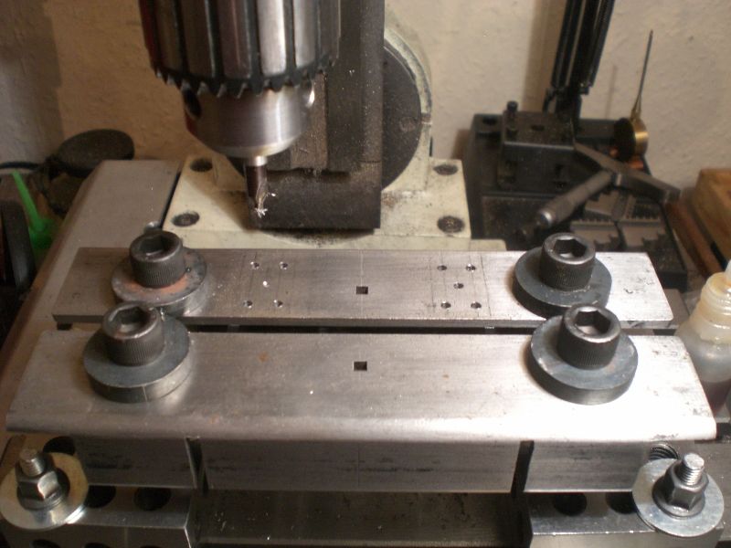

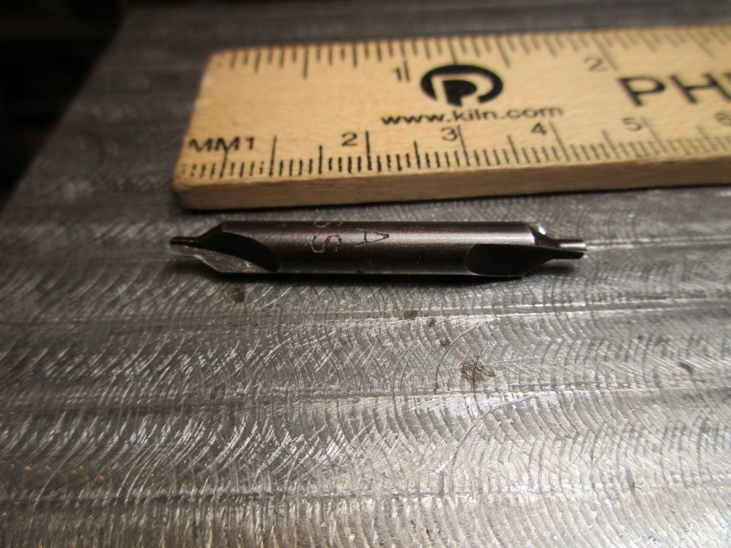

                                      Hi, there are many reasons for drills to have a tendency to run off and a few have been suggested, but if your drill is not quite sharpen concentrically, i.e. one of the cutting edges is slightly longer then the other and/or one of the edges has a different angle, then it will tend to crab and run off. small drills seem to be the worst for this as they bend easier.
                                      As far as using centre drills to spot, I've no problem with this and have been doing it for years where I wish the hole to be as true as I can get it. I've had this little chap for at least 15 years and have spotted countless number of holes and used it in the lathe for drilling centres.
                                      Only yesterday I spotted 20 holes before drilling each one with a No. 42 drill. If I break one end today, it's still earnt its keep.
                                      Regards Nick.
                                      P.S. I have two centre drills that are even smaller than this one and have spotted with them on a few occasions.
                                      Edited By Nicholas Farr on 02/10/2019 08:29:25
