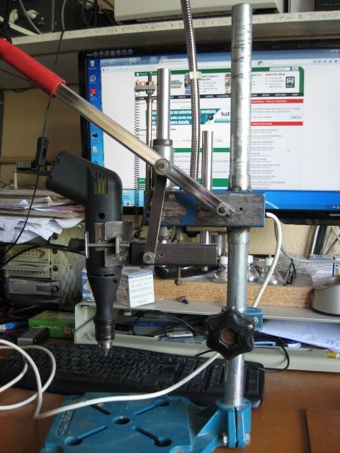

                                                    Les Jones 1
                                                      @lesjones1
                                                      Hi Bob,
                                                      This is a drilling set up I made for drilling printed circuit boards.
                                                      It is made from an old Black & Decker drill stand. The main slide part is from an old dot matrix printer. The rear guide bar to stop rotation is also a bar from a printer. This does not go through a bush. It is just located between two strips of brass that are adjusted so they just touch the sides of the bar. The counter balance spring was made as long as possible so the tension does not change much over the travel. I use this with a Minicraft drill but a Dremel could be used. The drill is just located in the "V" of a short piece of angle.
                                                      Les.
