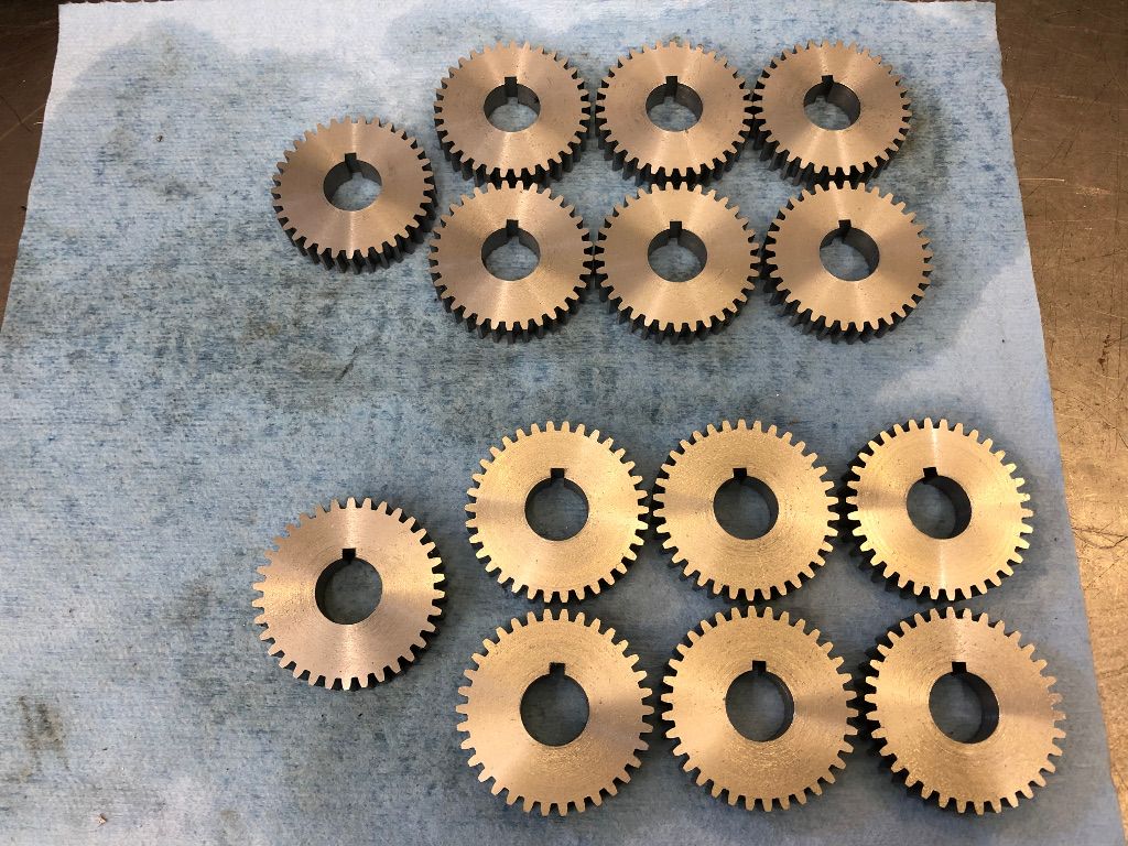

          As David rightly put it's difficult to get off-the-shelf gears at 14.5PA
          These have been out of stock at the usual outlets so I've made 7 pairs and been given leave to list them in the classified section this one time due to the lack of availability. They are steel gears with hobbed teeth and broached keyway.

              It wasn't my intention to get into wholesale, more to fill a need but if they continue to remain unavailable I may advertise some in the future. More than half of the above sets are already claimed.

                    I made 7 pairs since it was as easy to hob 7 as a single one once the machine's set up. They did go quickly so I've now removed the advert.
