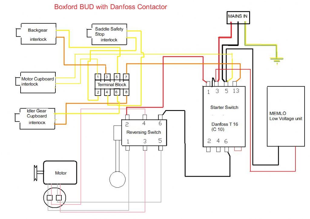

                                                  #183795
                                                  Brit-car -fan
                                                    @brit-car-fan
                                                    Hello Dave,
                                                    Very late for a reply I suppose, but I've only just seen your post.
                                                    When I rebuilt my Boxford BUD lathe (Danfoss T 16 / C 10 contactor) I mapped the electrics, so this may be of some help For URL on photobucket, or lathe 2 wiring.jpg
                                                    #183930
                                                    frank brown
                                                      @frankbrown22225
                                                      The basic unit is not a switch, its a 3 pole contactor. Its got a coil to actuate it (NOT the hashed button) or there would be nothing to hold it in. So turn the thing on its side and find two contacts sticking out of the coil, which also will have the operating voltage on it. If the operating voltage is 230V, then it can be wired from the mains live to one side of the coil via the normally closed "off" contacts. The other side of the coil goes to the incoming mains neutral. So now, pushing the green button should put mains on the coil which pulls in the armature and switches the mains through to the motor. Releasing the green button should allow the armature to drop out and the motor stops. Not quite what you want!, so anoth set of the main contacts is wired to the mains on the input side, and the output side is wired to the junction of the ON switch and the OFF switch.
                                                      Now when you press the N switch the contactor pulls in and routes mains to the coil so releasing the ON switch has no effect. Pressing the OFF switch breaks the supply to the coil, so the armature drops out and every thing stops.
                                                      If you have the thermal over loads then the switch/ contacts from them is simply in series with the coil, so its like another OFF switch .
                                                      Frank
