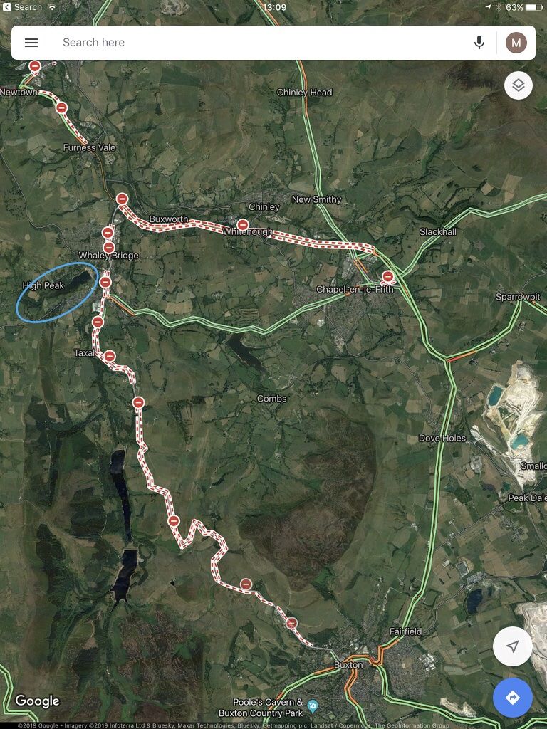

                                Here is one that I didn't post yesterday: **LINK**
                                Engineers battle through night to prevent catastrophic dam failure
                                [please note the publication date though]
                                I have just returned from a walk, and can confirm that even more roads in the area are closed, and there is a significant Police presence ensuring compliance !
                                Rain and thunderstorms are forecast for tomorrow.

                                                  Also… coming back from the supermarket earlier, a Chinook went over heading NW at about 4-500 feet.
                                                  Heading for Whaley?
                                                  Edited By Neil Wyatt on 03/08/2019 18:15:00

                                                      Posted by Neil Wyatt on 03/08/2019 18:14:46:
                                                      Heading for Whaley?
                                                      The one that's been working is, apparently, based at RAF Odiham : **LINK**
                                                      https://www.forces.net/news/raf-chinooks-called-help-stop-derbyshire-dam-collapse
                                                      … So, I don't know
                                                      I was told this morning that the 1-ton bags are being delivered to part of Long Hill [which should be recognisable on the map that I posted], and then the Chinook is shuttling them to the dam.
                                                      https://m.youtube.com/watch?v=r7LMuLmSun8
