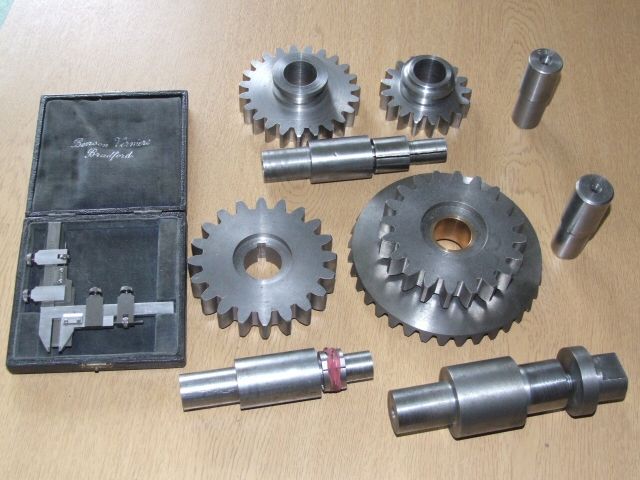

            Like Billy says the basics can be found in books. The book mentioned by Ivan Law is a good start, especially for spur gears.
            When gear cutting I normally make a simple arbor to mount the blank. For small gears, say less than 4" diameter, I normally use a screw in the end to expand the arbor and hold the gear. For larger gears I tend to make ends with 'proper' clamping arrangements. When setting the cutter I use a length of gauge plate to 'touch off' the side of the gear cutter against a convenient point, often the OD of the gear blank. Then I move the milling machine table by half the OD of the gear, plus half the width of cutter, plus the thickness of the gauge plate. The cutter should then be centred over the gear. I then 'touch off' the cutter on the top of the gear blank and move the knee of the mill an amount equal to the calculated depth of the 'tooth'. Then it's just a case of cut, index, and repeat as needed.
            I normally do a trial run, no cutting, to make sure I've got the indexing right. I cut full depth in one pass, although that may depend upon the rigidity of the setup. Here's a 12" OD 6DP gear being cut:
            I normally use tailstock support, as it increases rigidity. The green clamp is belt and braces to stop the gear slipping on the arbor. The cutting forces should be symmetric, but you never know………
            Gear cutting isn't difficult, and the maths is pretty simple, so I can't see you having any problems.

                Hello Andrew,
                Thank you for your excellent advice and the picture, which tells a thousand words. That is most definitely a gear you have got there my friend. The process you described is what I have had in my head so far, so it is nice to hear it vocalised. I am glad to hear that it is usual to cut the full depth in one pass. Obviously my machine does not have the rigidity or power of yours, and I reckon I'd get a poor finish if I did that in Delrin, but it is good to know.
                Your words of wisdom re set up, workholding and clamping are just what I'm looking for. It is all the little tricks that make the job so much easier. These are the types of things that in our society are being lost. And it is a tragedy because we are the Nation who industrialised the world; we make things, it is who we are. I am determined to hoover up all these skills. In fact I seem to be becoming something of a collector of them.
                I will keep you updated on my gear making attempts.

                  I would think that you'll have no problem cutting a Delrin gear for a M250 full depth in one go. I have a Harrison M300, and some of the intermediate gears are plastic, Tufnol I think, rather than Delrin.
                  Another useful book on gear design is 'Gear Design Simplified' by Jones and Ryffel, ISBN 0-8311-1159-3. This book deals with the design of gears, not manufacture. Here's a picture of more gears, and some arbors, which may give you some ideas:
                  After a lot of faffing about adjusting cut depths, I found that the gear verniers are a bit of a waste of time. Just cut to the calculated depth and the gears should mesh without a problem. The only caveat is make sure you know what depth the cutter is designed to use. For gears designed using diametric pitch the total depth is normally 2.157/P, where P is the diametric pitch. However, some gears, with low numbers of teeth or fine pitch, may use 2.25/P. The cutting depth is sometimes marked on the cutter.
                  Andrew

                    Hello Andrew,
                    Thank you for taking the time again to post on this subject and for the photograph, plenty of food for thought there!
                    I was in two minds about wether it would be advisable to take the full depth of the gear tooth in one bite out of the delrin, so thanks for the affirmation. I thought to use delrin as it would be less strain on the machine and less trouble if I make a mistake, which is quite likely! By the same token, using delrin means I will end up with a serviceable end product, once I get it right that is.
                    Some of the change wheels on my M250 are tufnol and I may opt for that, I will see. Thanks also for the book recommendation, I have several books on machine design and gearing but I'll certainly look it out. Fascinating reading your comments on depthing the teeth, I am looking forward to having a go.

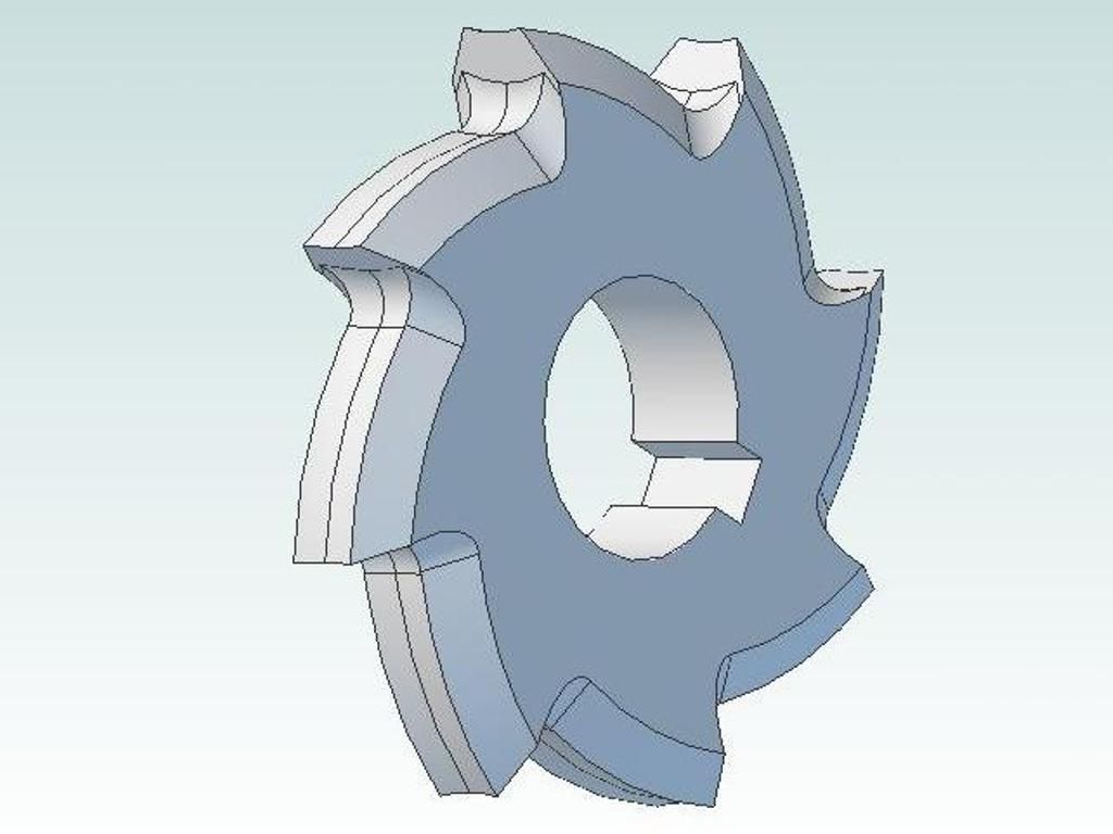

                                Carl: I was a bit boggled by your blog on swirl chambers. I used to work for a scientific consultancy that specialised in acoustics, vibration and CFD, so I've picked up a bit of knowledge, but not at your blog level. I'm not a member of the Yahoo Harrison group; probably because I would have needed to register with Yahoo.
                                I think that Harrison used Tufnol gears to minimise noise. It seems to work, the noise from my lathe is dominated by the headstock gears. I've not had any trouble with the Tufnol gears.
                                I'm not familiar with the M250, but on my M300 I can cut imperial and metric threads without removing and replacing gears. My lathe is imperial, so I assume that the metric pitches must be an approximation, as there is no 127 tooth gear in the train. I bought the additional gear needed to cut Module and DP 'threads' on Ebay.
                                I need to cut some internal and external splines for the crankshaft and gears on my traction engines. For the external splines I plan to use the dividing head and horizontal mill, in conjunction with a spline cutter that I have designed, and will make from gauge plate. This is the 3D model of the cutter, for scale the central hole is 1" diameter:
                                For the internal splines I plan to use the rotary table and slotting head on my vertical mill. I will make the cutter from 3/8" square HSS by milling and grinding to get the precise shape.
                                It's just a question of finding the time!

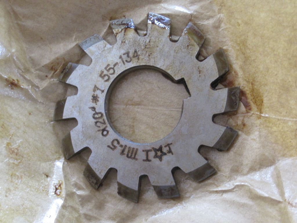

                                        Update:- Have purchased a set of Brown and Sharpe type mod 1.5 cutters and an arbour to mount them on from RDG. I'm starting to lean towards milling the slots for the splines with a slot drill.
                                        #126538
                                        Carl Wilson 4
                                          @carlwilson4
                                          Update:- I am back in the UK and my Brown and Sharpe type cutters have arrived:-
                                          As I write this the cutters are sitting in a bath of white spirit to remove the packing grease. My next task is going to be to make an arbour to mount these on. Then I can get on with cutting some gears.
                                          Carl.
