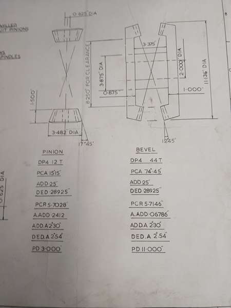

      I need to cut bevel and pinion gears for a traction engine that I am building .The bevels are 12 inches od with 44 teeth and the pinions are 12 teeth and 3.5 inches od .They are 4 DP ,I have the correct gear cutters and intend to cut them on a mill using the method laid out in Ivan Laws book on gear cutting , the material is cast iron . I have never cut bevel gears before but have cut plenty of spur gears  . i have cut all the dive gears the largest with 124 teeth at 6  DP on a casting that started at 170 kgs  Any advice about cutting bevel gears would be appreciated Thanks MIke

                          diff geardrawingThe  drawing of the diff gears \I need to make

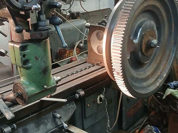

                            gear 1Cutting the main gear /diff centre , the 2 cut outs are for the pinions Its 21 inches od 124 teeth 6dp and weighs 140 kgs

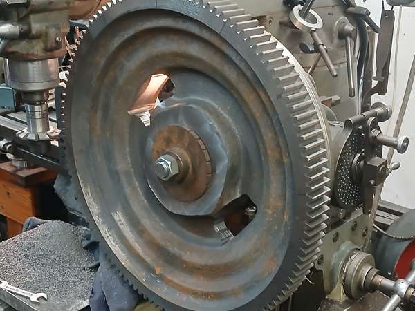

                              gear 2Set up for drilling the pinion shafts

                                Equipment is similar to what I have, except I don’t have the bigger lathe.
                                Some pretty impressive setups and machining and the two cutouts answer my question about the number of pinions.
                                The drawing indicates that the bevel gears have been designed using the DP at the outer edge, which is the normal method but assumes tapered teeth. Converting to the parallel depth method while retaining the correct spacing of the gears is non-trivial. I’ll have a closer look at the maths tomorrow.

                                    I’d select a DP at the inner edge (probably 5 or 6) and keep the number of pinion and gear teeth the same. Then one can use the spreadsheet to look at the values for the pitch circle diameters. Since the OP has clearly already machined the differential centre, and possibly other parts, it is important to keep the intersection of the pinion and gear PCDs the same. Finally the thickness of the gear blanks can be adjusted to give the correct distances, inside and outside, of the bevel gears so they fit with the other parts.

                                        After inwardly digesting the details kindly  sent to me by Les Riley I am going to give his method a go using no 5 dp cutters . I have some alloy  blanks for a trial run and will report on how it goes .Mike
