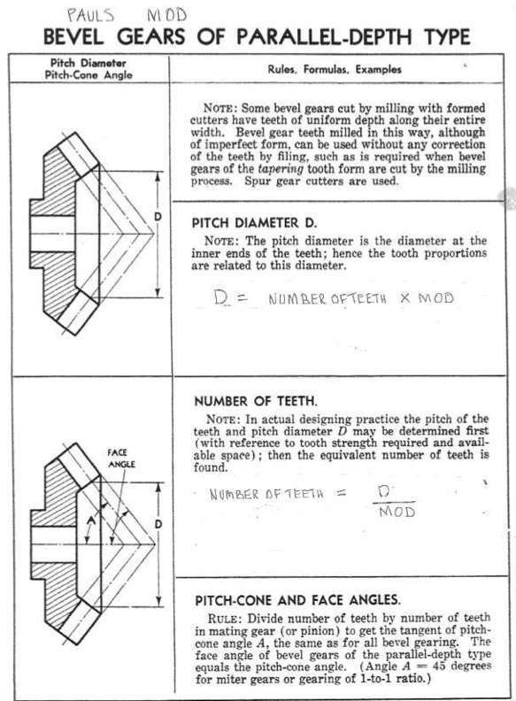

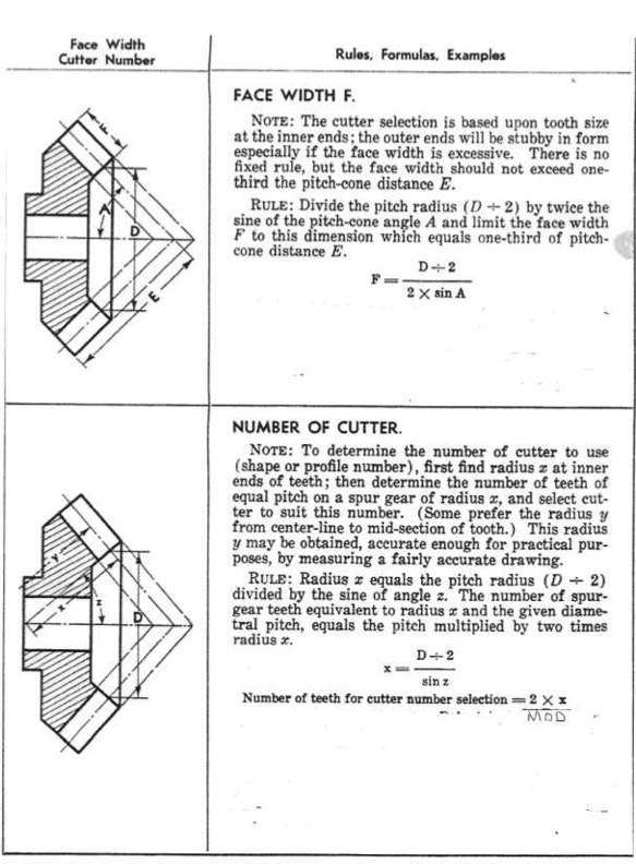

      However building a 4 truck Shay in 5 inch, and need to cut gears. Mod gear cutters are easy to get and steel is all in mm so have to use that system.
      Cutting 49 and 20 tooth gears as per ogiginal 1 to 1 scale loco, to get them onto 100mm dia wheels need to use 1.25 mod cutters, could not find any info on “mod parrallel depth info” but plenty on DP gearing, so plagerised DP info sheet to MOD, thought Id post it here in case anyone else was looking.
      I forgot where I downloaded it from so if anyone can tell me Ill credit the original producer.modamodbmodc

        It’s from ‘Gear Design Simplified’ by Franklin Jones & Henry Ryffel, published by Industrial Press of New York 1961.
        Still available – ISBN 978-0-8311-1159-5
        Incidentally they offer a smaller multiplier for calculating the dedendum (1.157) rather than 1.25 but I’m sure you knew this and deliberately opted for modification given the pinion size.

          On Diogenes Said:
          …smaller multiplier for calculating the dedendum (1.157) rather than 1.25
          That is the convention between DP and MOD gears. DP generally used 1.157, MOD used 1.25.

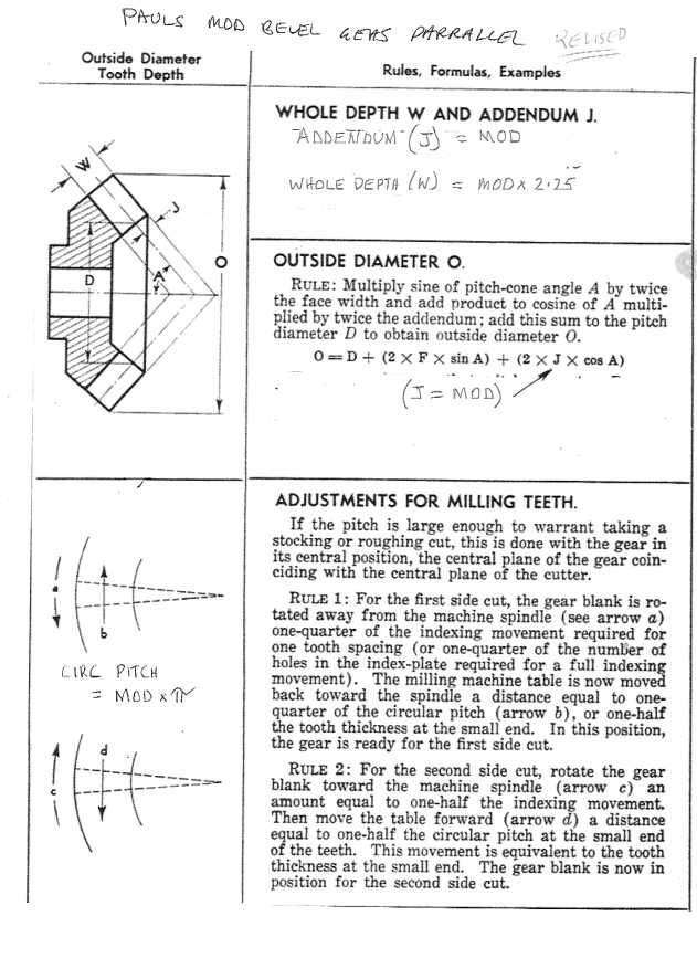

                          Have finally turned down a blank and ready to cut gears,,,BUT,,,,second thoughts on Addendum/Dedendum/Whole Depth.
                          WHOLE DEPTH equals Addendum plus Dedendum
                          Happy with Addendum equals MOD,,,and happy with Whole Depth equals 2.25 times MOD
                          but not happy with Ded=1.25 mod. Thinking back to High School maths,,,,,MODx2.25 does not equal Mod+MODx1.25
                          Should I have said in first post:
                          Whole Depth equals MOD times 2.25,,,,ADDENDUM equals MOD,,,,DEDENDUM equals WHOLE DEPTH minus MOD????
                          #702467
                          conrod
                            @conrod
                            Or did I get my maths wrong ans Dedendum equals Mod times 1.25????

                            DC31k
                              @dc31k
                              On conrod Said:
                              Thinking back to High School maths, MODx2.25 does not equal Mod+MODx1.25
                              The dish was well-cooked on the initial pass through the brain. Further marination in the grey soup has not improved the flavour.
                              1 orange added to 1.25 oranges gives me 2.25 oranges.
                              Pick a number for MOD (e.g. 10). 10 plus 12.5 equals 22.5

                                        Sorry DC3 I have been thinking again,,,to design the gear I dont need the Dedendum. Just Addendum and Whole Depth. Using the Dedendum is just “chain dimensioning” and my High School Tech Drawing teacher Mr Smith would be horrified! he said “there is a special place in Hell for people who chain dimension, its across the hall from where they put people who confuse Helix’s and Spirals”.
                                        So here is the REVISED PAULS WHOLE DEPTH AND ADDENDUMmodanoded

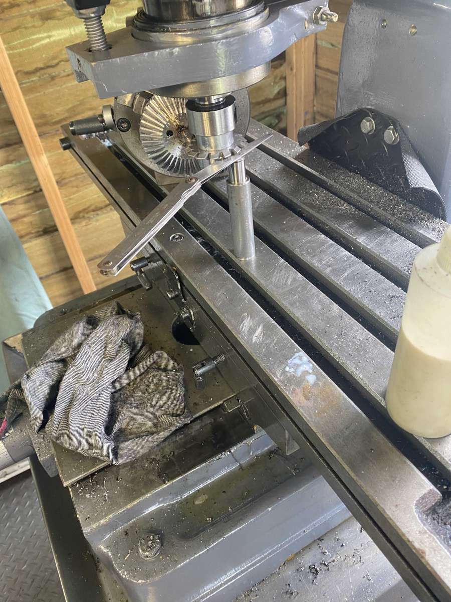

                                          Cut a gear today for third time, had trouble with the lowering and raising of cutter from centre line just couldn’t get it right.
                                          After sleeping on it I hit on the idea of making a “spacer” from round stock. Centre height is 100mm (sorry have to use that stuff, all Aussie is mm unfortunately) The thickness of cutter is 4.4mm and the required offset is 1.17mm up and down from centre.
                                          So at the lowest position the spacer is 96.63mm long (underside of cutter is 100 centre minus 2.2mm (half the cutter) minus 1.17 offset)
                                          At centre height I use the spacer plus 1.17 feelers
                                          At higest position it the spacer plus2.34 feelers,,,,strangely enough it worked,gear

                                            On conrod Said:
                                            Cut a gear today… …it worked.
                                            Well done. I like the spacer idea.
                                            It struck me that there might be opportunity to use the quill depth stop in a similar way. Set the stop for the lowest position and then insert spacers between the stop nut and whatever it touches for the other two positions.
                                            Being mean, it would save me nearly 100mm of material. It also means you do not have to move the table around to find a place for the spacer to rest on.
