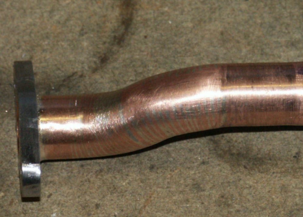

        Hi, I need to put some bends in copper tube for the exhaust pipe from the cylinder to the chimney on my Traction engine. And I don't want it to collapse. I was wondering if lead is melted and poured down the tube, this will work the same as cerrobend (woods metal). I know I can buy Cerrobend on line, but living in Jersey the postage gets a bit silly. And I have plenty of lead in stock.

          What diameter and wall thickness tube are you using and do you already have a tube bending device ?

            Go for, it anneal the the copper at the point where u want the bend Works every time for me
            #478529
              Popular method on the Fowlers that have a close tight dog leg bend in the pipe is to make a series of saw cuts almost all the way through then as the pipe is bent the saw kerfs close up and the gaps are filled by silver soldering.

                    I had a mate who used to pack the tube with sand. It worked ok. Never heard of doing it with lead, but I can see your theory behind it. Anything to stop the tube kinking
                    Out of interest as already asked, what diameter tube & wall thickness. Also what angles. Are they as tight as Jason's photo.

                      Hopper
                        @hopper
                        Yes lead is a traditional filler for pipe bending so should work for you. Be careful on removal that you melt the lead out from one end and work along. Just throwing the pipe in the fire can lead to the centre section melting first and firing the unmelted plug from the end across the shop floor.

                          The size of the copper tube is 3/8 x 21 g and the bends are like the one in JasonBs picture. I now know I can use lead thanks to Hopper. Cheers

                              Cerrobend is better as it is harder than lead and melts in boiling water. Find it on various web sites.
