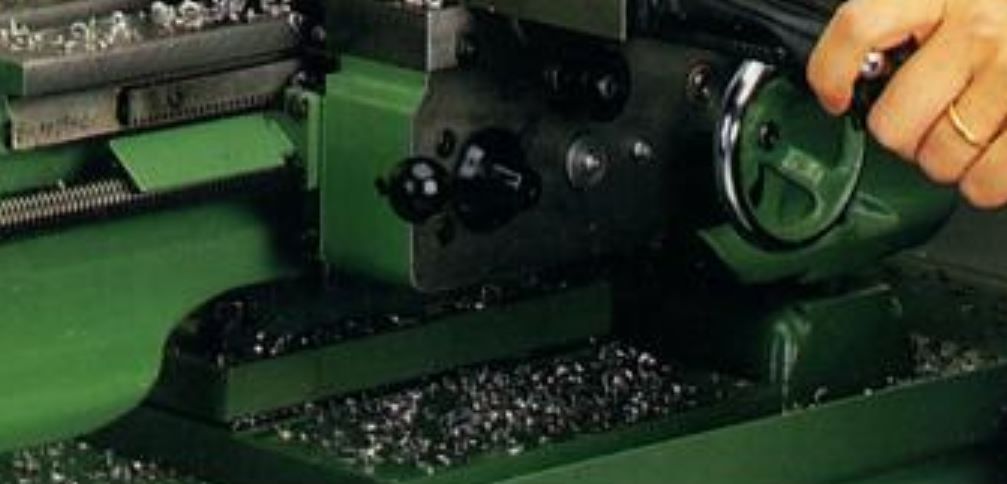

        Hi all, wonderd if any body has any idea how to connect (via bracket) Myford VM-A milling/drilling attachment to Myford Super 7 lathe. The mill came with a cast iron support but doesn’t match any of the pre drilled holes on the lathe. Is there a convertion plate or bracket that is available would be grateful for any advice. Lathe is on a Myford cabinet raised on bed raisers.
        First time I’ve used the site I’m a new member so be gentle with me.

              OP appears to already have the lathe on raising blocks since he says "Lathe is on a Myford cabinet raised on bed raisers.". These are necessary to ensure bottom of mill column clears the tray.
              The existing holes on the rear of the bed are for the taper turning attachment, having determined where along the bed the column needs to be so as to end up wih the mill column midway between chuck and tailstock, make a drilling jig plate whch incorporates the horizontal pitch of the existing holes and align the four holes of the mill bracket as required using thread taping size drill.
              Bolt dril plate to bed and pilot the four holes, tap as required.
              Just a suggestion.

                            If you look closely at the Lathes.co.uk photo where the girl is boring a casting you can see one or maybe two large rectangular items under the bed, maybe a plate and angle bracket that fitted to the stand as well as the rear of the bed which would have firmed things up a lot, you would need it raised up to get these in
                            Edited By JasonB on 10/01/2019 18:52:53

                                              Chris just added 3 pics one showing 1/4 tapped bsf holes in rear of lathe bed which were existing. The second showing 1/2” thick plate drilled and counter sunk to take 1/4 screws and 4 tapped holes to match colum bracket. Third pic. shows colum bracket in place supported on 3” dia. Jack I made to adjust final position.
                                              I will add further pics later to show how I finished the final fixings.
