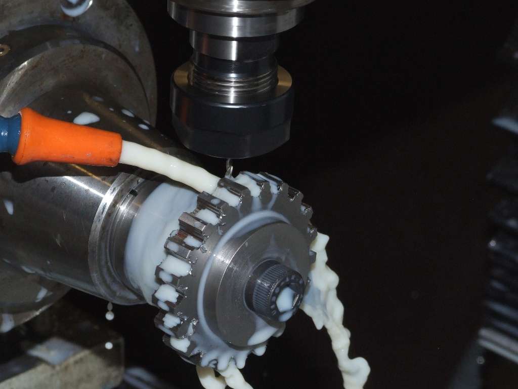

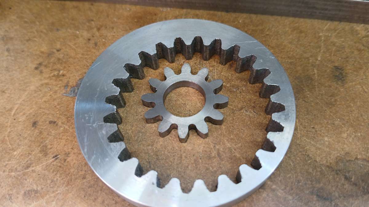

      With HPC no longer carrying MOD1.75 gears as stock items and not having much luck finding them as off the shelf items my thoughts turned to other methods of cutting.
      A bit of CAD revealed that I could just get a 2mm dia cutter into the root of the cuts so I did a quick test which turned out well. I started with a 3mm cutter doing an adaptive path to remove most of the waste. Then a 2mm cutter again doing an adaptive to get in where the 3mm would not fit and finally a few time saround the contour with the 2mm cutter to finish the profile.Just waiting on a 9mm long flute length 2mm dia cutter to arrive so I can make one to the required thickness.
      Feed rate and depth of cut were kept quite small as there is quite a lot of cutter engagement on what will be an extended length cutter, no signs of chatter on the 6mm flute length one I used for the test
      20250916_144224
      20250916_150025

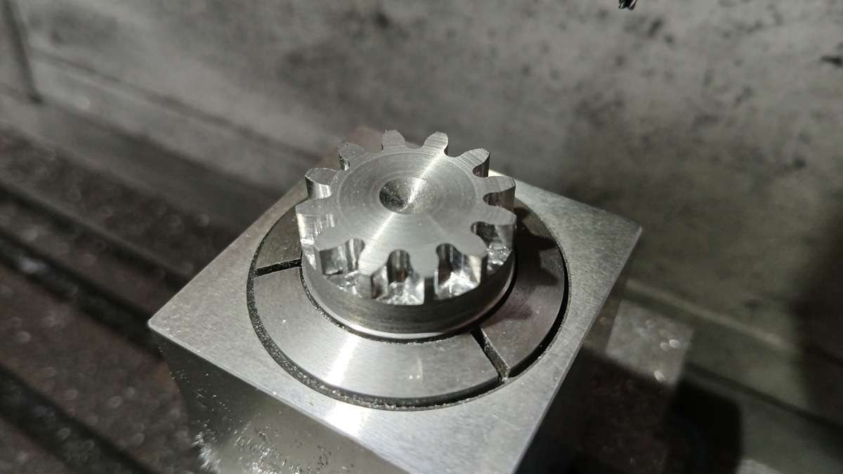

        #816460
          I think quite a few of JS’s gears were done with the 4th axis but he may well have also done the basic spur gears flat. I know he used Gearotec which would spit out the profiles.
          I did think about doing it with the gear horizontal and just indexing it around 12 times (no 4th axis) but settled on this method as I could walk away and leave the machine to it once the 2mm tool was fitted.

            It’s a good method provided the cutters will fit the teeth roots.  I’ve used it to make pinions and wheels for a clock train with a minimum module of just over 1mm – even then I found that I had to use a cycloidal profile though I’d have preferred to used involute, just to allow a 1mm end mill.  Profile generated as a dxf using an online tool and imported into CamBam.
            Do you form the teeth on the end of a bar and part the gear off Jason?

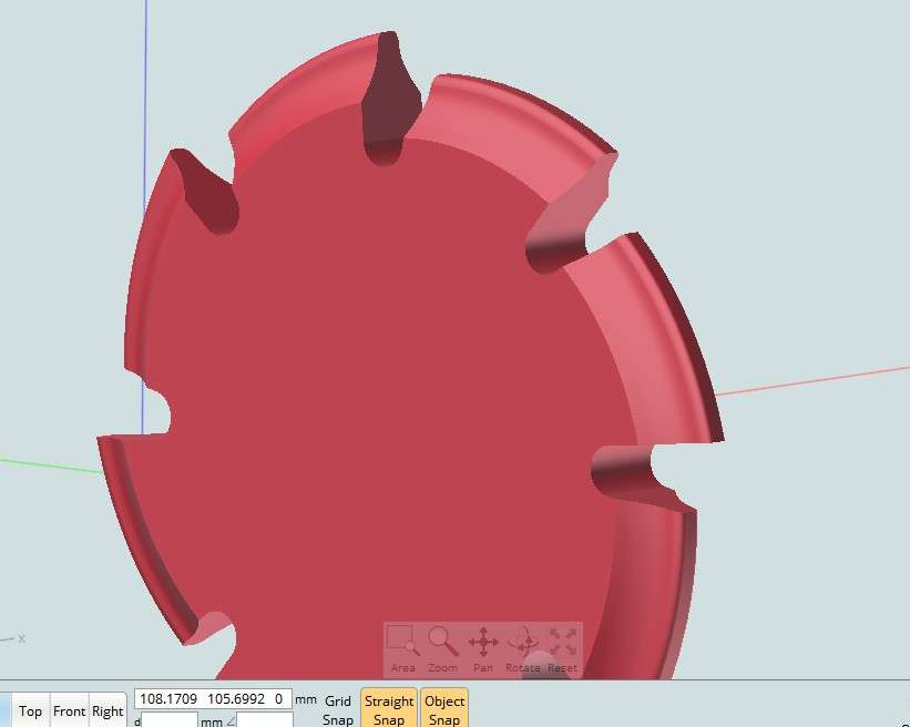

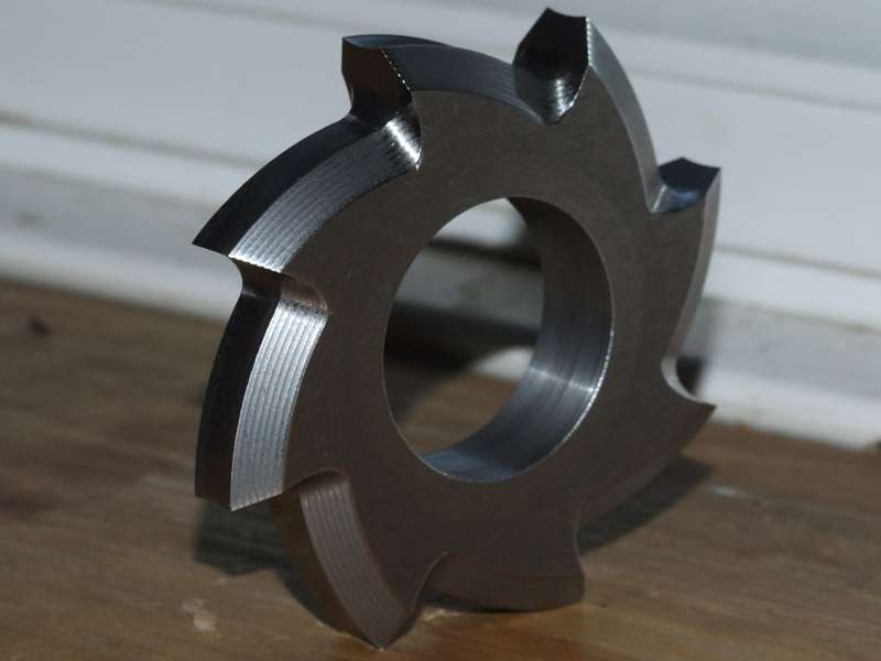

              I modelled a gear cutter for a friend, who had broken the back gear on his Myford lathe.
              I took the gear tooth profile generated from Gearotic into MoI, where I made it into a solid model. From there, a dense STL mesh was created and exported into DeskProto for g-code generation.
              After machining, a light lick on the front of each tooth to sharpen them up was all it needed to let him cut a new gear in steel, rather than cast iron like the the original.

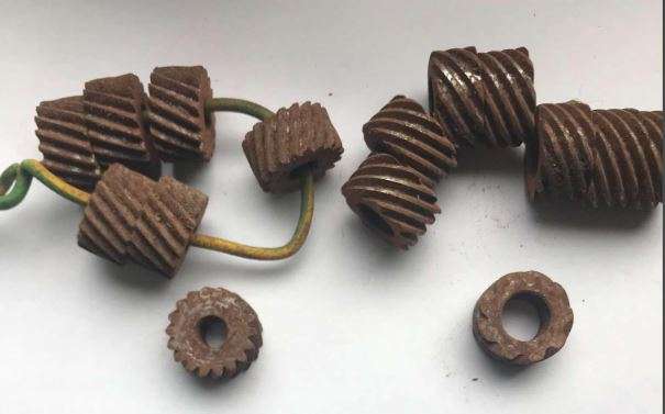

                I think Julie has shown cutters made like that on the CNC in the past complete with relief. Allows you to get into smaller valleys and do wider gears as well as custom shapes like splines.
                I’ve a need for a pair of equal diameter 2:1 skew timing gears and need to have a play to see if they can be done without a 4th axis just by treating the top surface as a 3D surface when the gear blank is held horizontally in a rotary table and then just index round and repeat the cuts. Though hoping a set of these rusty ones may find their way to me first
                  Good memory, I did make a cutter on the CNC mill for cutting splines on a crankshaft:
                  2013_08260080

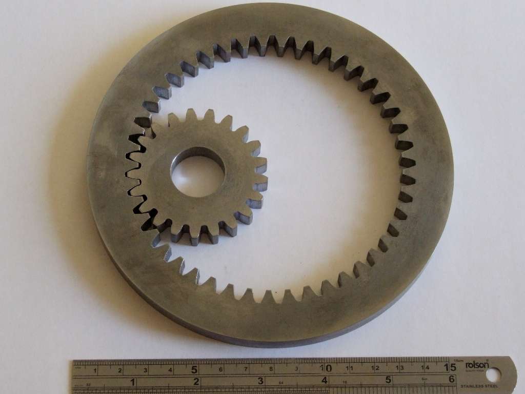

                  I’ve only made one spur gear on the CNC mill, using a 4th axis, as part of an internal gear set:
                  Internal Gear and Pinion
                  Cutting the pinion:
                  Pinion 21 teeth 20PA

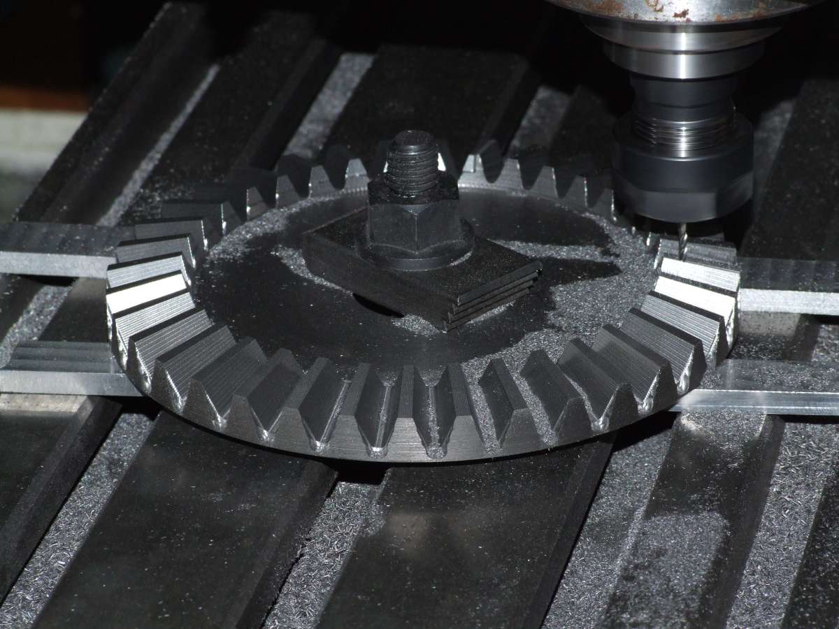

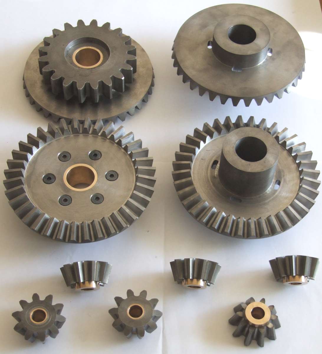

                  The first gears I made on the CNC mill were 6DP bevel gears:
                  Bevel Gears

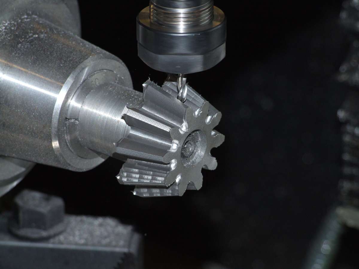

                  The bevel pinions were machined using the 4th axis and a 4mm ballnose cutter:
                  2011_08160010
                  The bevel gears were machined using radial toolpaths on the flat using 4mm, 3mm and finally 2mm ballnose cutters:
                  2011_09120011
                  I’ve made helical gears the traditional way on my manual mills, but if making more I’d use the CNC mill. I would use the 4th axis and hand write the code as my CAM program seems to have trouble following a helical path.

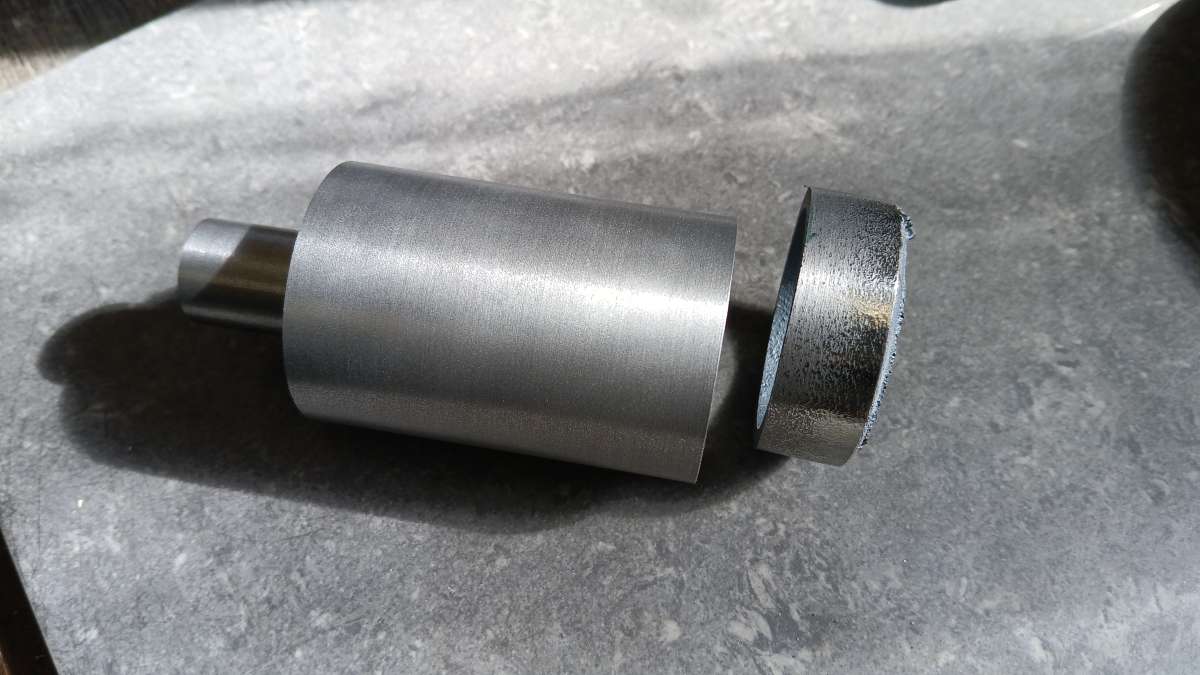

                          Well my cutters from APT turned up so I know what I’ll be getting upto this weekend, stay tuned.
                          I also found a good cure for the hard areas in some of the castings😉😉😉

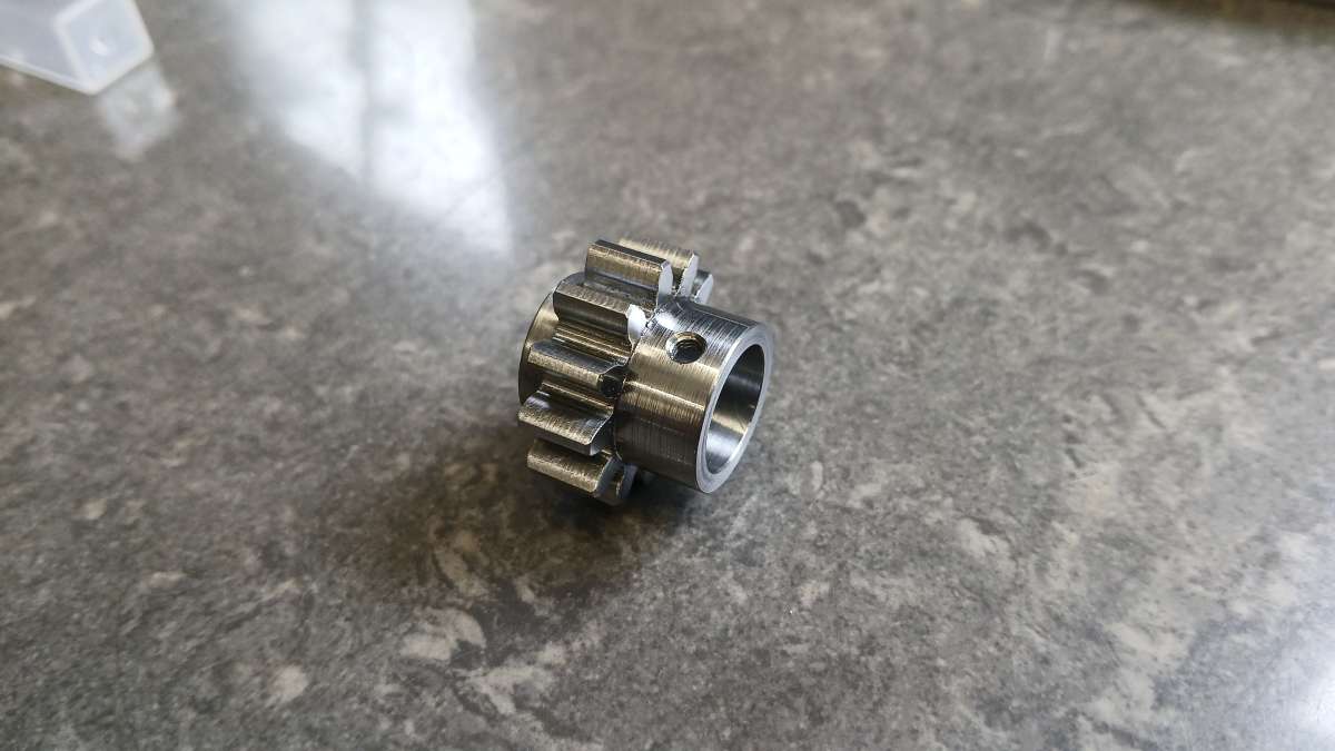

                            Having part machined the gear blank yesterday, I set the CNC running this morning while I got on with other things, just popping in to change tools and record a bit of Video.
                            I’m happy with how it turned out and will be using the method again.
                            20250920_141204
                            As I said earlier feeds were quite slow and small depths of cuts both vertically and sideways due to the cutter just fitting into the root of the teeth which meant a lot of cutter engagement. You can see this towards the end of the video where the contour cuts are being made, as the cutter gets to the bottom of the root there is an increased amount of swarf but no sign or sound of chatter which you can get if pushing it a bit harder. And no broken cutters.

                                Looking good; the finish in the video is a lot better than apparent in the picture. So must be a trick of the light in the picture.
                                Julie
                                #816886
                                  I think it was the sun coming in through the workshop window that was on the far side and making it hard to get a clear image.

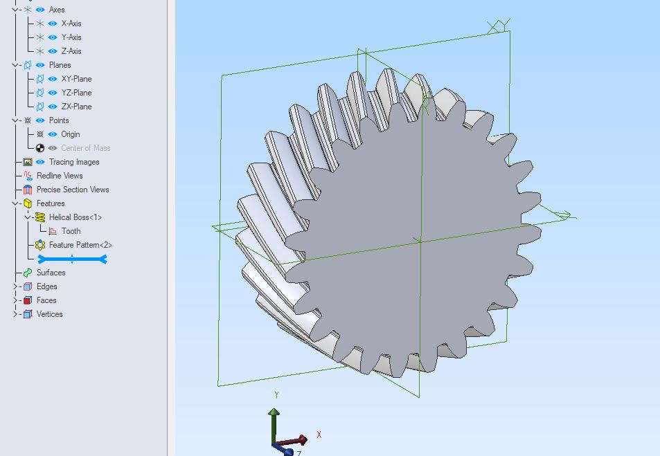

                                            Thanks David, I’ve found it.
                                            helical
                                            #816931
                                              One problem. It will only do helical gears upto 45deg helix. No good for the matching gear to the one above which needs an angle of 63.4deg to give gears with matching pcd but 2:1 gear count.
