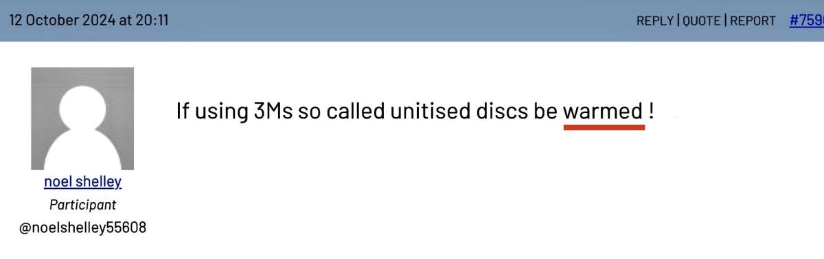

          noel shelley
            @noelshelley55608
            If using 3Ms so called unitised discs be warmed ! They may look harmless but will remove considerable metal if not used carefully. I used to use them to take brass casting from as cast to the first stage of polishing . Noel.
