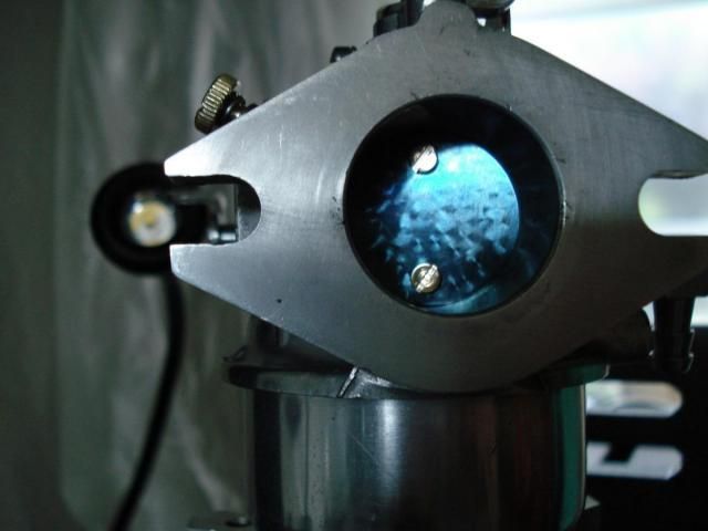

                            Richard S2
                              @richards2
                              Looking at your Album Pics, it appears you're using Steel?. If so, then I presume you're planning to Blue using Heat?.
                              The parts I have done like this required very little effort and very few obnoxious fluids etc. I just clean them up with some new Wet or Dry Carbon Paper, then proceed to to treat with heat . I fix by quenching in Oil. I used this on some Throttle Plates I made-
                              Still clean after a few years, but for Chess Pieces, you may benefit from lacquering after for more protection..
                              Edit- I do however have obnoxious chemicals, and have an unopened bottle (Safely Bunded) of Carbon Tet. Had to sign the Poisons Log at my local Chemists over 30 years ago. This is for my T.Engine when ready to prep for paint. Familiar with it's use from when I was a Printer/Photo Stencil producer.

                                          BW
                                            @bw
                                            Posted by Richard S2 on 15/12/2016 16:40:06:
                                            Edited By Richard S2 on 15/12/2016 16:46:37
                                            When I tried quenching in oil it masked the pretty colours and gave an overall much darker appearance with the blues and purples seen as subdued shadows underneath the outer darker layer.
