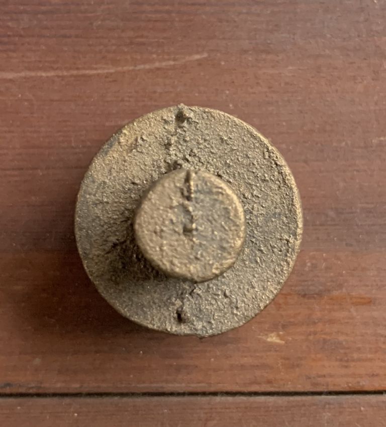

                Hi everyone,
                I found two of these casting for my Clayton. Does anyone know what they are for? Are these the pistons?

                  Those photos are not working for me, it says they may have been moved or deleted

                    noel shelley
                      @noelshelley55608
                      Could well be – with a chucking piece. Noel.

                      James Bailey
                        @jamesbailey59687
                        Coming into this late but they look like the piston castings. I bought the full set of castings, drawings and boiler kit from Blackgates last December. The standard and service was very good. I have completed the wagon and trailer chassis, and am now starting on the chassis spring brackets.
